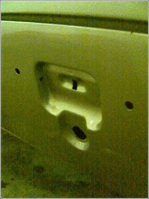

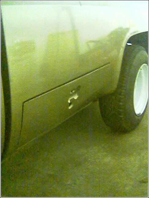

My truck is a 73' and I have a "tool box" on the side of the bed (drivers side) and it has no latch so I cant open it. Any info on these would be great.

They were optional and are exterior Tool/Space compartments.  It would take a different key than what came with the truck.  It should have a plastic box behind it.  If the latch is missing I don't know why you wouldn't be able to open it as the latch is what keeps it closed.

I would try using a long skinny screw driver and turn the inner latch mechanism if it is still there. like you would a trunk without the lock cylinder.

I dont know how it stays shut but there is no lock on it at all. You can look right inside the box throught the key hole area.
