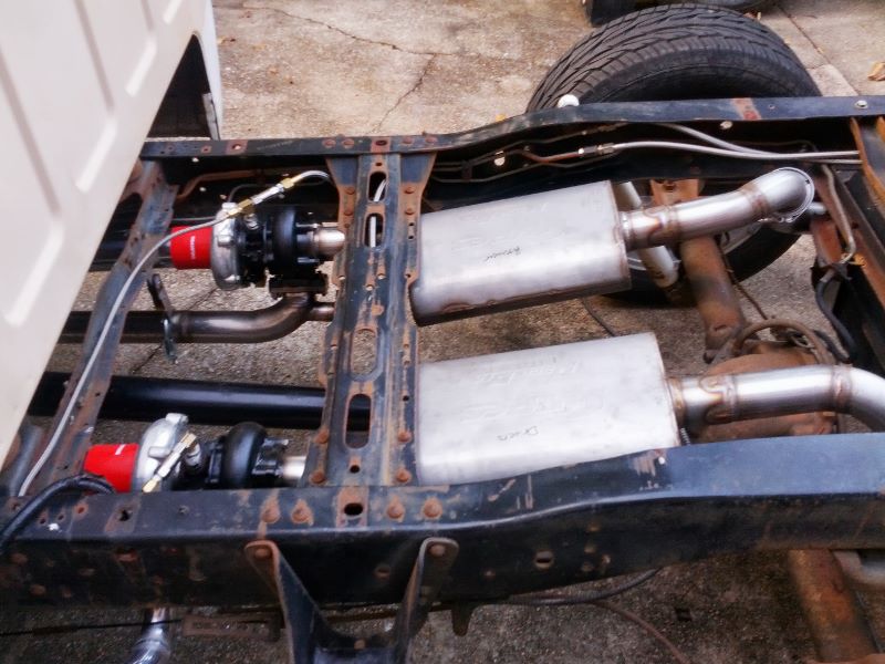

This is mine: http://forum.73-87chevytrucks.com/smforum/index.php?topic=12120
Plans are to get the new sending unit and 430lph pump in place and shoot for more power.  It is running out of fuel right now.  Swap in the new limited slip 3.42 rearend and finish up the interior.  Still driving it like it is though.

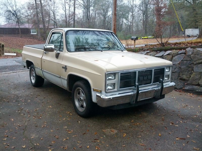

Those Impalla SS wheels look perfect on that truck. I have 2 Garrett turbos in my garage that have been collecting dust for several years, so I may have to copy your build one of these days lol

I am making 450hp/500lb/ft at the rear tire on a pump that didn't feed enough fuel and 8lbs of boost.   Since then I have swapped to a bigger pump (255lph to 430) limited slip, 3.42 gears and upgraded the turbos.
I was going to cap it at 550hp, but who knows now...  It will be enough to allow the motor to live as it is stock, until I get the other motor built to handle more.

I love this! What are the specs on the turbo's? Scavenge pump on each?

They are T3/T4 Hybrids were ball bearing now journal (don't ask) it was a .48AR with 54 trim, now it is a 60 trim, I believe.
I was so upset when the ball bearing setup bit the dust that I just took it to a buddy told him what I wanted and he built it for support to 490hp per
They were STS turbos but not it is just the turbine side...  It has 2 scavenge pumps on each of the framerails.
