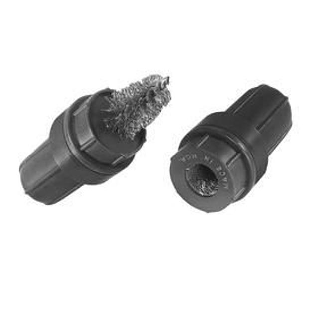

Thoroughly burnish and clean the battery cable connections!  Employ a specially configured battery terminal brush (image) to service conventional post-style connections.  Avoid applying acid neutralizers directly to or around the battery.  Acid neutralizers consist of chemically active bases that react with the acid to leave conductive salt residues nearly as damaging as the acidic battery electrolyte.  Instead, substitute clear water and a nylon bristle brush to wash away accumulated dirt and corrosive films.  Be sure that battery caps are fully installed before and while cleaning the battery!  Thoroughly rinse all surrounding painted surfaces until totally clean of chemical splash from the cleaning process.  Check for proper torque of cable attachments and remove any paint or corrosive salt encrustations.  Check for uneven solder accumulation on all of the battery cable terminal ends.  Scrape, sand, or buff away excess solder accumulation to ensure clean, uniform, flat, or otherwise conforming clamping surfaces.
