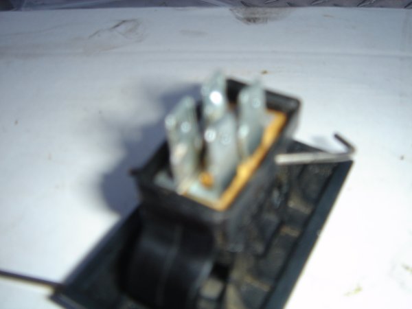

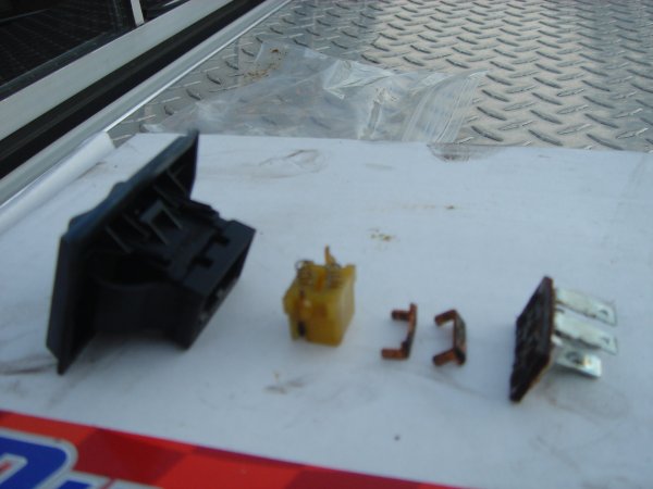

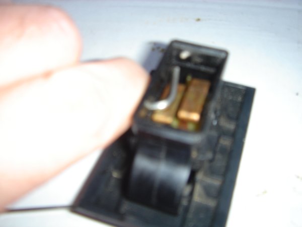

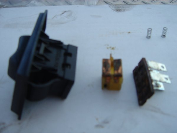

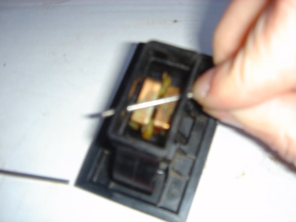

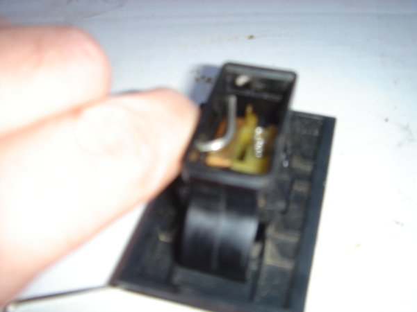

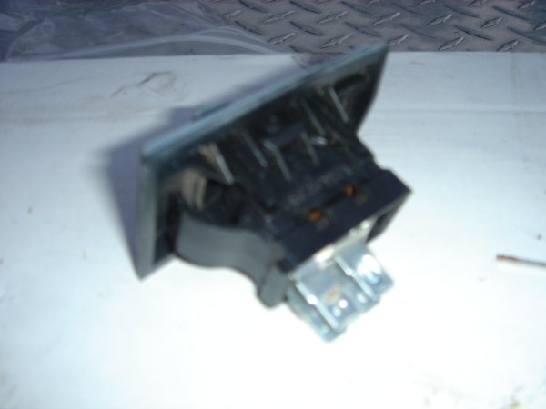

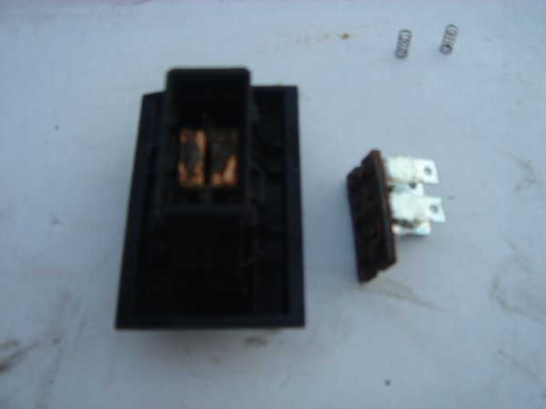

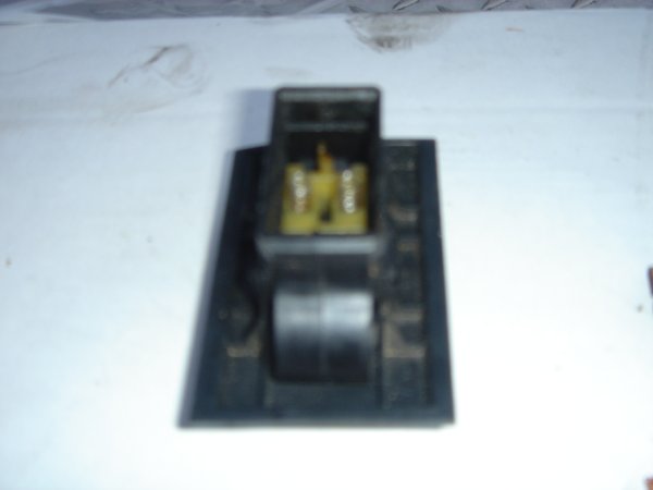

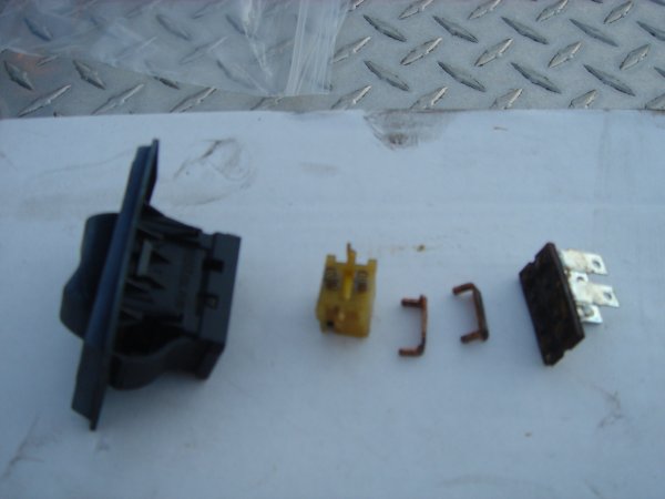

If you can bypass it, check around the swith.  If that works, pull the switch appart and clean up the connectors:
