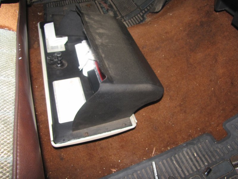

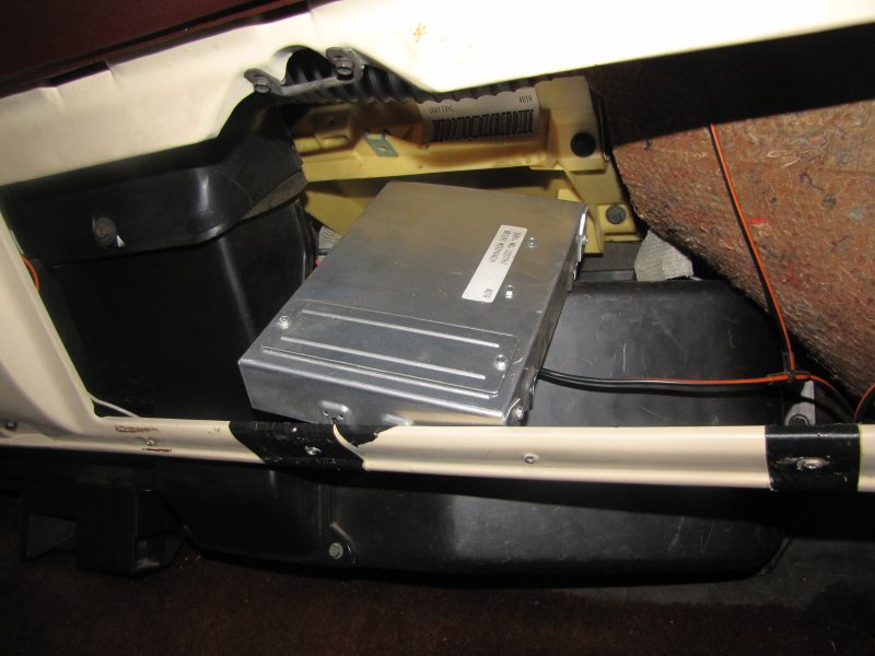

Sunday, Jan 8th, 2012:
Removed the Glovebox (9/32" socket)

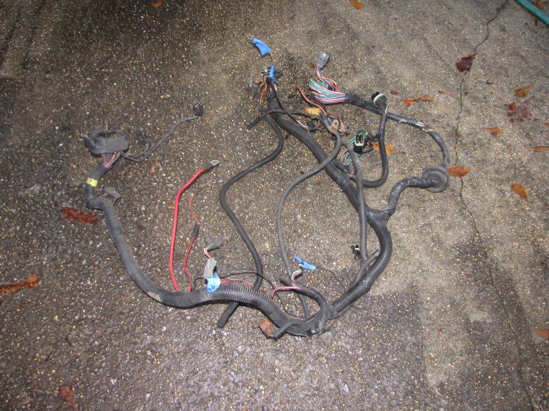

Disconnected the wiring from the ECM removed the bracket and removed it. (10mm socket)
Disconnect he TBI(engine) harness from the fuse panel bulkhead and removed it (3/8 deep well)

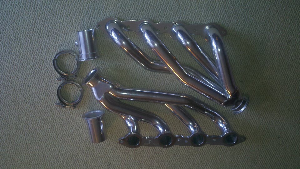

Monday, Jan 9th, 2012:
Ordered headers from
Street & Performance
(the only company that currently makes a header to clear the 4L80E. Asked them to add V-clamps to them. Expected delivery is 2 weeks.

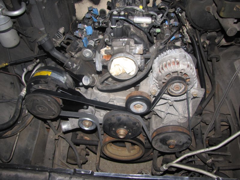

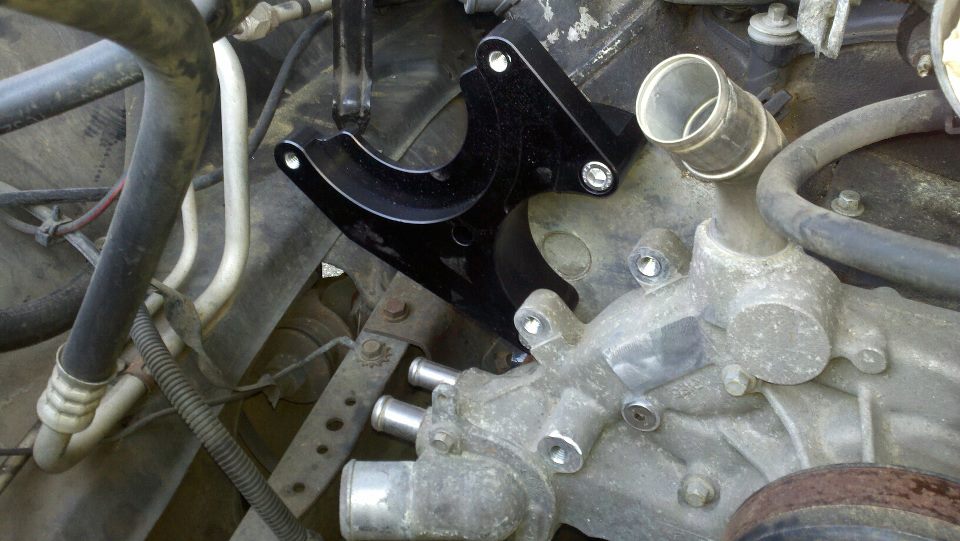

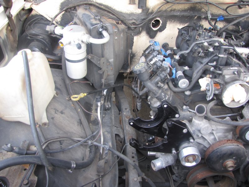

Sunday, Jan 15th, 2012:
Novak AC kit came in on Friday. Sunday evening, got started installing it. One hole on the waterpump has to be removed and countersunk to miss the new orientation of the idler arm. Also on some models the idler arm has to be clearanced of the ribs on the back to clear the new swing and a new billet pulley is installed
Installed the new rear bracket to the head (5/16" Allen). you can see the countersuck bolt here also, and I ground some of the casting numbers off the water pump.

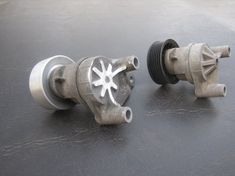

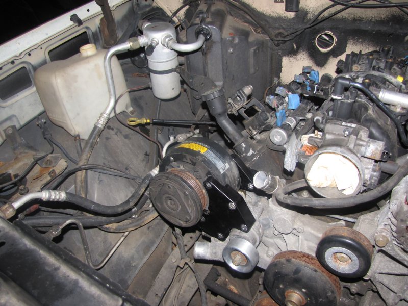

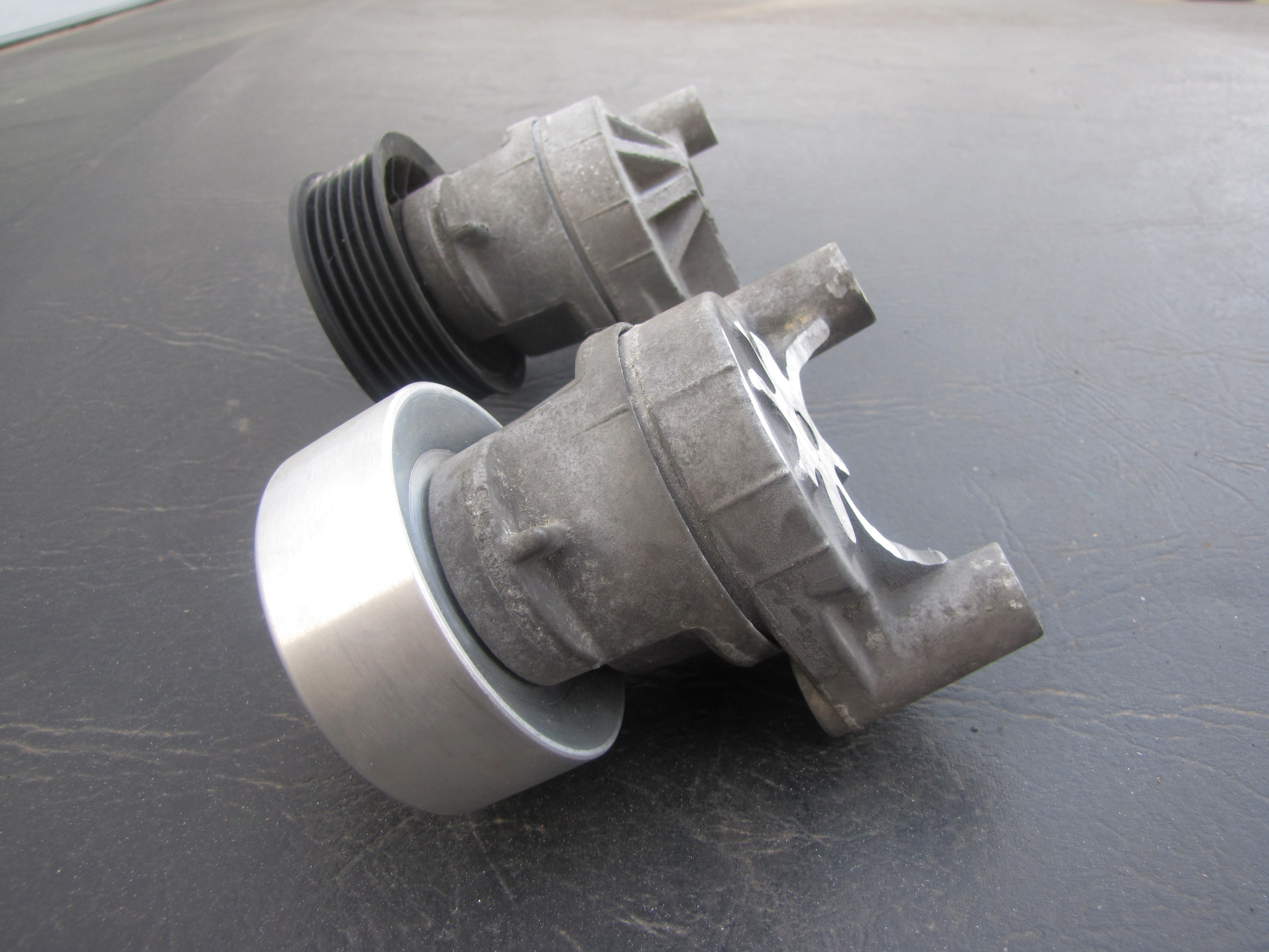

Monday, Jan 16th, 2012:

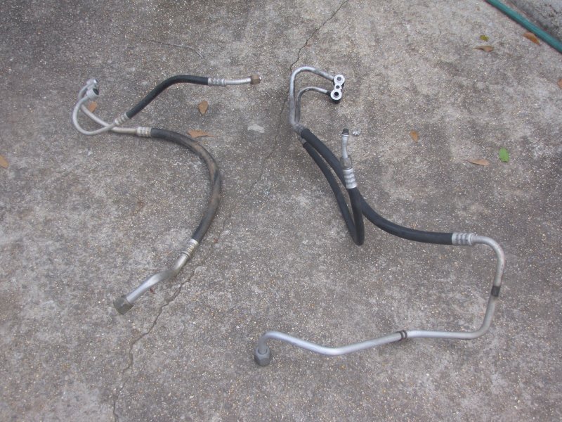

Removed the old 305 AC lines and "borrowed" the serpentine setup from the Blazer I am working on. Note the differences, Serpenting mounts on the passenger side just like the Novak setup. Blazer serp setup on Left,
V-belt setup on right.
Installed the idler pulley 180 degrees to it original orientation and loosely installed the front mount
Dropped in the AC compressor and tightened it up (15mm):
Novak includes the correctly sized belt for the kit and I put it on (15mm)

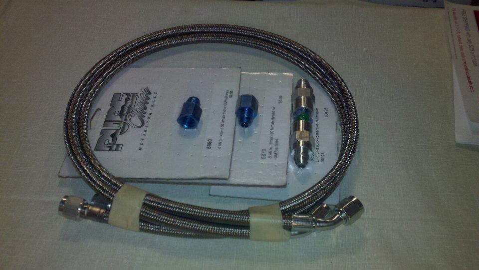

Wednesday, Jan 18th, 2012:
Fuel lines showed up this evening.

Thursday, Jan 26th 2012:
Headers from S&P showed up today.
