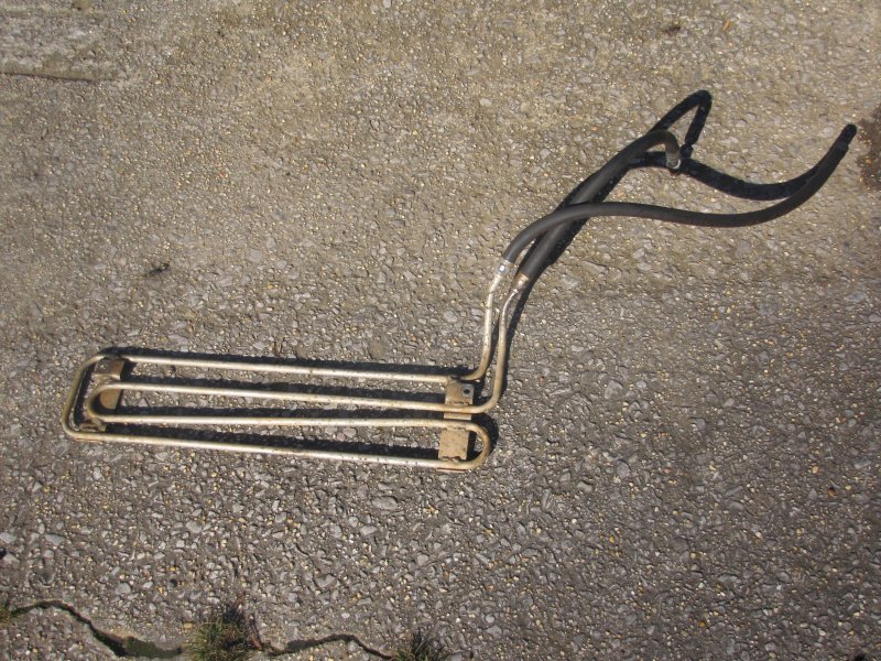

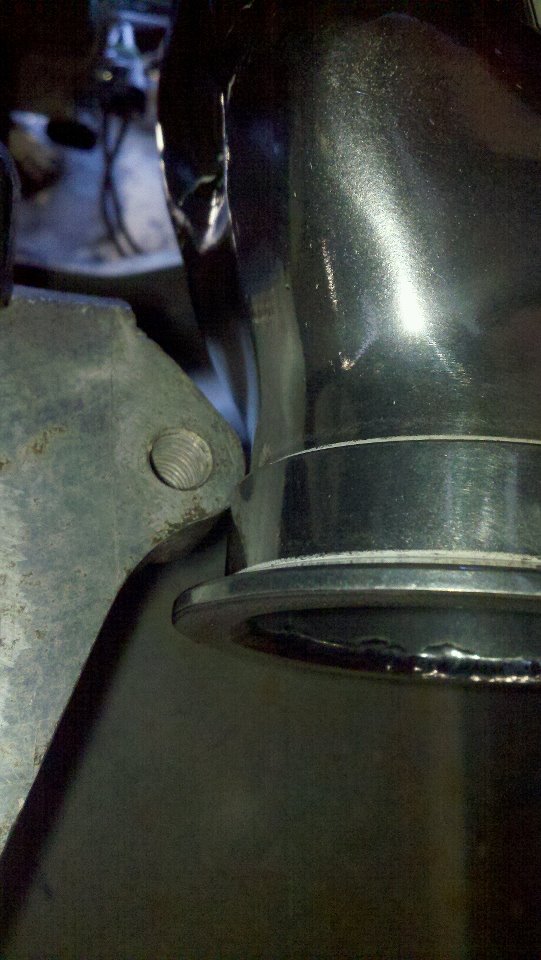

Saturday, January 28th, 2012: Attempted to install the headers and they ended up not fitting, passenger side wouldn't go between the frame rails, driver side hit the bell flange.
Pulled the Oil Cooler lines from motor (10mm)

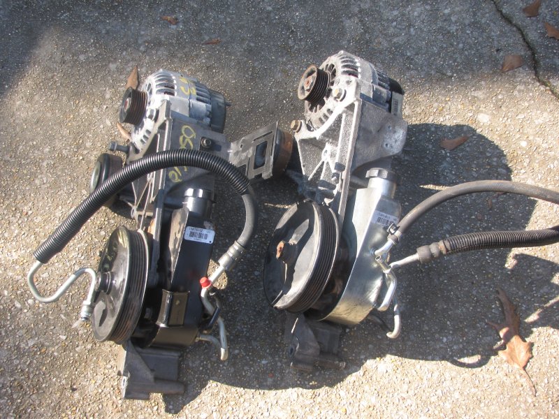

Removed the factory Power steering setup and lines and installed a factory 73-87 Power Steering Cooler on the truck (18mm, 13mm)
Since the engine I had came out of a truck with Hydroboost I swapped the Power Steering setup out for one without Hydroboost (15mm)
Got everything back installed and hooked up (18mm, 15mm)

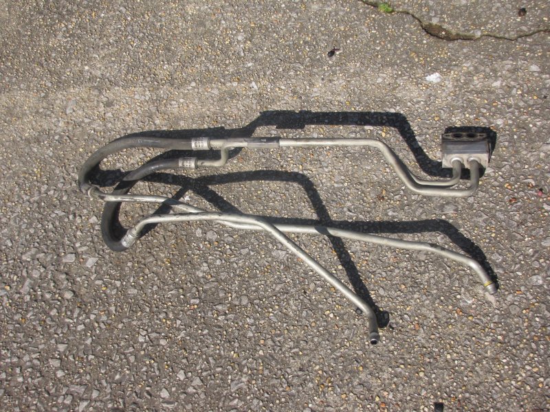

Connected the factory trans lines back up

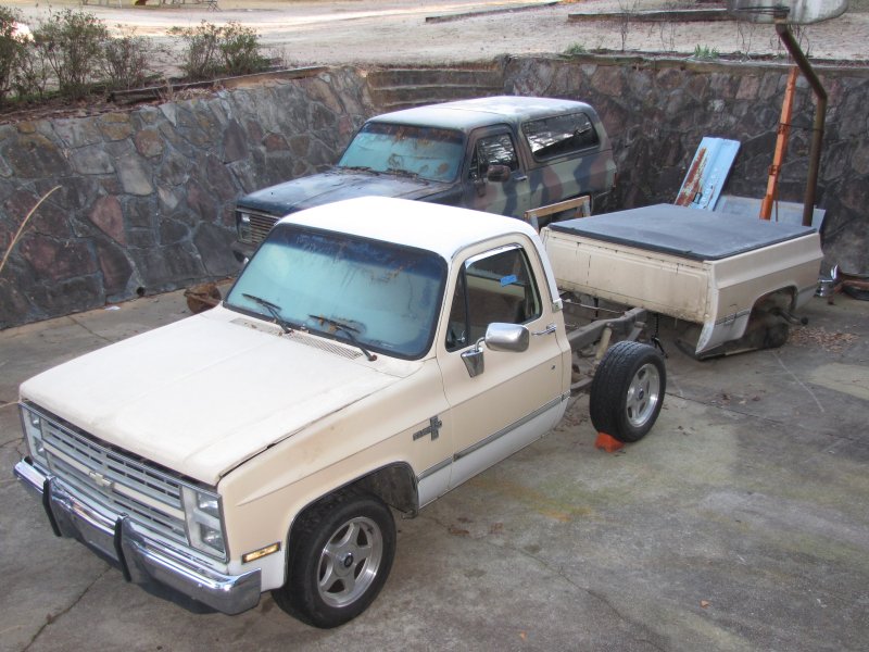

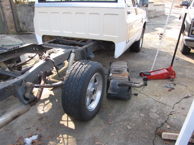

Sunday, January 29th, 2012: Got up removed the drivers side header, and bolted a set of 07 exhaust manifolds to verify they fit, just in case (13mm).  Then proceeded to drop the drivers side tank (9/16", 1/2" -frame to tank, flat and phillips screwdriver, 10mm fuel neck ground).  Once I got it on the ground and installed the fuel pump in the tank I decided to pull the rear bumper (3/4") and the bed off. (3/4", 1/2" -diff vent, torx and phillips on tail light lense).  Plan is to go ahead and drop both tanks and install the Blazer tank in its place.

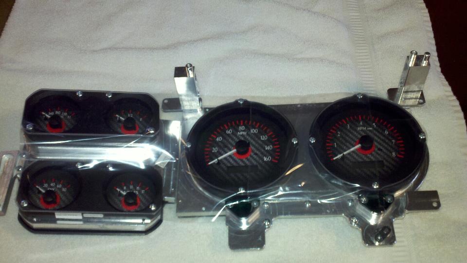

Friday, February 3rd, 2012: The Carbon and Red VHX Dakota Gauges arrived and I have to say I REALLY like these!

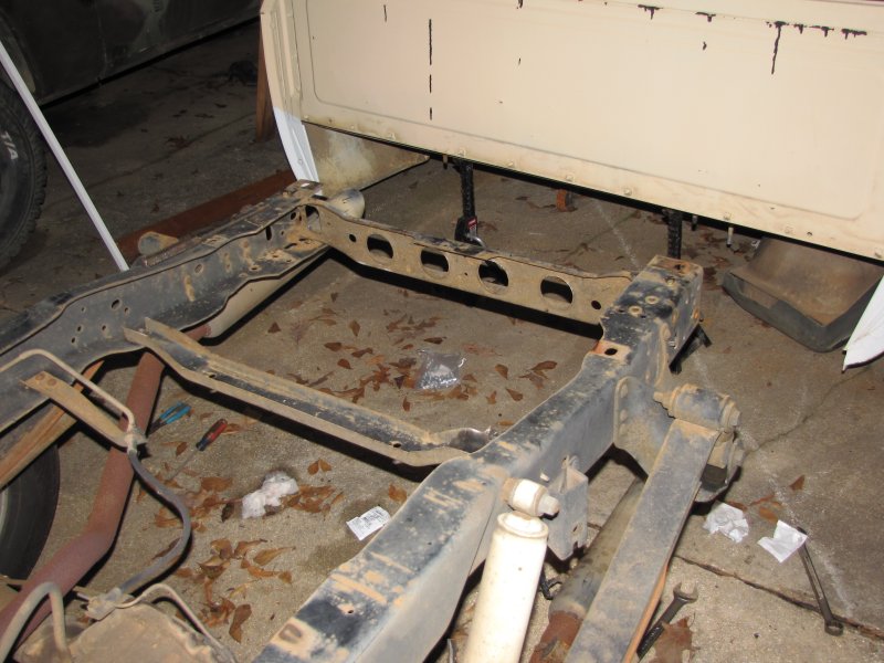

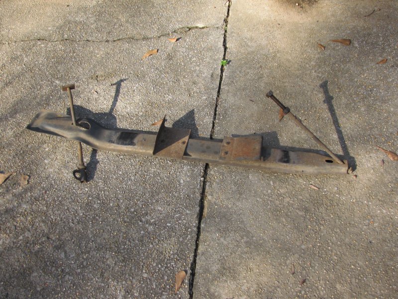

Sunday, February 5th, 2012: Dropped the passenger side tank. (9/16, 1/2 and flat screwdriver).  Removed the spare tire hanger from the truck (13/16", 7/8").  Pulled out the grinder with a cutoff wheel and removed the rivets holding rear crossmember in and made a hardware run to get bolts to hold it in is new location at the rear of the frame. (9/16").  Also removed the rivet on the drivers side for the tire holder brace, it will be relocated when the Blazer tank goes in.  Then ran out of daylight.

I skimmed the last picture and was like holy crap did he cut his frame in half?  ;D
I thought the same thing for a second!  :o

those gauges look awesome. if the headers wernt ceramic coated you could ratchet strap the flange towards the  frame rail  you want it to go and heat all 4 tubes evenly till they are red while ratcheting it more and it will pull the header away.
but they are ceramic coated..
those gauges are awesome, are those specific to our trucks or is it some sort of conversion?

The Dakota VHX gauges are specific to our trucks, they are in the catalog here:
