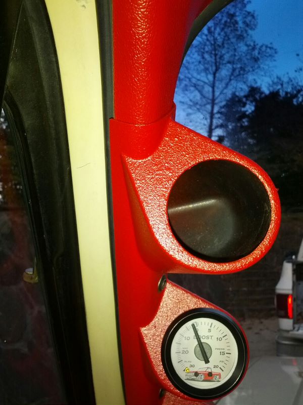

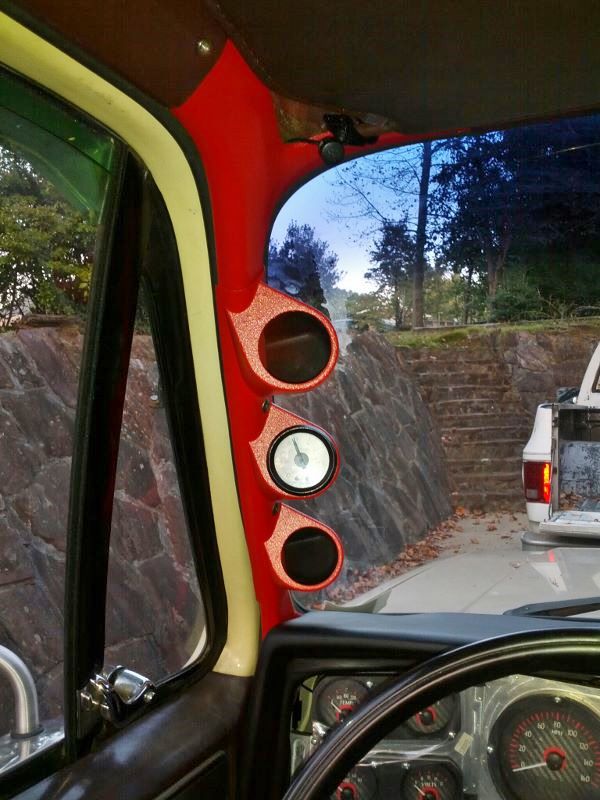

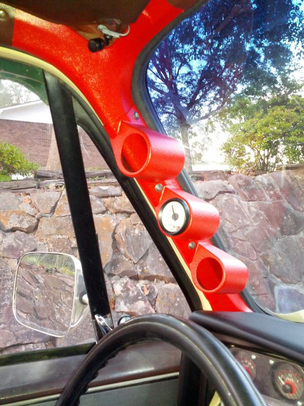

The factory texturing is applied in the mold from what I am told with a acid paper pattern, it removes the portion of plastic. I was told with the amount of flat surface on this it would "slide" and cause a sitely mess.
Yesterday with some Bed liner spray and some vinyl paint after some thorough cleaning with lacquer thinner, soap and water and some scuffing, This is what I have now. (truck interior color is changing to red)
Waiting on boxing cost and hardware (screws) cost and I should have the pricing soon. It should be within the $69-89 range of current 3 pod offerings.

WOW that's...
RED!!!
Cool!! Boss!! Rad!!
Those turned out really nice!
I like the logo on the boost gauge, too....

That is a pretty good texture match. There are additives you can add to paint to achieve that look, called polypropylene beads. They are commonly known as "sharks tooth" and look like fine white sand and added to floor coatings to give a non-slip surface. They have different micron sizes that you mix and match to achieve a random texture which is the easiest way to do it.
