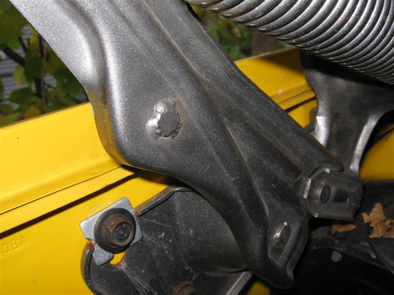

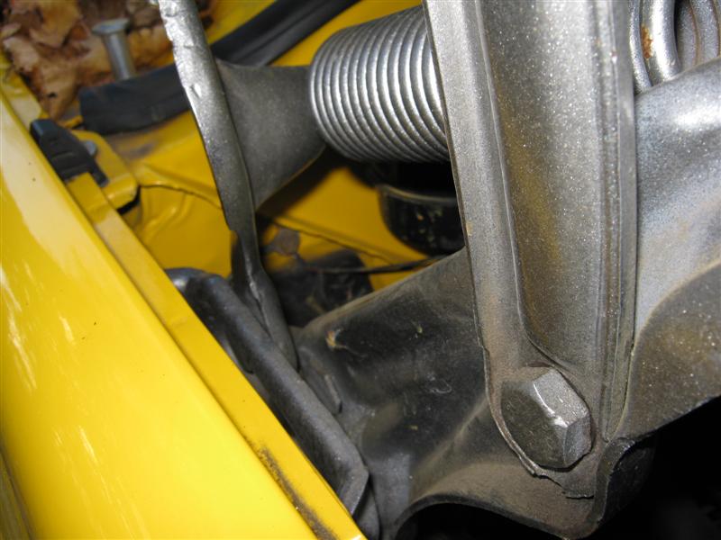

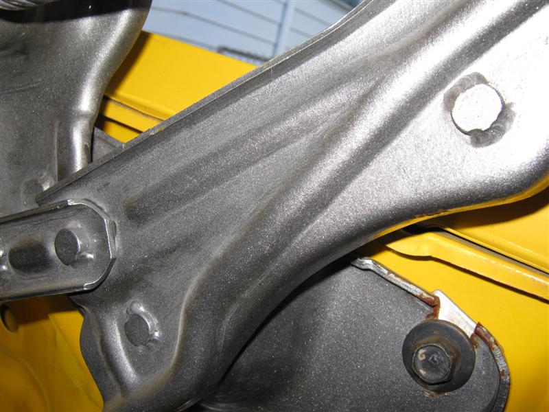

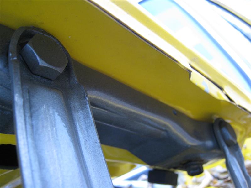

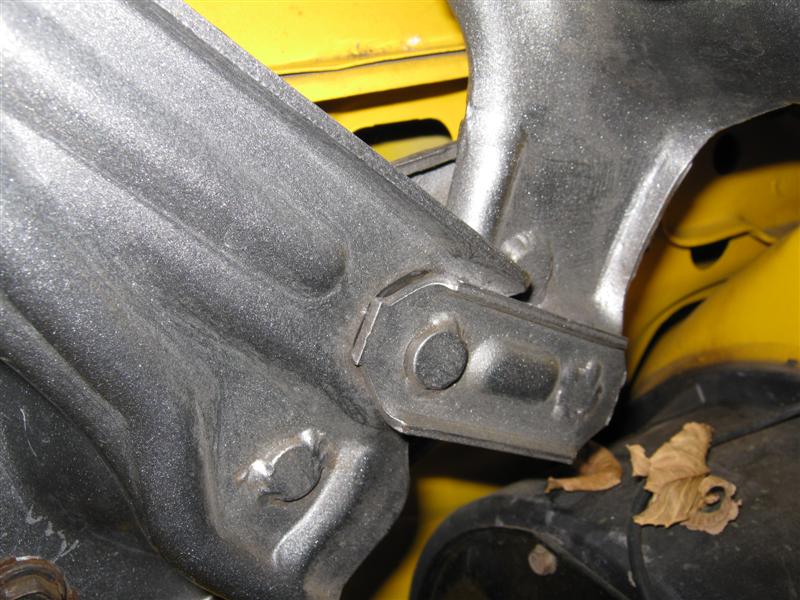

Just regular 1/2" bolts long enough to have a smooth shoulder on them.
Warning: It takes longer to do than you'd think. Anyway.....pics............
The bolts are welded from the other side.I used paper shims between for clearance which disappeared with the welding.
