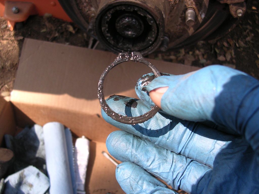

Remove the snap ring on the spindle.
Then go change your torn glove.
