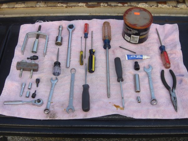

Tools needed are:
Phillips screwdriver #1
Phillips screwdriver #2
Phillips screwdriver #3
Small flat blade screwdriver
Ratchet
13/16 socket
Small brass hammer
Small picks
Needle nose pliers
Torx bit #20
Torx bit #30
Inverted Torx bit #E8
7mm socket
1/4 socket
Small chisel
Steering wheel puller
Lock plate remover/installer
Pivit pin remover
Locktite thread locker
Wheel bearing grease

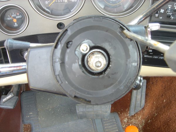

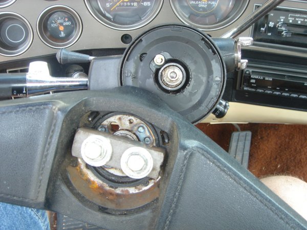

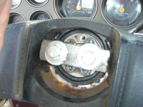

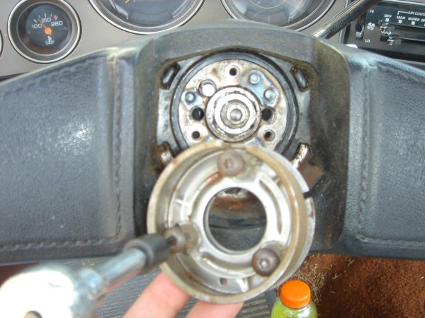

Remove the horn button
Remove the horn contact clip
Remove the horn contact assembly
Remove the horn lead asembly

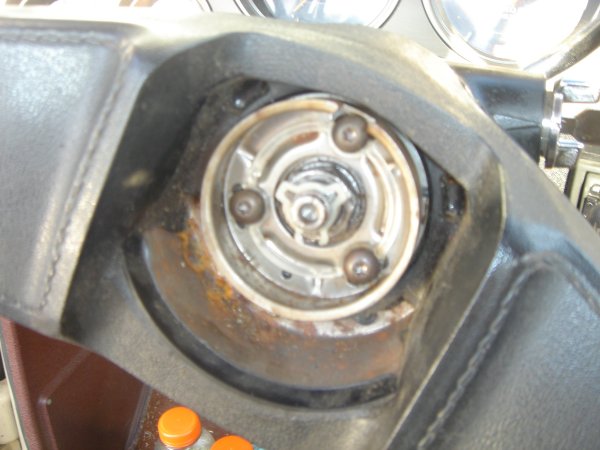

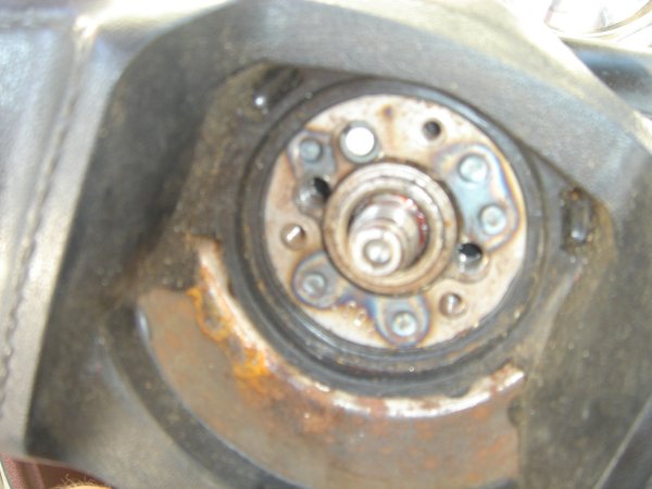

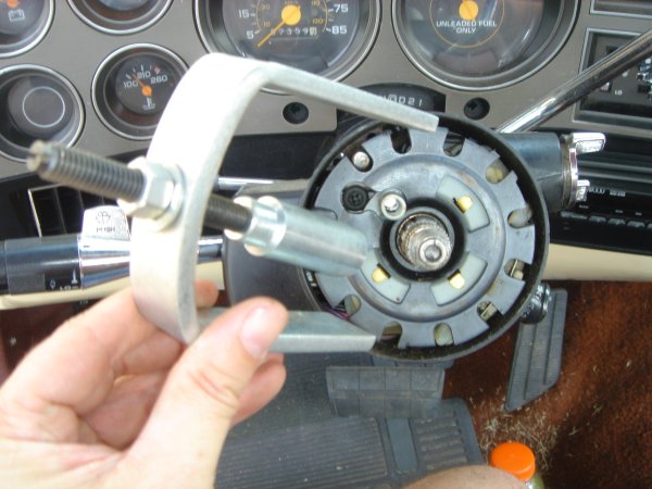

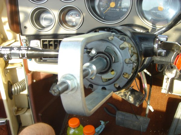

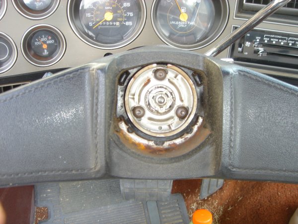

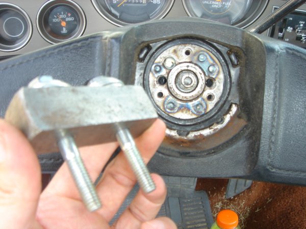

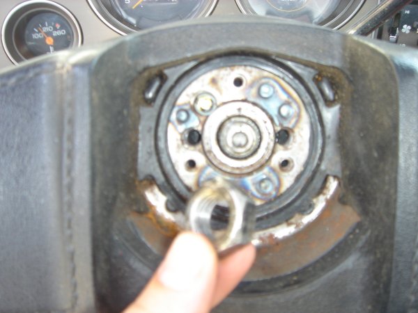

Remove the steering wheel nut
If your wheel and shaft do not have corresponding alignment marks, use a chisel or similar tool to mark them for proper alignment upon re-assembly.

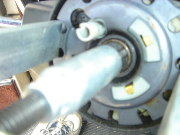

Remove the steering wheel using a steering wheel or crankshaft puller:

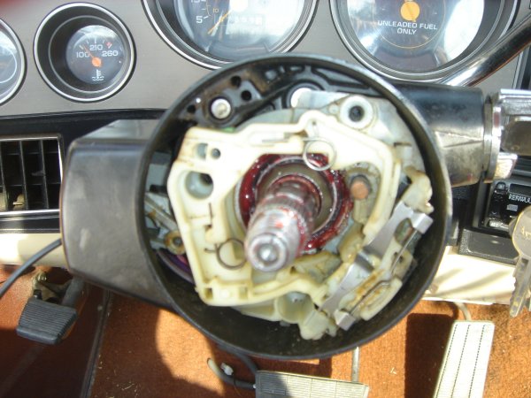

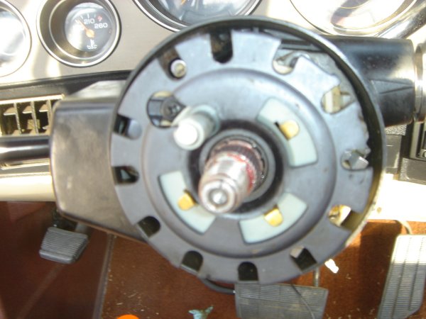

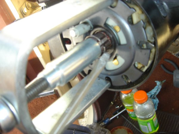

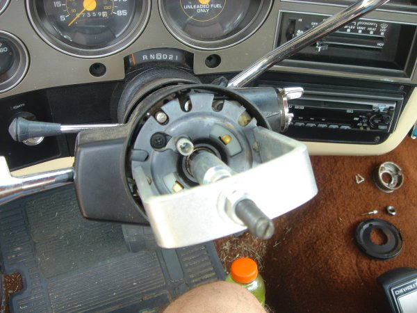

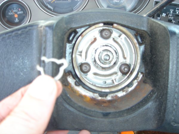

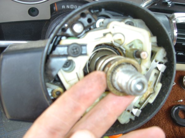

Remove the lock plate dust cover
using a lock plate removal tool
Install lock plate tool

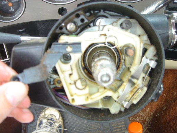

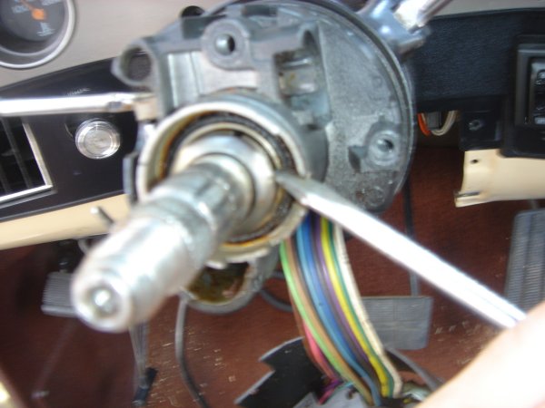

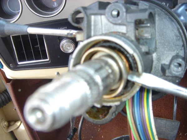

depress the lock plate just enough to expose the locking ring
using a small flat blade screwdriver and a small pick to remove the locking ring.

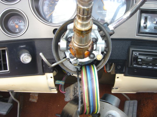

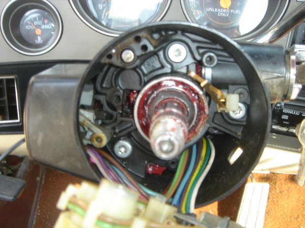

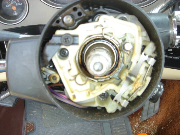

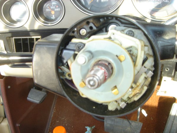

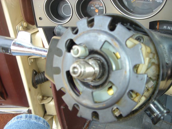

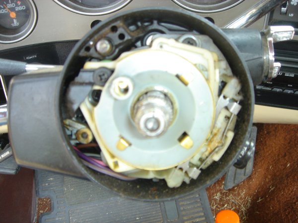

Remove the turn signal canceling cam
Remove upper steering column shaft bearing spring
Remove the turn signal switch actuating arm
Remove the three screws securing the turn signal switch to the upper bowl assembly.

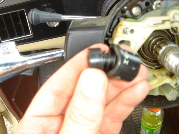

Remove hazard warning switch button

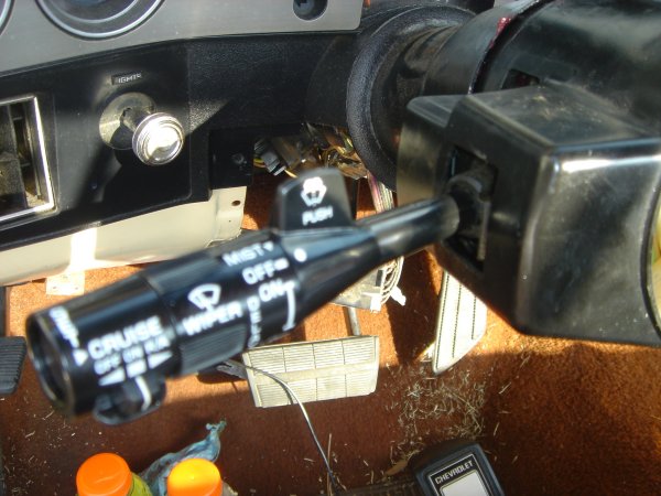

Remove Wiper arm stalk (just grab it and pull it straight out

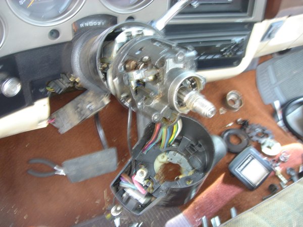

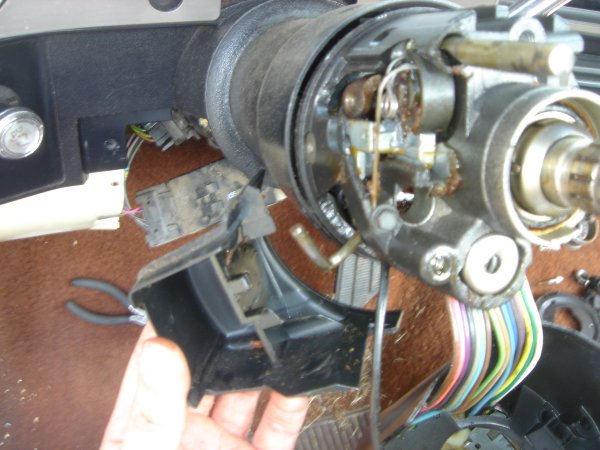

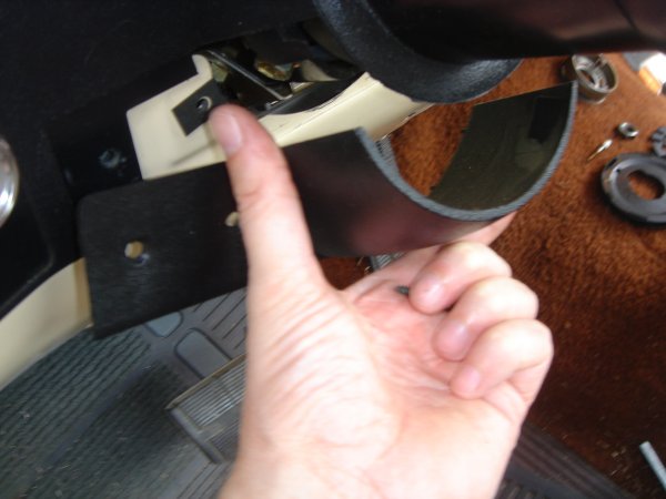

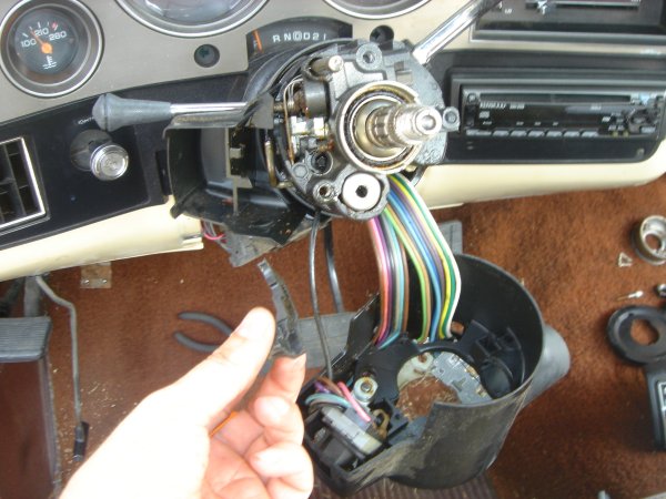

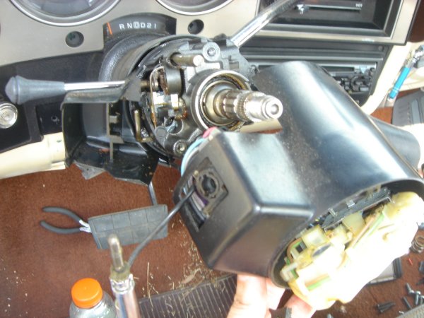

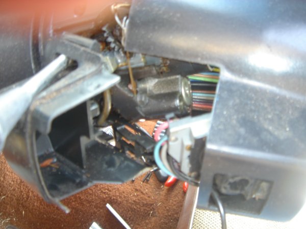

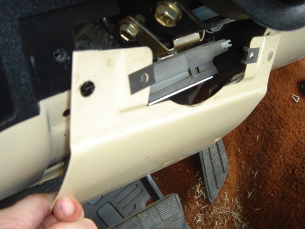

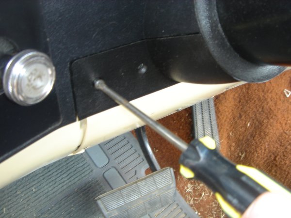

remove the plastic lower column cover
once the screws are loose just lift it straight up

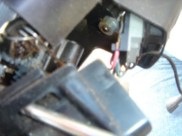

Remove the metal lower steering column cover

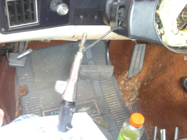

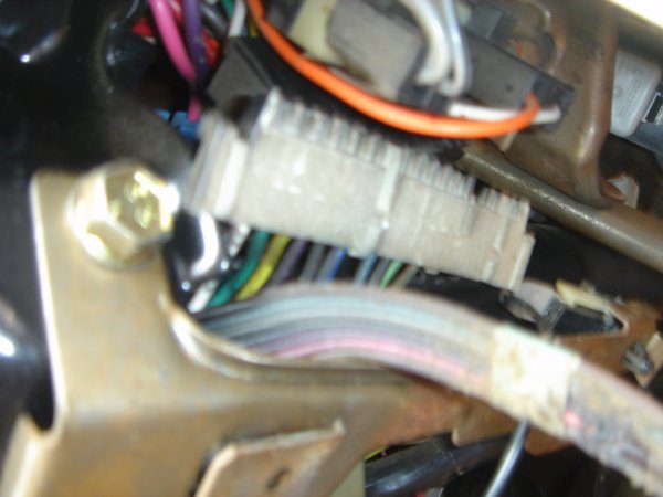

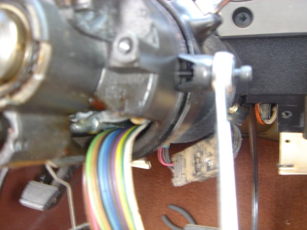

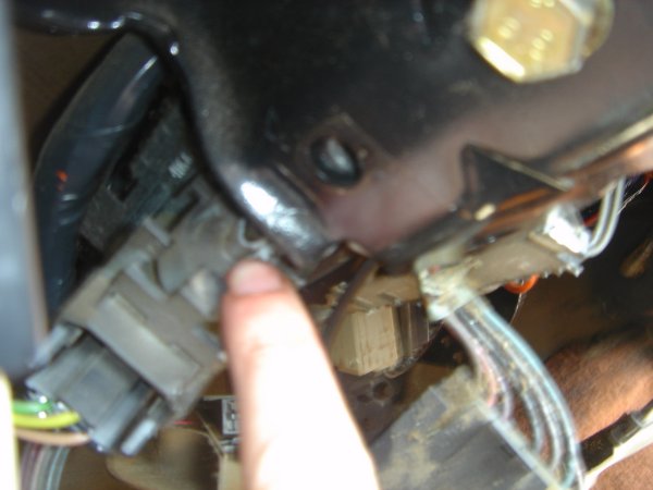

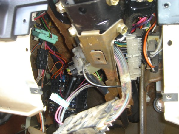

Locate and unplug the turn signal switch and wiper switch electrical connectors
Pull the turn signal switch and wiring towards the back of the car as far as it will go
removing the lower steering column support bracket is NOT required. Let the switch hang free.

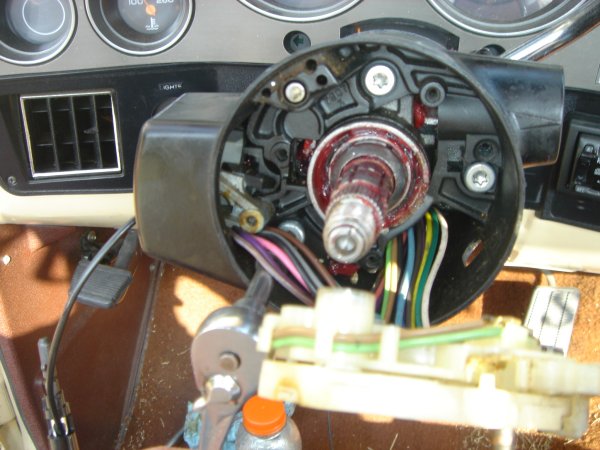

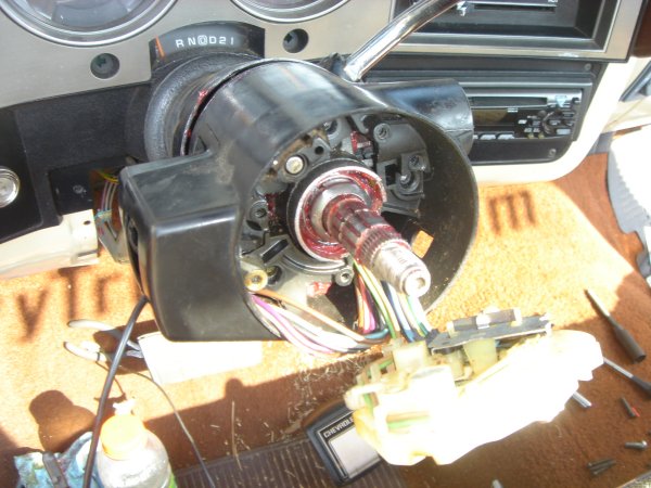

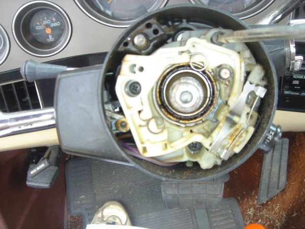

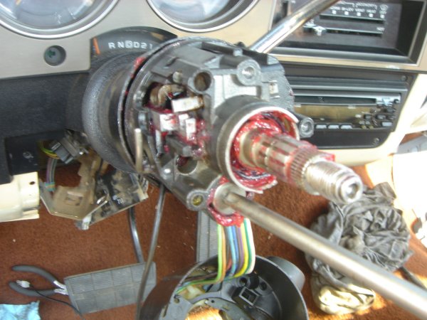

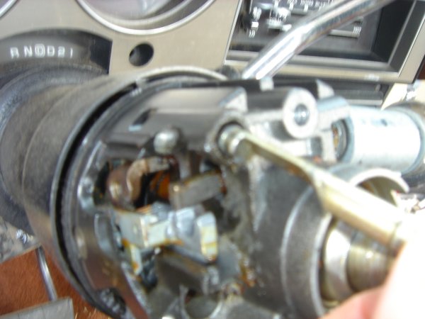

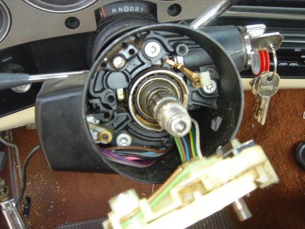

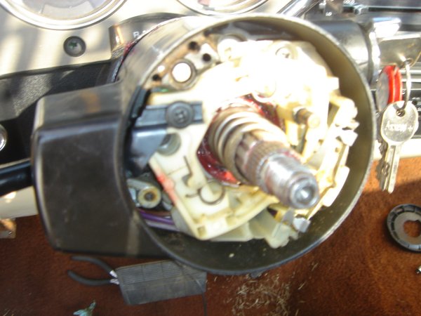

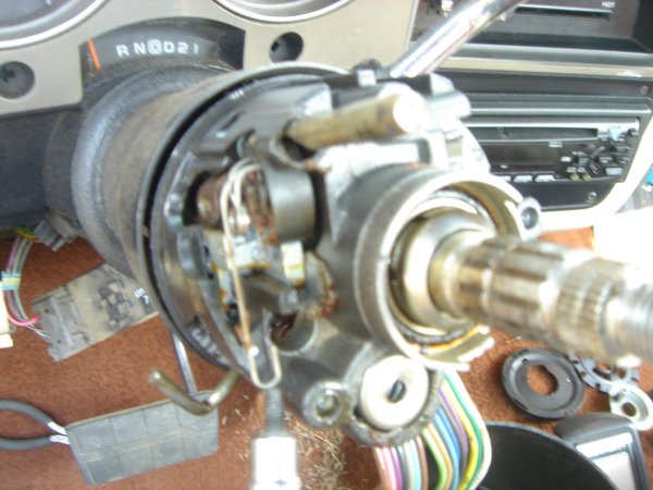

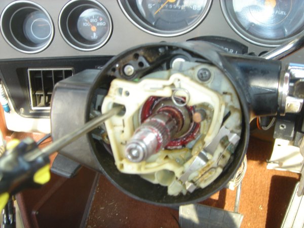

With the cam assembly removed you can see the the three screws securing the turn signal switch to the upper bowl assembly

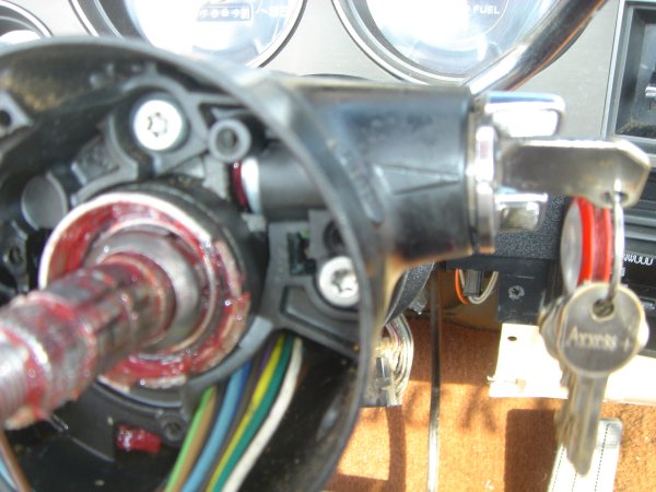

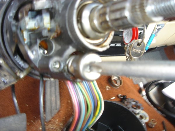

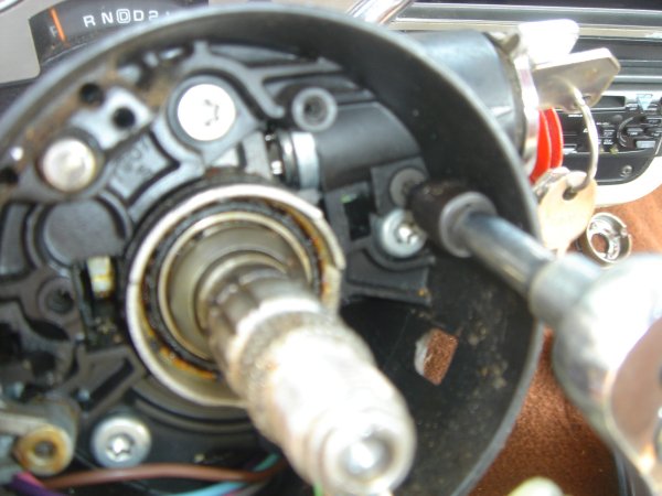

Remove the key-in ignition warning buzzer switch and spring.

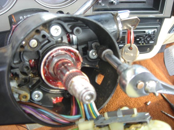

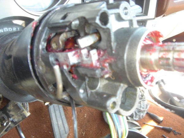

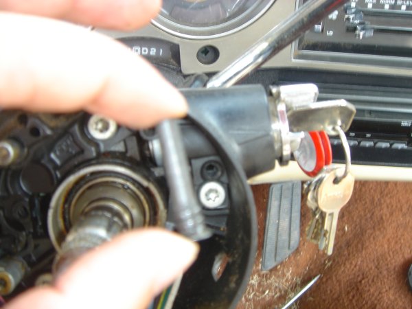

Remove the lock cylinder retaining screw using  #20 Torx bit
Pull the lock cylinder straight out

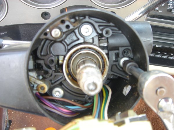

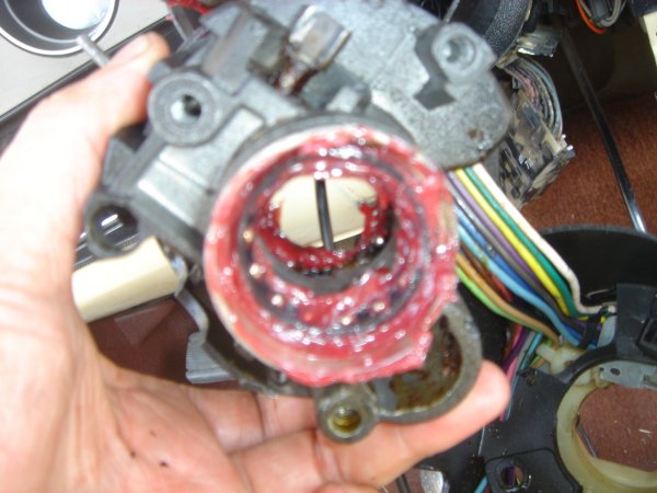

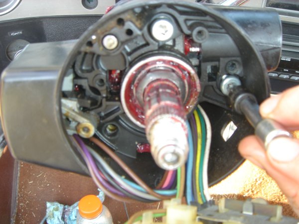

Remove the three screws securing the lock cylinder upper bowl assembly using a #30 Torx bit.

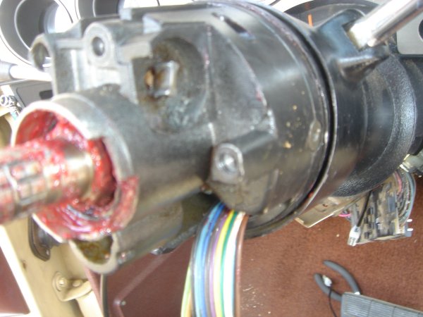

Seperate the upper bowl assembly from the lower
Pull the upper bowl assembly back while pulling on the wiper switch wiring and let hang free
Pull the upper bowl assembly back while pulling on the wiper switch wiring and let hang free.

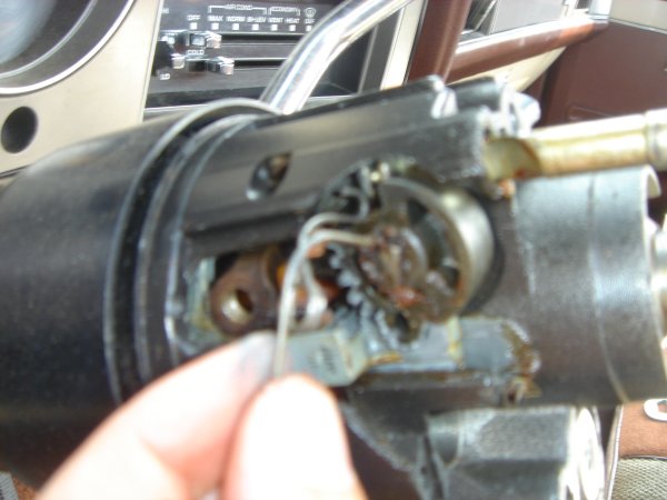

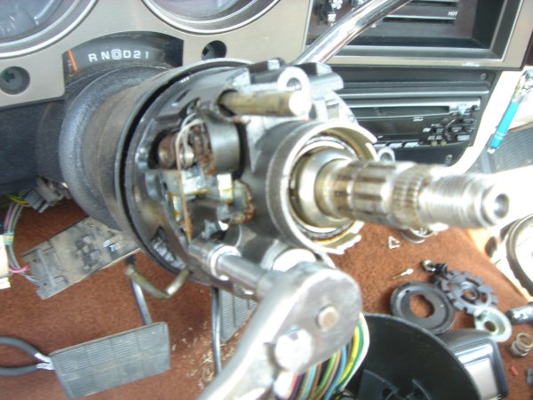

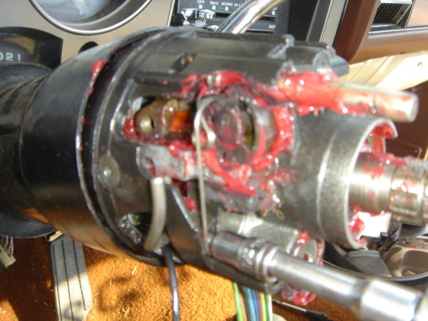

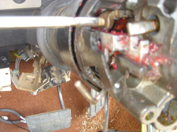

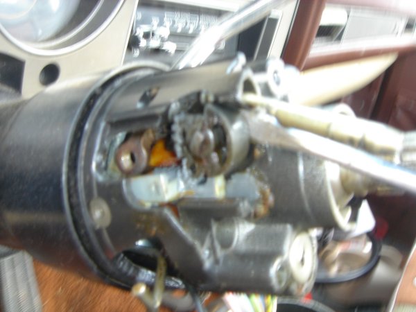

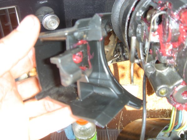

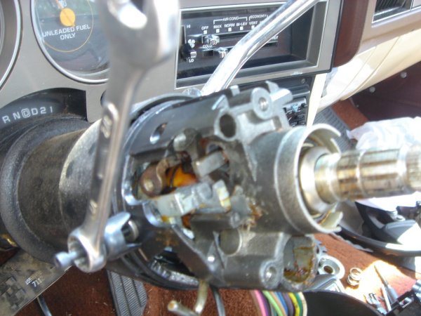

Remove the tilt lever

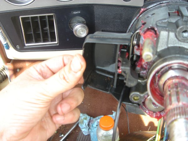

remove the dimmer switch actuator rod and sector cover housing

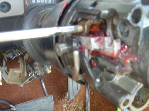

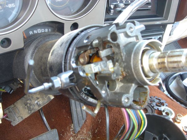

Remove the screw securing the shaft lock bolt spring using a 1/4 socket
Unhook the spring from the shaft lock bolt
Remove the spring
Remove the bolt.
Pay particularly close attention to the lock bolt, spring, ignition rack and sector positions for re-assembly.

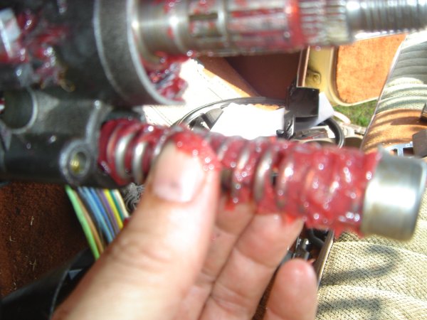

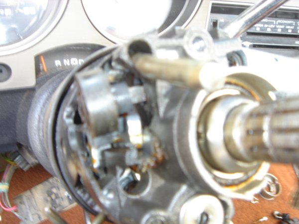

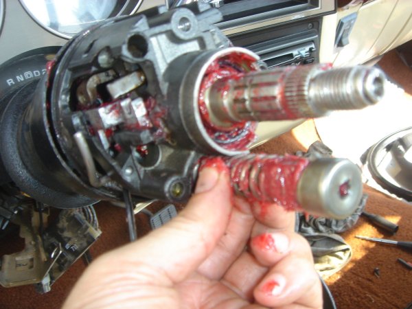

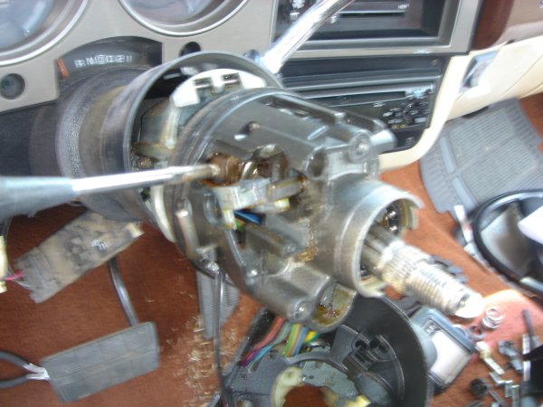

Push the tilt wheel spring retainer in with a #3 Phillips screwdriver and turn counter-clockwise and remove spring, retainer and spring guide.

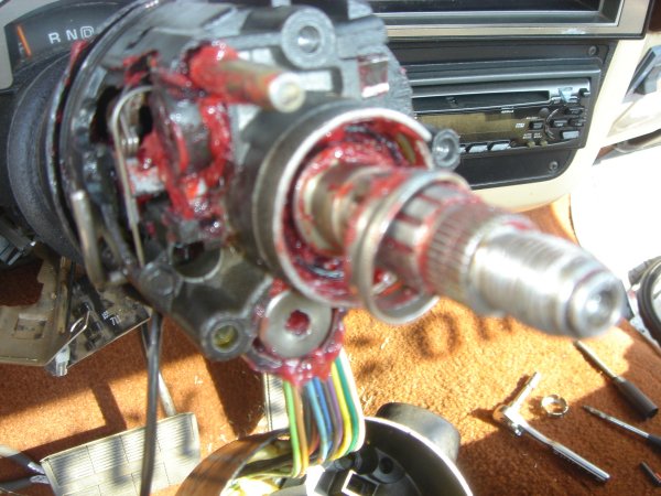

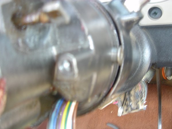

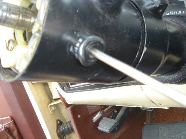

remove the column housing by removing the two pivot pins using the pivot pin removal tool
Remove the pins from BOTH sides

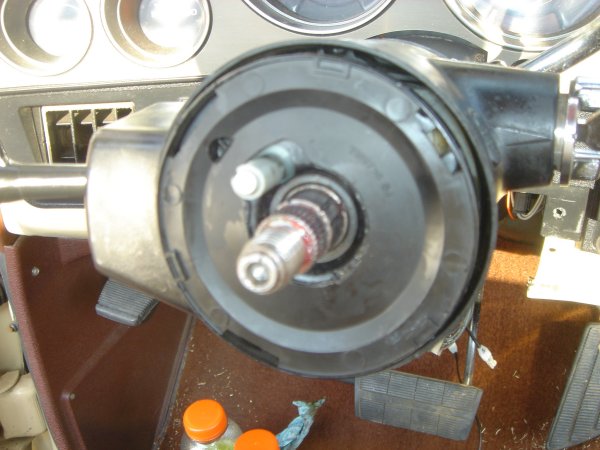

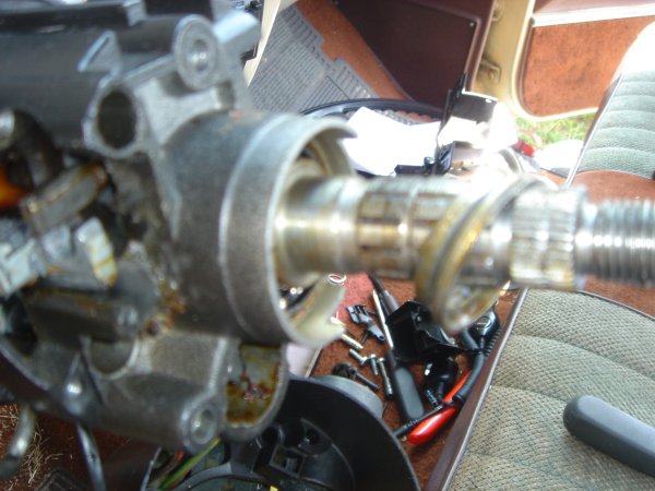

remove the upper steering shaft bearing retainer.
remove the upper steering shaft bearing race.

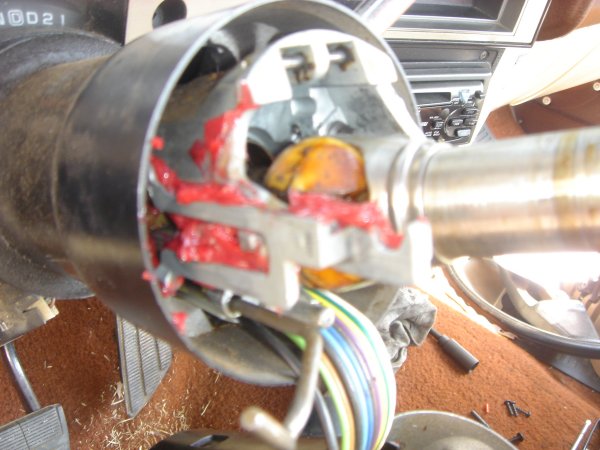

Reinsert the tilt lever and pull toward you to unlock the housing assembly from the shoe assembly and pull the housing back and away. Remove the tilt lever again.

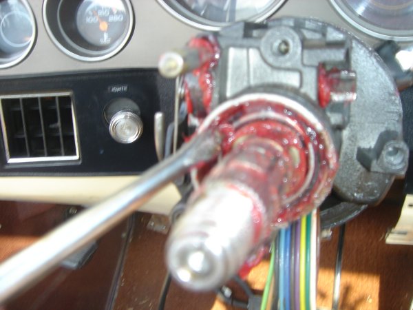

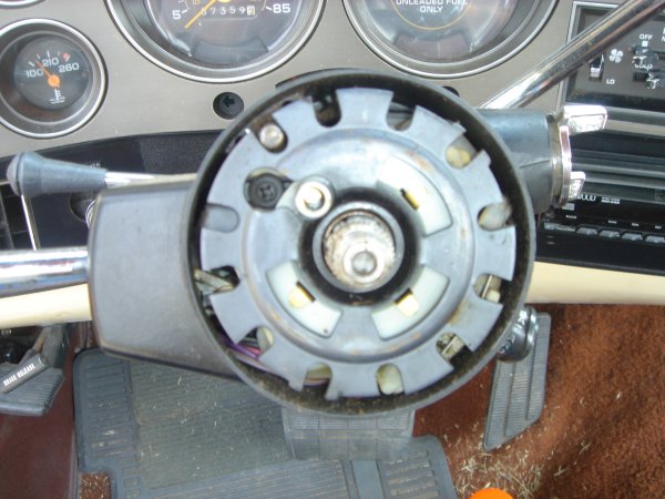

The four screws that causing the problem are now accessible.
Remove each screw one at a time, clean the threads, apply a dab of threadlocker and reinstall and tighten

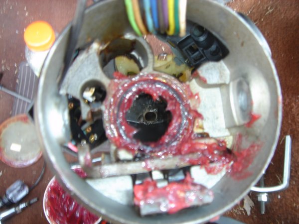

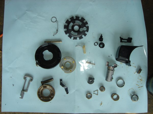

At this point you have a this assortment of parts to reinstall.  It is a good idea to clean them up before reassembly.  clean the parts brake-clean and a rag.
It is a good idea to coat the parts and surfaces with bearing grease for lubrication and retention
