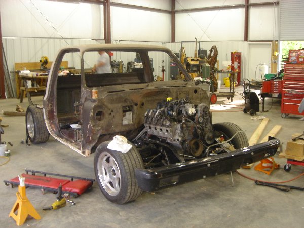

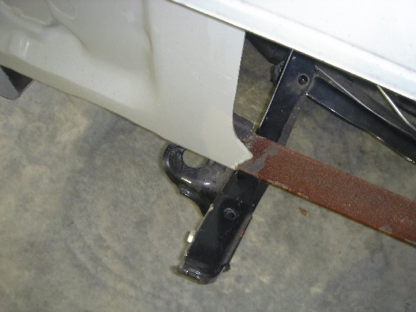

Saturday April 14th:  Expected to bolt the manifolds on only to find out that they don't work.  Started getting ill.  Apparently I need to get some manifolds now.  After a bit of a lull, we decided to check the drivetrain angle.  It was OFF by about 3 degrees.  So now I need to make a new trans crossmember.  The Tranny tail needs to come up some.  Since all of the parts are not yet on the truck, we decided to mock up the frontend and get the tilt ready for mounting.
We decided to mount the cab back on and check for fuel line mounting clearance, transmission clearance and firewall clearance.
While we had it on we decided to get the bumper mounted and then get ready to chop the rad support for the tilt frontend.  We mounted the '81-87 bumper bracked on the '80 frame and then mounted the bumper.

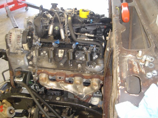

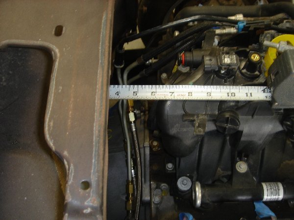

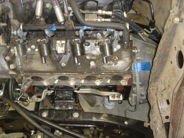

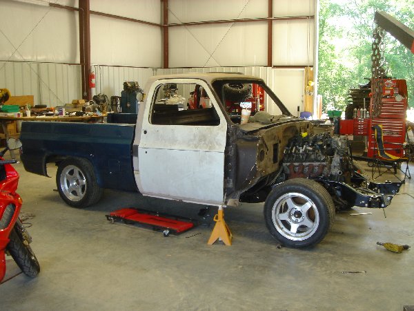

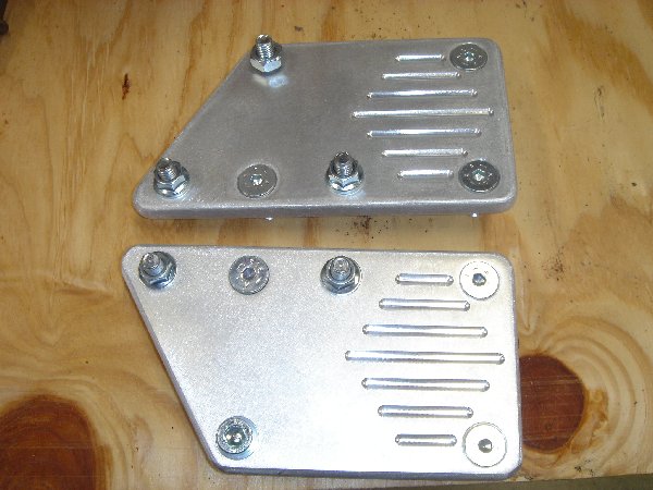

Found out the reason nothing was working the way I thought they should.  Without even thinking about it, the motor mounts I ordered use the existing LS motor mount location which is 4" behind where the "normal" SBC mounts are.
These are the pictures of the engine mounted using ECE mounts:
Wednesday April 26th: Ordered a set of LS motor plates from S&P to mount the engine in the correct posistion.

Monday, May 1st:  Recieved the engine plates from S&P.

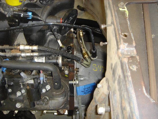

Saturday, May 14th: Drove up to pull the ECE mounts off and replace them with the S&P mounts only to find out when I got there that I had left the motor shells at home STILL bolted to the 454..  It went downhill from there...

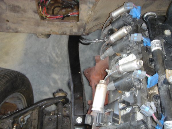

Sunday, May 15th:  Unbolted the motor shells from the 454 and sent the 2 sets of manifolds BACK to the shop.  The new mounts should solve the clearance problem with the frame.

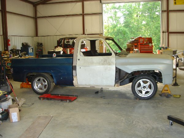

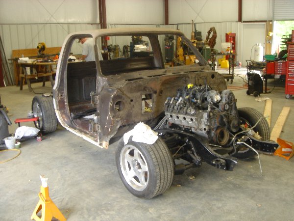

Just posting a teaser pic from this weekends progress, I will add another post later when I get more stuff uploaded.

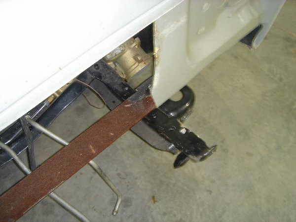

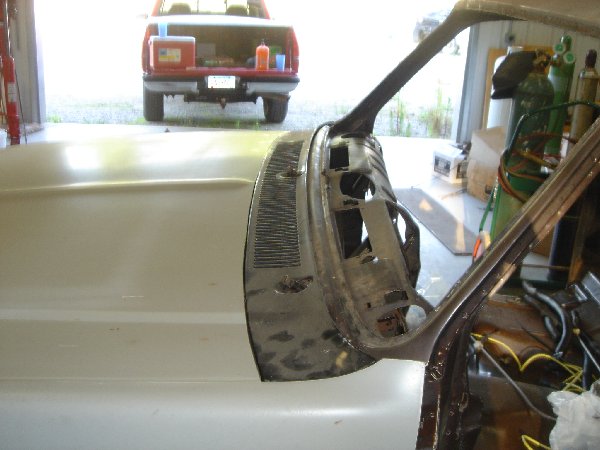

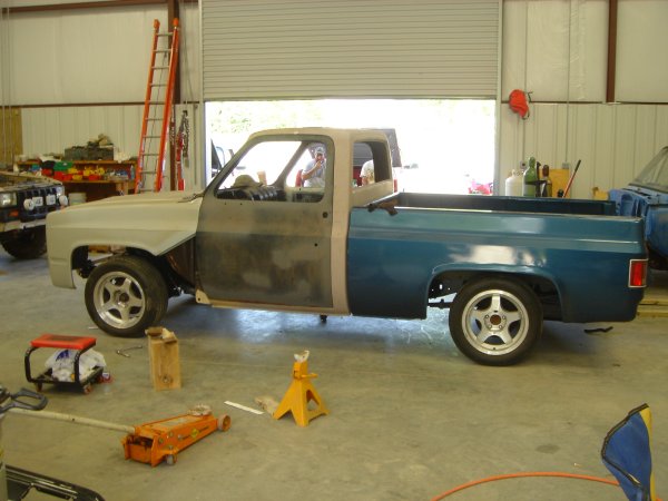

We got the new mounts on, chopped the rad support (more than once) pulled the tilt out of the crate, and mocked it up, then Sunday we got serious, and chopped the rear cross sill for the bed to gastank clearance and put the doors, bed and tilt on. Now comes the fun of actually aligning all this stuff...
For now.....

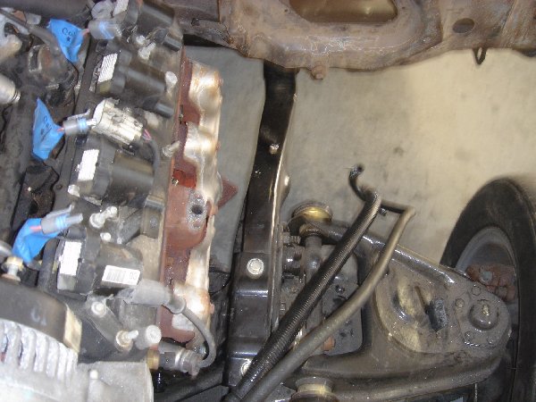

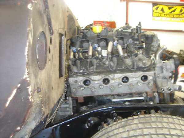

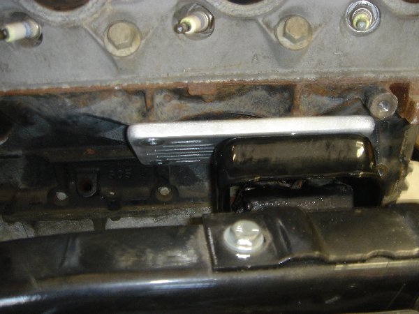

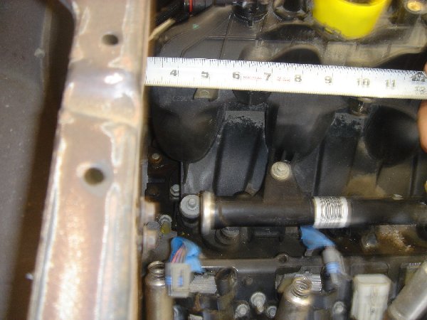

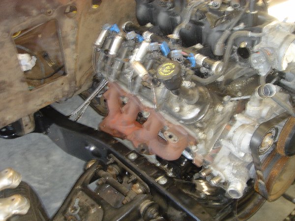

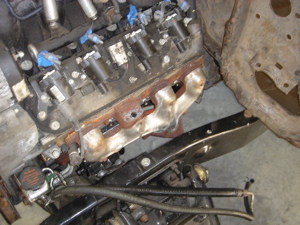

Saturday May 20th: lifted the motor up and pulled the ECE mounts off and replaced them with the new S&P plates.  Installed the "normal" SBC mounts and dropped it back in place.  As you can tell, the motor sits back quite nicely now.  Once the plates were on I took the original Truck manifolds and test fitted them.  The driverside fit fine.  The passenger side still hit some (of which I had expected) and I chose to see what I can do along the lines of grinding down the area I don't want to use since I liked how they exited the truck.  After some grinding I got it so it doesn't hit.  Now I just need to plug the hole off.
Once that was out of the way we decided to pull the Tilt frontend out of it home of about 8 years.  We pulled it out and set it on the truck for a general idea of what we were up against.

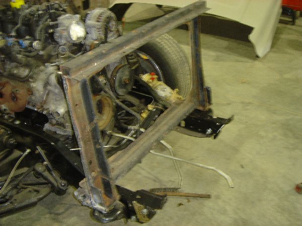

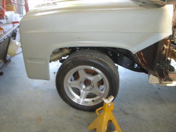

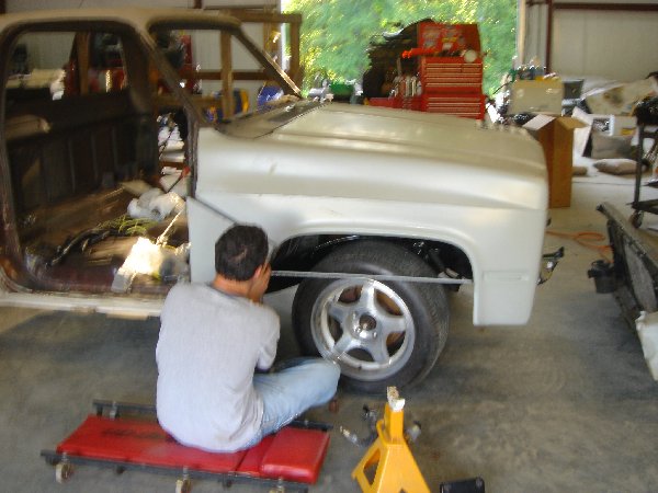

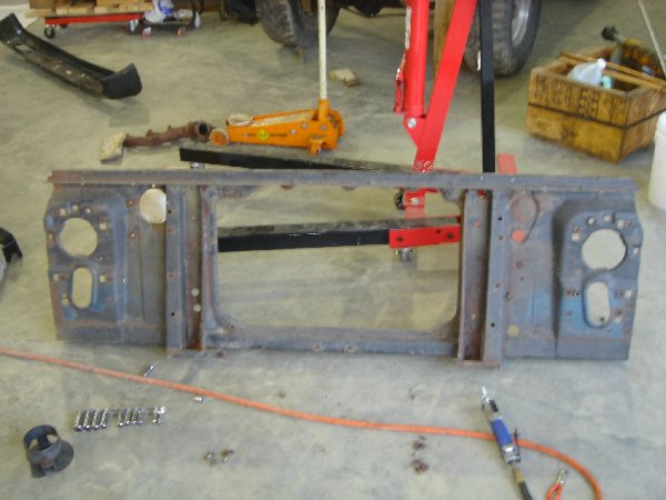

Sunday May 21st: After successfully removing the Tilt from the crate we decided to start on the core support next.  Since the leading edge of the core support is built into the tilt A LOT of metal had to be removed and we still are not done.  I plan to update my How-to section on captkaoscustoms.com with the process, but here is what we started with and here is where we are now.
Once we got this far we realized that there were going to have to be some modifications on the mounting of the core support and we needed to get all the body panels back on.  We trimmed the bed for the Blazer tank Mod and then set it down on the frame.  The we mounted up the doors and tried to get them aligned as best as we could.  (yes these are GM doors from another truck and they need some serious work to be perfect)  Once we got the body line fairly close we began the inspection process and dropped the frontend on and tried to align it.  This is were we are currently
