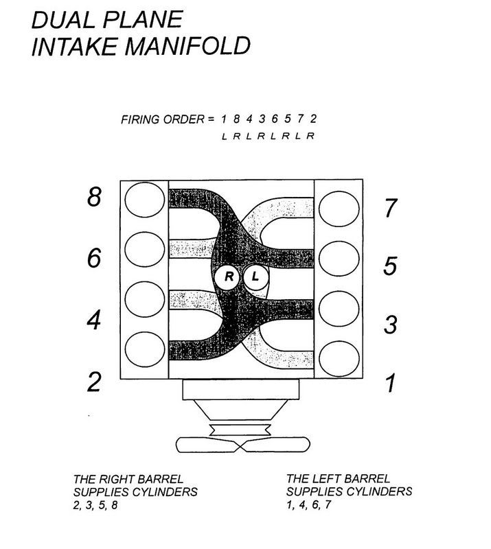

A divider is not what makes it dual or single plane. A dual plane intake actually has one chamber that feeds 4 cylinders. 2 on the left bank and 2 on the right bank. The other chamber does the exact opposite. If I get a chance I'll post a nice picture that will help you see it better

Post by: VileZambonie on March 30, 2007, 08:49:00 am
Title: Re: Dual Plane
Post by: Tire Burner on March 30, 2007, 10:12:00 am
Hmm, I knew there was a reason i came here for my answers. You're right, that IS alot differant from using a Divider in a Single Plane Intake Manifold. I will have to try a Dual Plane. Have to stay with my Current Setup for a Little while though. Now that i have Experiance in Intalling an Intake, It shouldn't be too hard to Make that change for Comparison Reasons. If i used a Carb Spacer, would that work against the Low End Power of the Intake? I've been told that the Rise of the Intake improves performance, but all of the Dual planes that i've seen are low.
