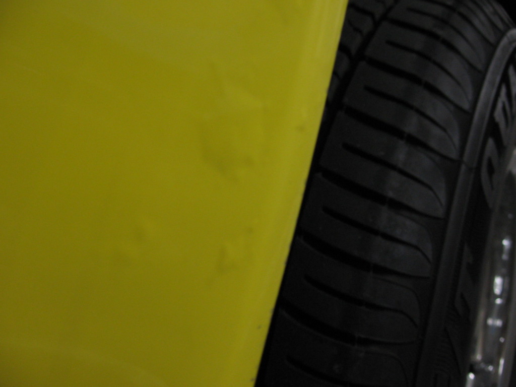

Are any of the body panels double-walled on these trucks? I have an 85 Silvey shorty and the paint has bubbled in the past few months behind the 1 rear tire. The backside seems fine so I'm suprised it did this. Paint is 6 years old. I would worry about moisture getting in between the panels if there were any double-walled ones. Thanks.

Ohhh okay, so just from the bed floor up is double-wall. Alright.  Well now I'm a bit puzzled why my paint is bubbling down at the bottom of the rear 1/4, just behind the wheel opening. It feels solid from behind yet the paint is bubbling from in front.

Post by: SUX2BU99 on October 13, 2005, 08:38:00 am
Sent.
I figured out what I was looking at. The inner wheelwell and the bedside create a pocket that is perfect for crap to get up into and start corrosion on the bedside near the bottom of the wheel opening. Anyway, I took pics and sent them to you.
Thanks!

Here is the main pic of the rust:
The pocket is from the brace support on the rear fender.  There is no replacement for that, but the outer part would be cut/seperated and a new piece welded in.  Based on what I saw, I would probably grind it down and see how bad the rust was.  If it is just pinhole it could be welded back up and sanded smooth.  What does it look like behind the brace?
Have you had your bodyman look at this?
