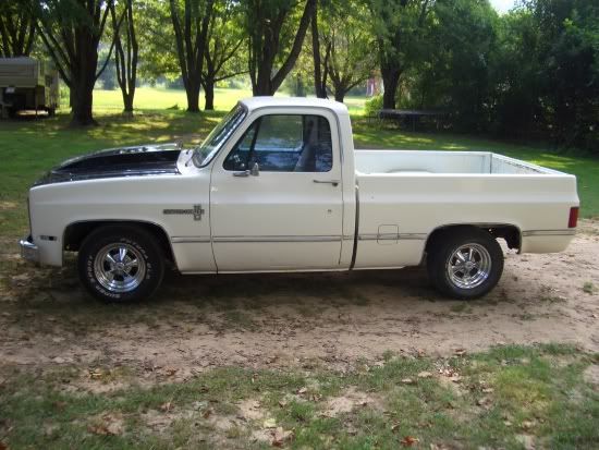

mine is a 86 2wheel drive auto the other cab is also 86 auto 2wd. only diff is mine is the custom deluxe not sure what the other is it just has a light in the cab and on the back above the bed. an mine dont which is no biggie. im just nervous about all the wiring. im not going to keep a/c on this truck just a defrost/heater. and plan on doing the autometer gauges in dash while swaping
here is a pic of the truck before i start incase i dont get it back together lol jk

What is wrong with your cab? It looks pretty clean in the pic! Wiring is simple enough, its just a big harness under the dash. Unbolt the one center bolt under the hood that connects the engine, tail lights, & head light harness to the back of the fuse box through the bulkhead connector. You unbolt the fuse box from the inside of the fire wall and pull the harness out. There are a few grounds and plugs to undo. Swap it into the other cab and reconnect the three harnesses.

well when you open the door its rusted pretty bad an whoevery had it before me did some bad bondo work on the cab corners. the floor in the corner all the way up drivers side is rusted through you can see pavement lol the new one is awesome no bondo or rust an nice doors jus need to replace the weatherstripping an make manual windows instead of electric.
