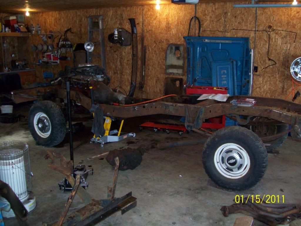

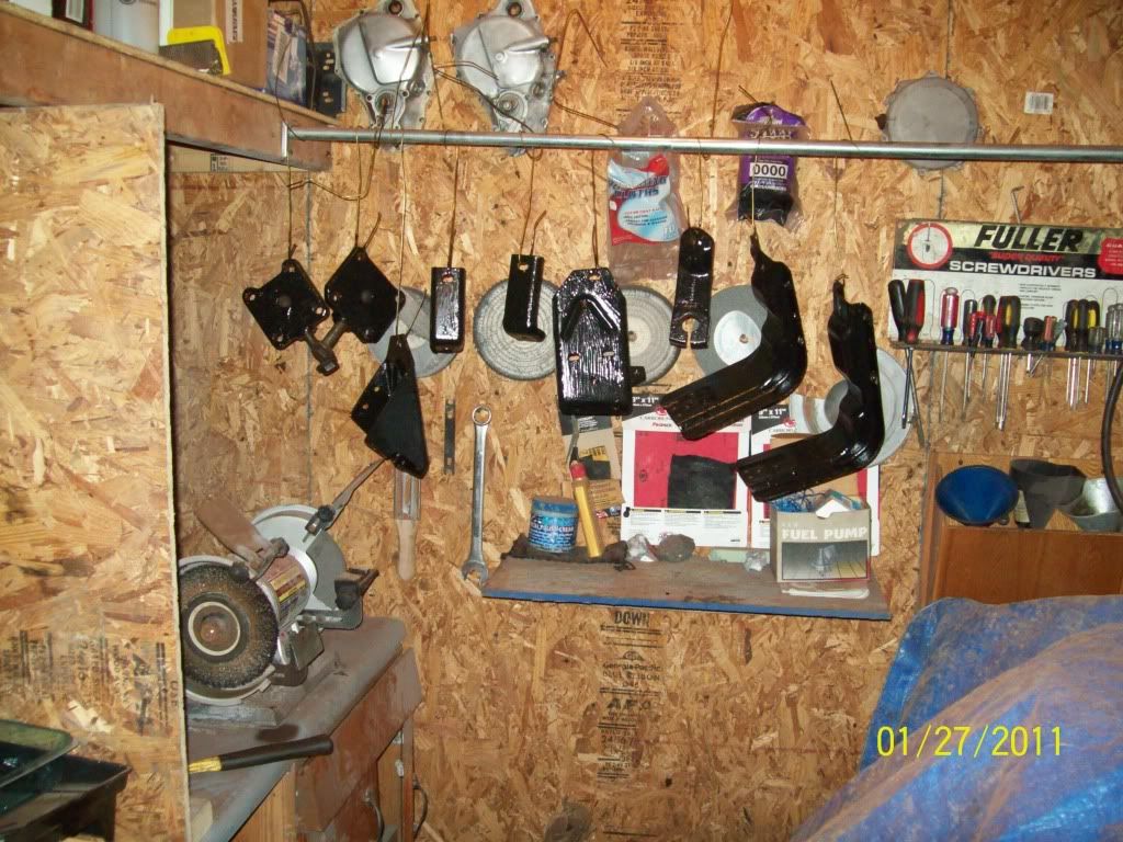

Well Ive been working pretty steadily on the 73 I inherited in the last month or so and I thought I would make a thread showing the work I'm doing as I do it ... I don't have a lot of pictures as of yet but Ill get a few up today if I can figure out how...
Its a 73 Chevy 4x4 Stepside shortbed that I'm doing a frame off resto on ... truck was in kinda rough shape when I got it so I had to go down to the frame to make it look good when I'm done

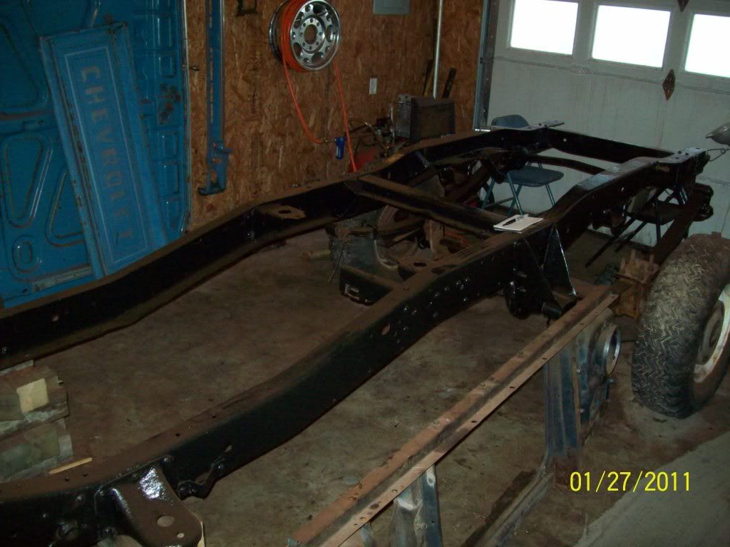

So far Ive got the frame sandblasted and painted with Dupont Colar 2.1 ST Satin High solids Epoxy Mastic (LF-64025P Black)
I also painted all the crossmembers the sway bar motor mounts PS box and some other odds and ends with the same paint ... its a VERY durable paint thats made to withstand rough conditions and prevent Rust (I also used a Rust converter primer before I painted to make sure rust mover comes through) I HOPE

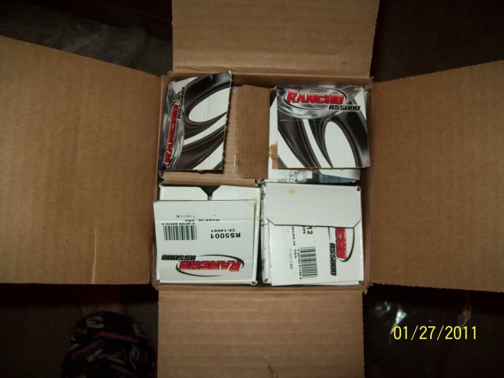

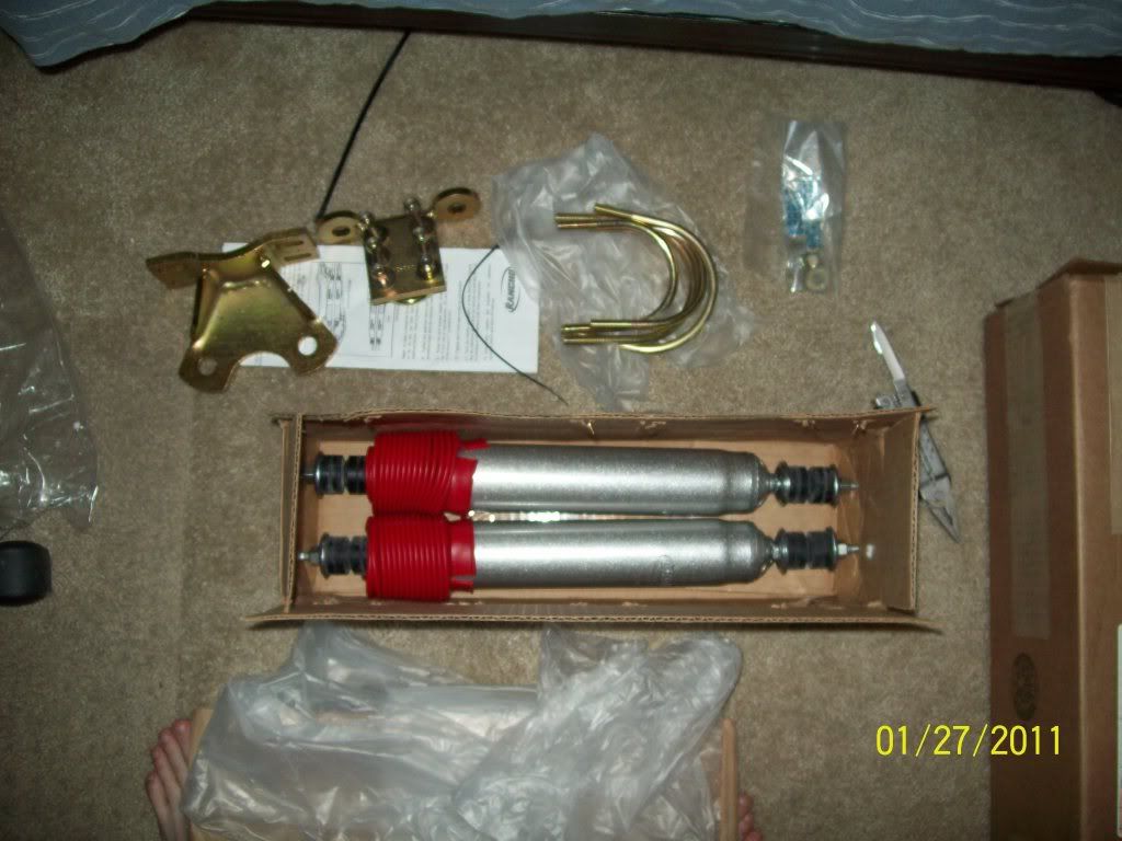

The truck had a 4" suspension lift so I got all new Rancho RS5000 shocks and a the Ranch Dual steering stabilizer kit (To replace the ones that were already on it) I have not installed any of this stuff because the paint I used takes a week to fully cure and I'm also waiting on some more parts from   that should be here today .. New tie rods wheel bearings upper and lower BJ's drag links etc etc
Ive got the front end completely out from under the truck as of right now and once the parts are here I will completely disassemble the unit and clean sand and paint it the correct Matte black along with the springs, perches and U bolts then Ill reinstall it ...
Once that is done Ill remove the rear end and do the same to it .... I'm not using the frame paint since its hard to make it look smooth and correct with such a thick Mastic and its not the correct coating for the front and rear ends and springs etc

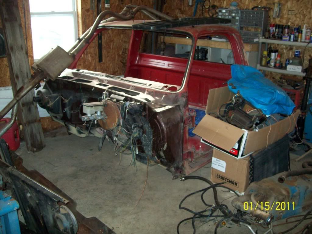

I do think that I'm going to use it on the under neath of the new cab I got though since its getting hard to find rust free floors and supports on these old cabs and mine pretty much is so I want it to last ... the only rust on the new cab is the cab corners and Ive got new ones here ready to go on as soon as I get the cab back on the truck

4 Rancho RS5000 shocks
Dual Steering stabilizer kit w hardware

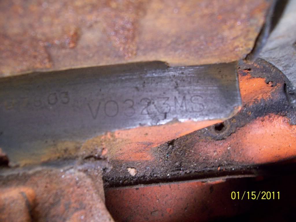

The motor is a 1st Gen 350 from a 68 F/X body SS  (Camaro or firebird) w double hump heads and eldebrock intake and carb and lots of chromes goodies
I couldn't believe it when I checked the casting numbers but ya ..... I'm torn between selling the motor to someone restoring an old camaro and using the money to buy a nice crate 350 and just going though it and freshening the rods and mains and new gaskets and such and doing a little work to it and having a really cool powerfull motor in the ole step side but Ill probably keep it since the only way Id ever get what the motors worth is to part it out on ebay  then Id have to go through shipping all the stuff and I really don't wanna have to deal with that

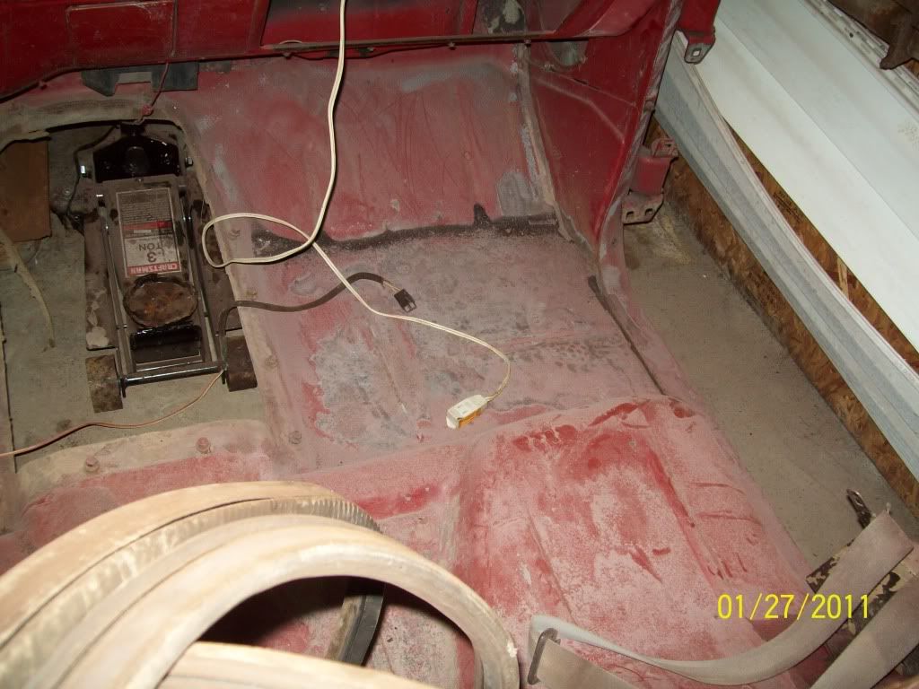

I sandblasted some common trouble spots on this cab that I bought for 200 bucks and its really pretty solid Like I said earlier about the cab corners ... but the door seal groove where the rocker panel is pinch welded on usually gets soft and this one is tough as nails ... Im really happy with it ... just some dents to straighten and a couple cab corners and Ill be in business

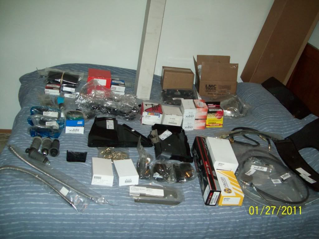

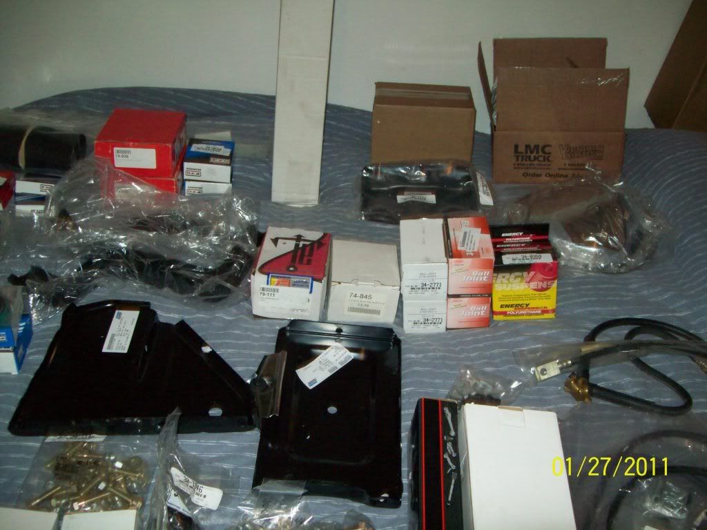

And the parts Ive gotten in this week
