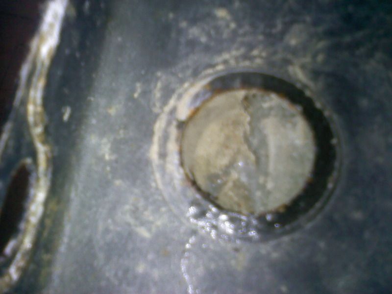

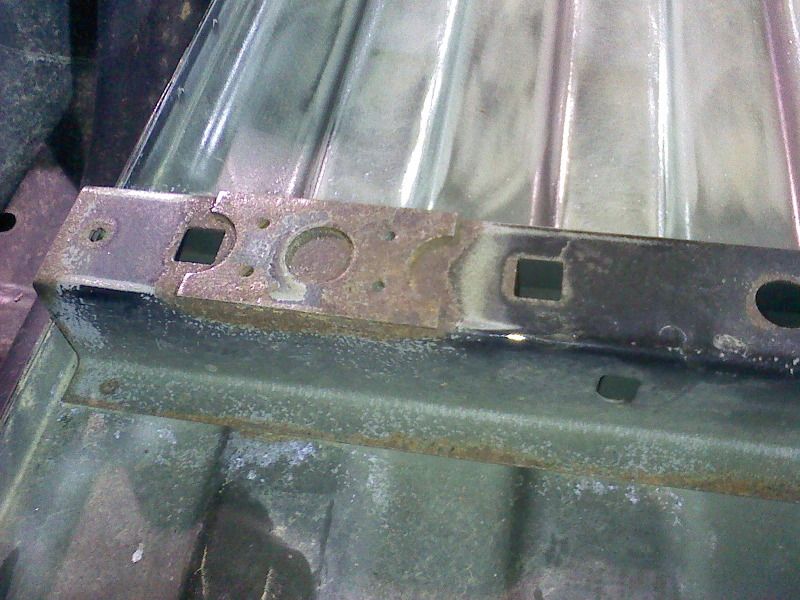

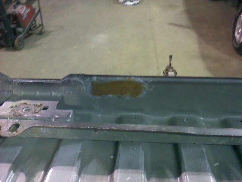

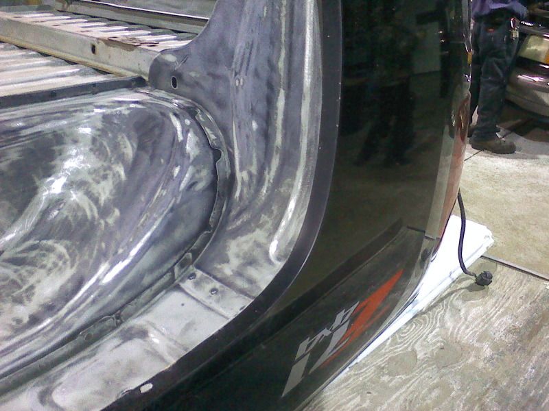

07 Chevy 1500, 36,000 miles, was starting to rust frame, and bottom of bed.

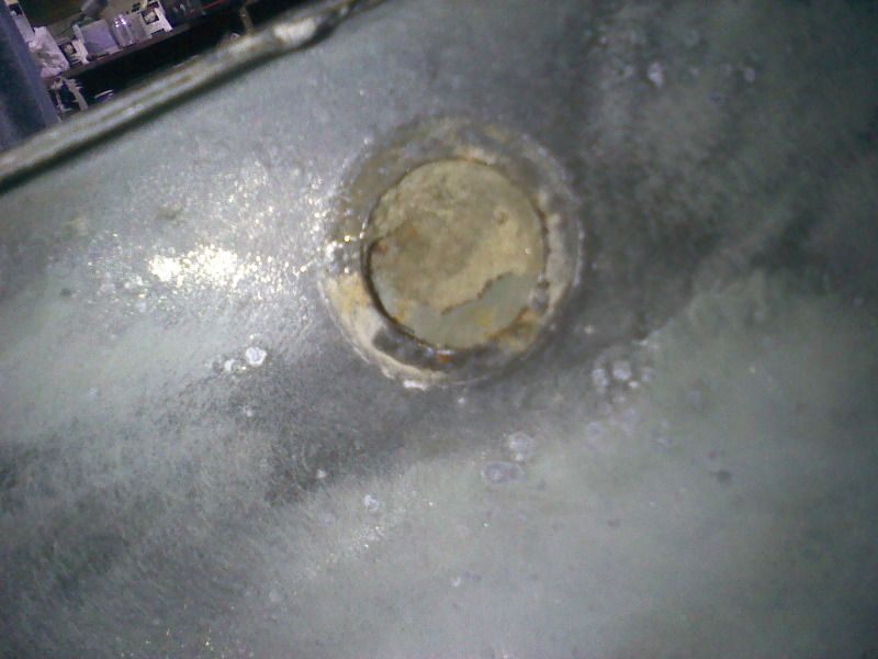

Drain holes inside wheel wells plugged right full of dirt!
Rust on the bottom of the bed:

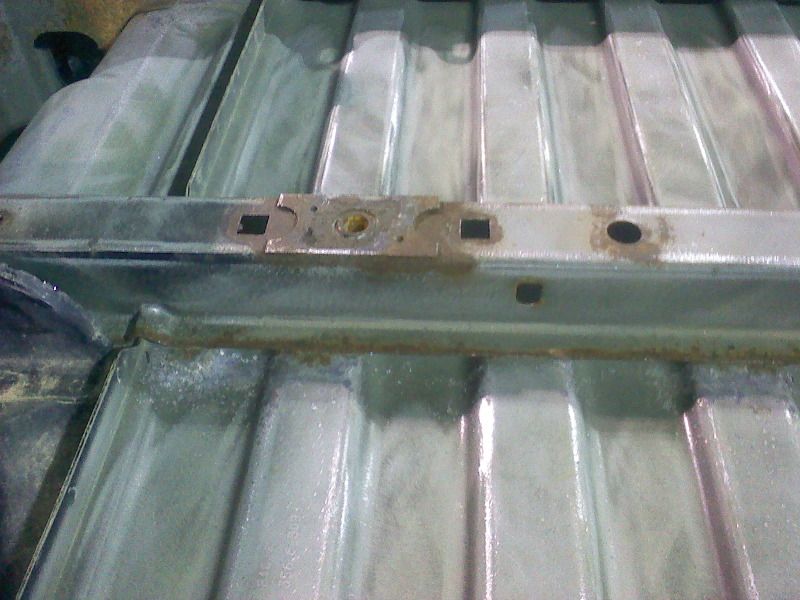

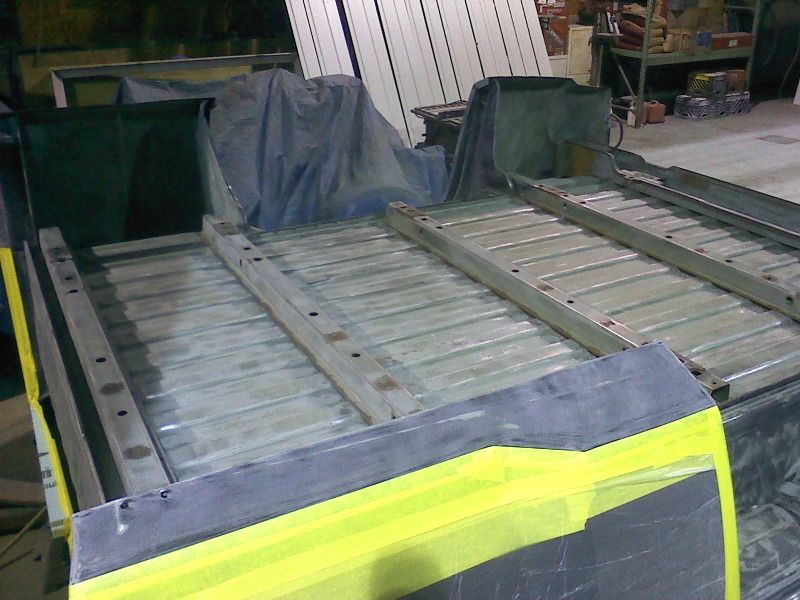

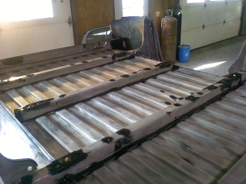

Sanded with 80 grit:

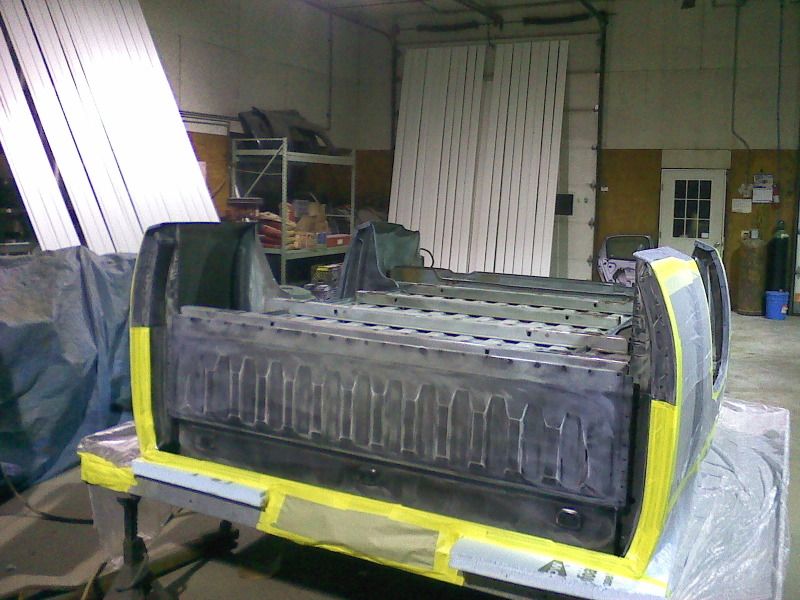

180 grit on front panel:

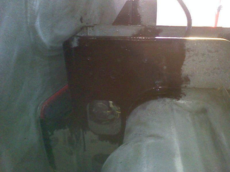

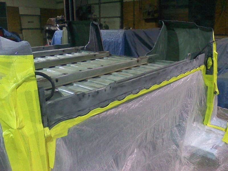

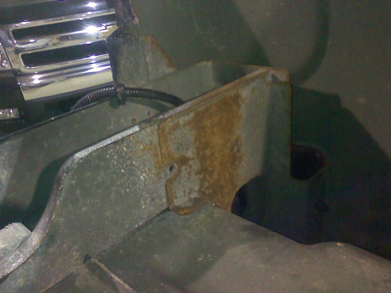

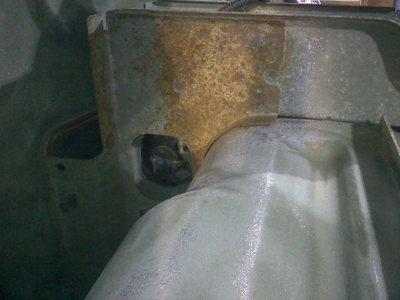

Chassis Saver over all the rust after they had been needle scaled:

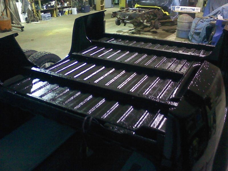

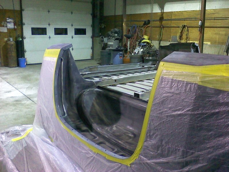

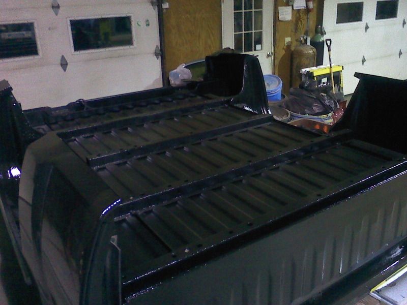

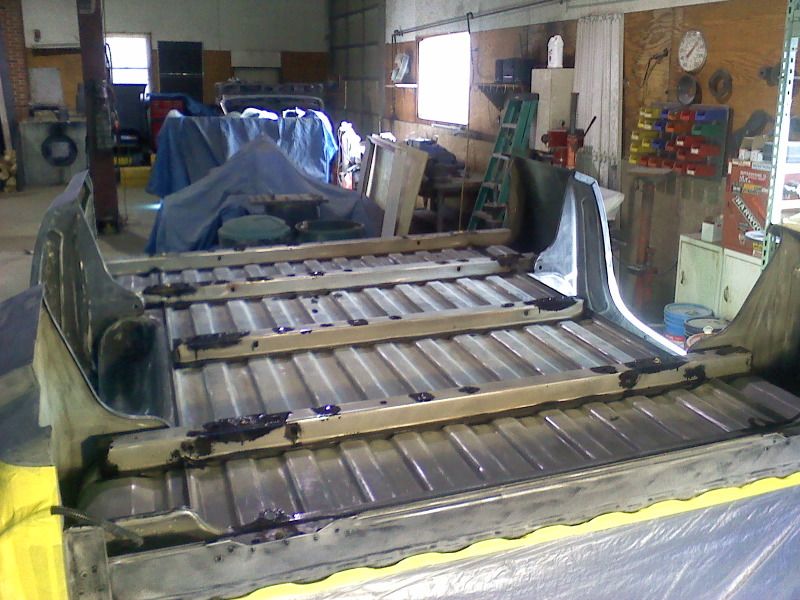

Entire bottom side of bed, & inside quarters sprayed with SEM bed liner, then top coated with an inexpensive single stage urethane paint

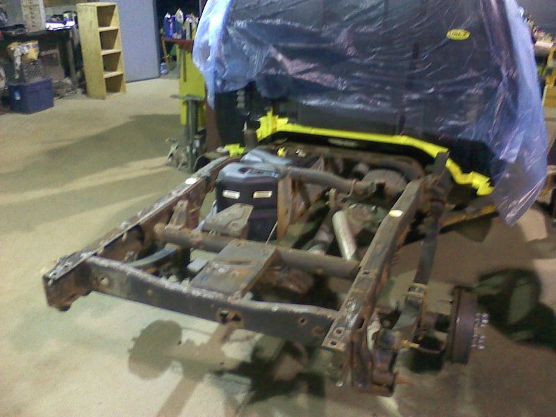

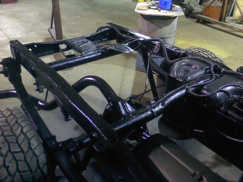

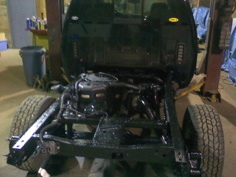

Frame scrubbed with Super Clean, needle scaled, ready to be sprayed with Chassis Saver, SEM, and paint:

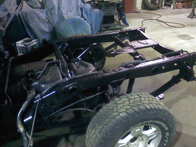

Sprayed, ready to go back together:

Two things against this truck. Its 4 miles either way from his house on a dirt road to pavement. Plus he works in Virginia. He is only home 3 or 4 days a week, and even then he has a Acura sedan he drives most of the time. His wife has an SUV she drives. It sits for a week or two at a time sometimes. Plus he thought until I showed him washing it did not include bending at the knees, pulling the rubber plugs out of those holes plus the ones in the rocker panels, and flushing everthing out. I did the rockers, and as can be seen in the pics the bottom edge of the bed quarters too. Also installed some nice heavy duty mud flaps behind all four wheels.
