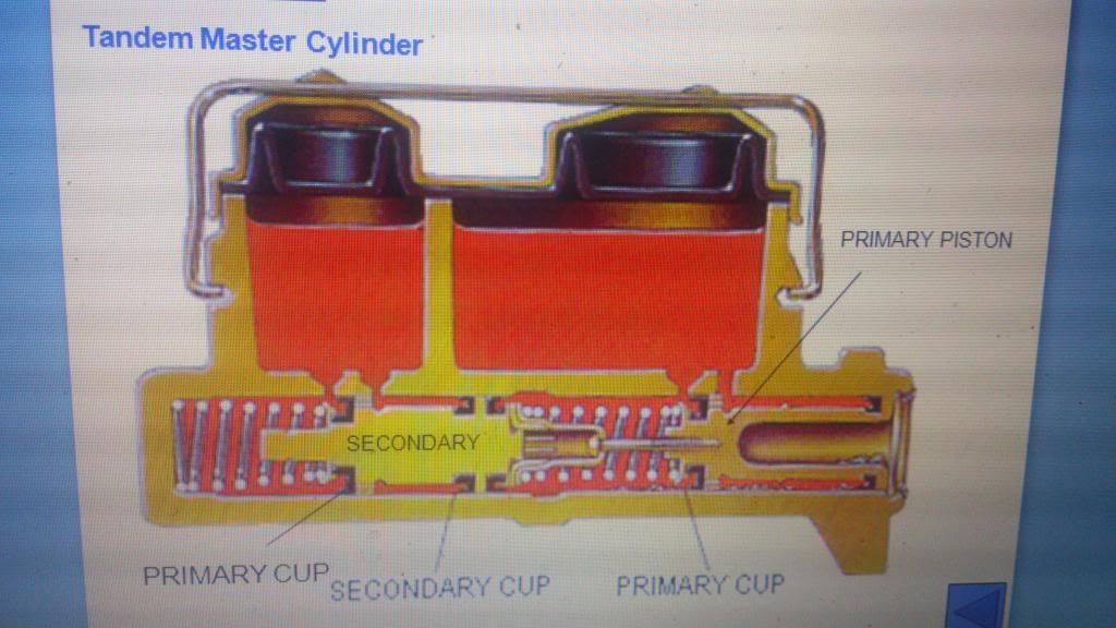

travh123
Posts: 47
Re: Possible Brake Issue
February 12, 2013, 12:42:15 am »
i also would suspect master cylinder. because you have no missing fluid and you have braking at about half way through your pedal. it seems like one of your primary seals on one of the pistons in the mc have failed. when either one fails it takes about half way through your pedal for the brakes to start working. either the primary piston has to travel forward far enough to meachanically push the secondary piston so it can build pressure. or the secondary piston has to be pushed to the end of its bore by hydraulic pressure in the primary system, and when the secondary piston reaches the end of its bore the primary system can build the pressure it needs to apply the brakes. either way you only have 2 brakes working...
idk how clear that was but heres a picture
blazing816
Posts: 391
A Truck Is Built, Not Bought
February 12, 2013, 08:02:50 am »
Thanks....pictures always help. So are master cylinders rebuildable or do I just need to find a new one and if so should I replace the brake booster also, or is that unnecessary?? and if I need to replace it, is there anyone that has done a conversion to get better braking out of these trucks, like something better then vacum assist (but nothing too major as it is in my beater truck).
