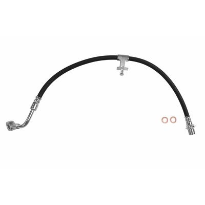

with the brakes. i just replaced my brake hose on my 94. never understood how they "collapsed" but upon further investigation i found the problem was actually with the metal bracket in the middle of the brake like
this bracket will rust and on the inside between the bracket and hose the rust has nowhere to go except into the hose. this will pinch the hose and will restrict the flow. at a stop sign i could press the brakes then release them only to not have the truck move for about 5 seconds, enough time for the fluid to past threw the pinched line.

Thanks. I'll definitely look into that, too. This weekend, I'm planning to get the truck up on jackstands so I can check out both sides. I'm considering picking up seal kits for my calipers, and just looking over the rest to see what needs to be done. I didn't think about the clip causing an issue, so I think I'll just go ahead and put those lines on my shopping list. Given the state of the carb fuel line, there probably isn't much rubber on Earl that doesn't need a little help.

i never had to rebuild a caliper, would just by a new one. but check things out before you buy parts. If you find one tire is locked up if you loosen the banjo bolt to release the pressure and it does start turning your problem should be the hose. if it doesn't release then its the caliper.

As the parts are pretty inexpensive anyway ($12.00 for reman caliper at Autozone, $16 for hoses), and I have a friend who's willing to show up to help, I'm gonna replace both sides at the same time. I know it'd be more economical to just take care of the "trouble" side, but so long as I have the front end up and a spare pair of hands, I'll just get it all outta the way. Also gonna repack the bearings while I have 'em out. That last may be a given, but I figured it was worth mentioning anyway.
