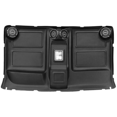

I have a Highliner headliner with 4 Kicker DS400s in it, and a Lanzar powered subwoofer between the seats.  See adjacent thread.
I like this setup a lot, and it was pretty easy, with no mods to the interior of the truck.

Rich,
Did you modify the high liner for the 4 kickers or is that what it cam with?
     They came like that, see highliner headliner webpage here.

Rich,
Did you modify the high liner for the 4 kickers or is that what it came with?
Neither.  It came with crappy speakers, which mounted from behind.  I removed them with extreme prejudice, cutting the baskets up with tin snips and pulling the pieces though the holes.  I then mounted Kicker DS-400s from the front using U-type speed nuts.  No modifications required.
