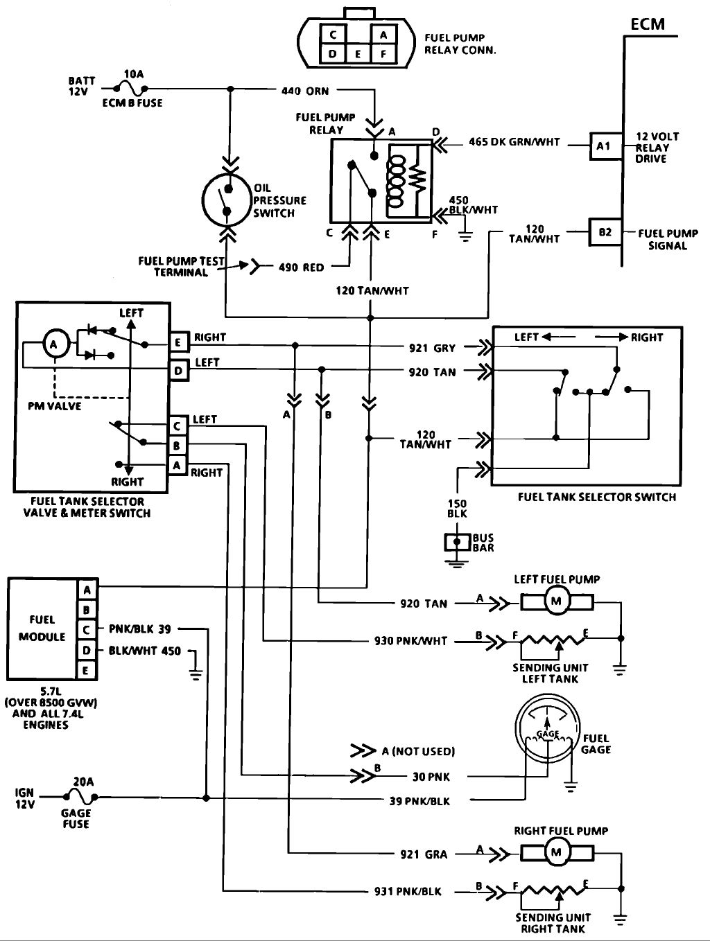

I'm doing an LS swap on my truck with carburetor. I'm using the factory dual tank setup with the selector switch and fuel pump relay as original. But I'm bypassing the solenoid valve for the fuel selection Only , it's still being used for the fuel gauge readings. Here's my issue, and I'll include a picture. On my bulkhead connector there's a terminal that comes out with two tan wires. One goes to the fuel take selector switch on the dash and the other wire goes straight to the left fuel pump. This terminal activates with key on. Therefore, energizing the left fuel pump and eliminating the ability to use the tank selector switch on the dash. Question is, should there be two wires coming out of this terminal? Because I can't find any wiring diagrams that show two wires coming out. My other concern is perhaps this feeds to the hot fuel moduleal and it is defective, therefore allowing voltage to pass through the module and straight to the left tank. Been chasing this for a few days so any help is very appreciated

Those appear to be tan/white wires coming out of that terminal and it should not an issue since the are connected/spliced anyway.  What are the numbers on that terminal for Brown, Dk Grn, tan/white, X, pink, yellow and lt grn?
120 tan/wht = fuel pump relay
both in-tank pumps and the fuel selector valve
920 tan = left tank pump & selector valve,
921 gray = right tank pump & selector valve
150 blk = ground
The dash gauge switches between tanks by the selector valve.
30 pink = gauge
930 pink/white = left tank sender
931 pink/black = right tank sender

Yes. The in tank fuel pump comes on with key on, regardless of tank selector switch on the dash. The right tank operates as it should. Switch to right tank and the pump comes on. Switch to the left tank it goes off but the left stays on continually. There is key on power from those two tan wires. One goes to the dash selector switch and the other to the left pump. That's where I'm confused. Should there be two team wires coming out of that one bulkhead terminal?
Re: 87 R10 dual tank pump issue and hot fuel module
« Reply #6 on: June 17, 2026, 09:59:54 am »
The tan/white wire would just be the wire which sends power to the left or right tank based on the switch position.
The gray and tan wire from the switch determine which side pump to excite along with controlling the switching valve.
From the fatory the intank pump(s) should come on when the relay is triggered for about 5secs (estimate) base on the ECM trigger.
Do you still have the relay in use?
If you are using a carb, what are you triggering the relay with (if in use)?
It sounds like you have this wired incorrectly as the tan/white is just a trigger wire from the relay and the switch determines where to send the power= left or right tank.

Thanks Chris. Since the relay uses that short pulse from the ECM to prime and a signal through the oil pressure sending unit, I provided 12v to those inputs since I don't have the ECM to do that. My guess is that's where the problem lies. Would you agree? Since I can't just add a 5 second prime signal, it's 12v continously. Just not sure how to wire the relay. Should I just get a different relay that doesn't need those extra inputs to pass 12v?

The Oil pressure sending unit is a backup system to the Fuel pump relay.  Fuel Pump Power through this switch is also cut if the engine stops running as the oil pressure will drop.
This is a good post by Hatzie on the operation of the 87-91 pump dual tank setup: http://forum.73-87chevytrucks.com/smforum/index.php?topic=37007.msg310663#msg310663
So are you sending switched voltage to the tan/white wire, which is turning the pump on in Start and Run?  AND the Oil Pressure Switch?  (note this will keep a pump running all the time)
If wired correctly the switch should divert the power from left to right. (see link above)
Technically you could run switched power down the "test" lead also and achieve the same, but I would use it to Test the pump with isolated power.
Have you checked the wiring after the switch to see if you are getting alternating power Left or Right when the switch is changed?
