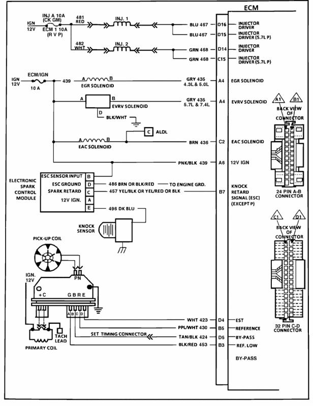

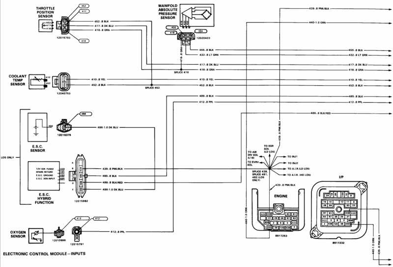

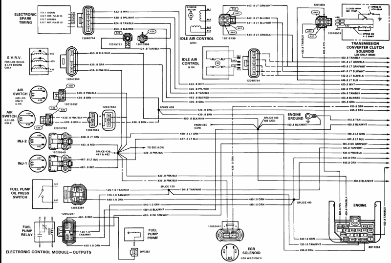

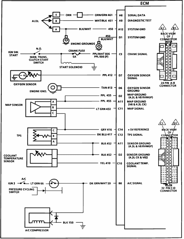

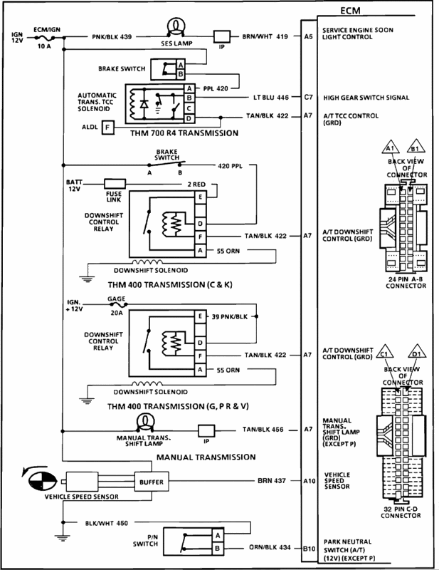

Do you have or know where I can get a diagram?

You have an extra harness,shouldn't have any cutting involved
use wires from the other harness,those blades will come out of the bulkhead connector pretty easy.
Steve
Wiring diagrams at autozone.com and click on repair info, go to your year truck.
