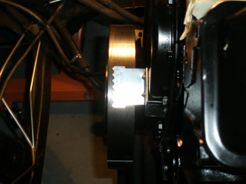

http://i208.photobucket.com/albums/bb247/1985C10/P8180028.jpg

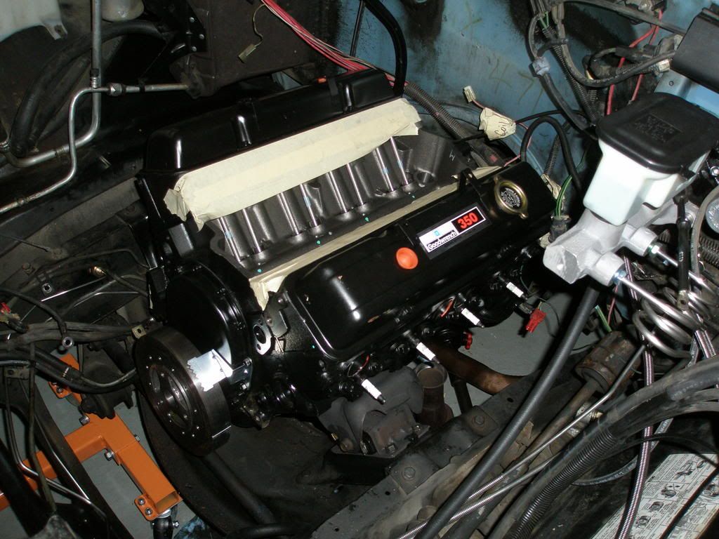

http://i208.photobucket.com/albums/bb247/1985C10/P8040020.jpg
Two questions: does this look fully pressed on?  And is the balancer hub supposed to butt up against the timing gear?  It's a narrow 8" if that helps.
Here's the deal, I installed this thing about three weeks ago, but it has been bothering me.  The reason being, it took two 3 ft. pipes slipped over the handles of the cresent wrenches to drive the thing on with the installer tool (cheapie AutoZone) and I thoroughly checked the crank snout, balancer bore, and woodruff keys for burrs, etc beforehand.  Is this normal?  Oh, and the other reason, the installer broke off in my crank snout just as it reached this point.  (I was able to get the piece out, no damage to the crank threads).

Cant really tell from the pics, but it does look close to what its supposed to. Only way to tell is if your belts don't line up when you have the pulleys on. I know you are not supposed to but I have always taped mine on with a dead blow hammer. Have never had one go hard like you say your did. have never used an installing tool.

I wouldn't put it in the oven! The intereference fit isn't that hard. It honestly should not go on that hard. Take it back off and lightly sand it. Lube the crankshaft snout and use the installer. If it still goes on hard get another balancer.

It appears to be ok to me.  I would verify it by putting the pulleys on.

I bolted up my water pump today to check pulley alignment.  Its nearly perfect, so I am happy.  I should have done this before posting a topic, but my pump wasn't in yet and I was feeling impatient.  Thanks for all the help guys.

It sounds like it went on far enough. I betcha you picked up a burr on the key as you were putting it on and that's why it went on so hard. Not that it matters, but another way to heat up the balancer is to put it in boiling water for a few minutes before installing on the lubed crankshaft. The water won't overheat the elastomer seal. have fun with your new engine!
