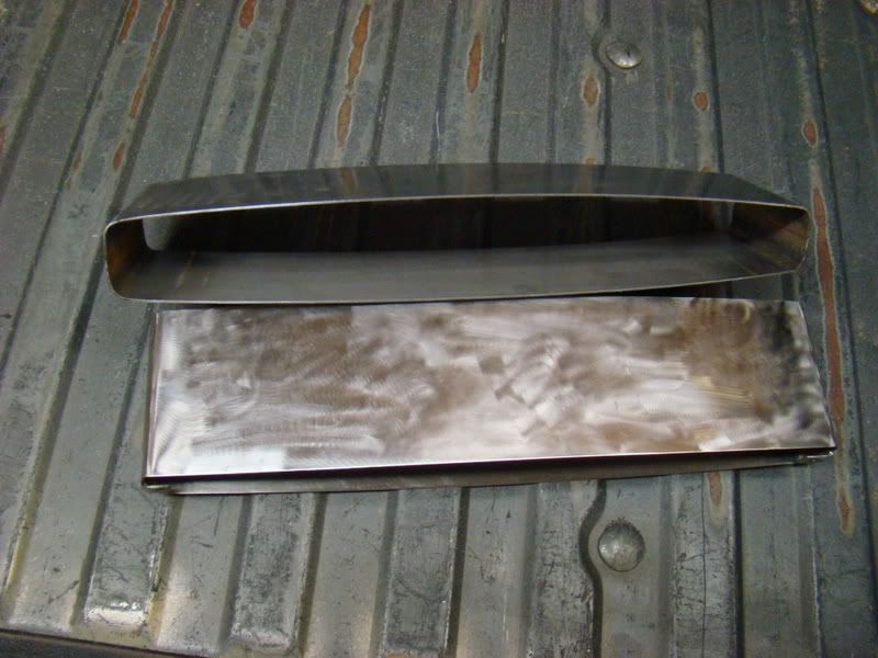

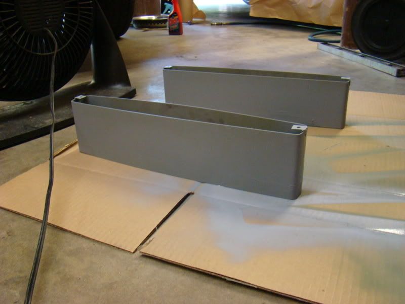

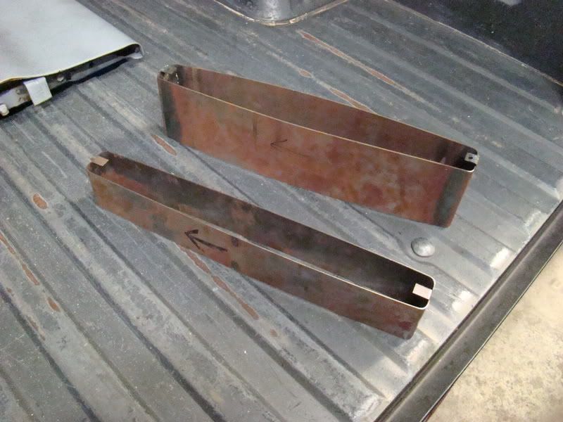

had to make my own buckets, the FBI ones were too shallow and wouldnt allow for flush mount because of my body lines. very very difficult i recommend just dropping the $60 and buy em, unless of course you have to make different ones like i did.

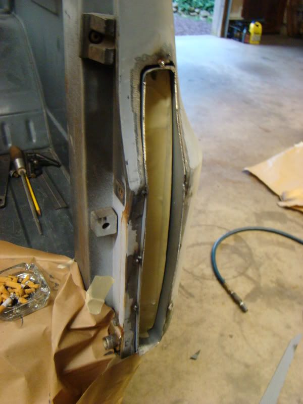

self-etch, primer sealer, and weld-thru
