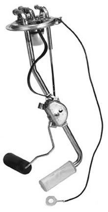

Here is a picture of the drivers side fuel sending unit:
When I reversed the sending unit - the float should be facing the rear of the tank. Therefore, the float should not be hitting anything. I need to start diagnosing with my multimeter to figure this out. I am going to check the ohm output of the sending unit at the unit itself. Then check again to see if I have good ground.
I want to make sure the Dakota Digital guage is reading properly. Hopefully, I wont have to drop the tank.
