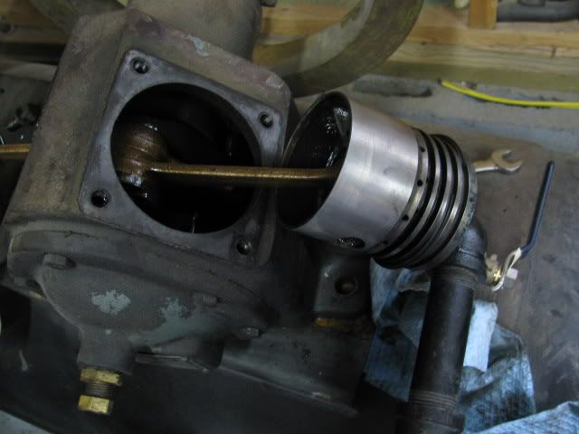

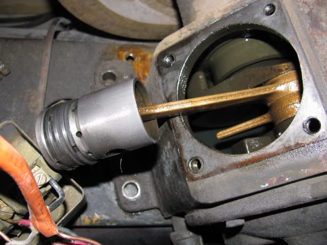

Jim- That's a great running compressor in your video. Good looking garage too. Did you get your IR parts online or did you deal with IR directly? I was only finding parts for newer compressors when I looked at their site. I gotta look into this some more.

I found an aftermarket company out of N.C. I'll have to find who it was , but the kit have everything even new rods which even after all this time Mine didn't need but I kept em as spares.
