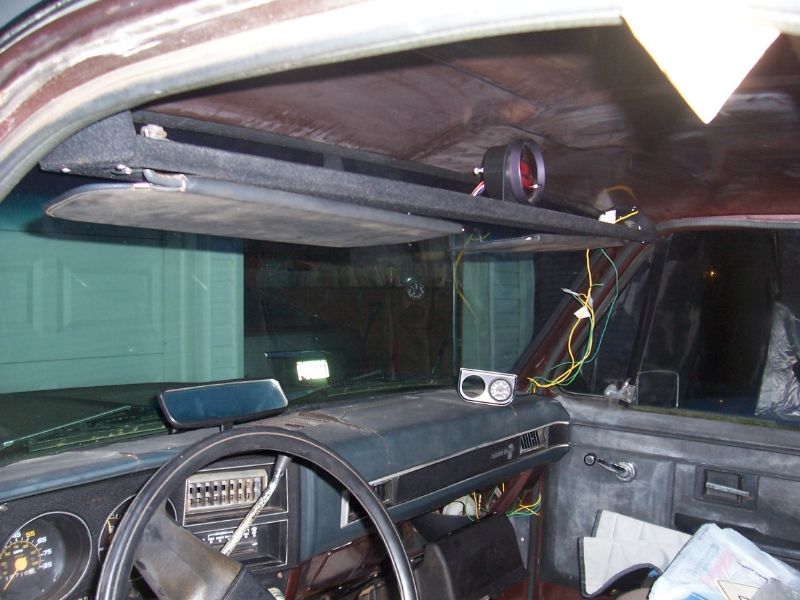

The first thing is that i had to slightly bend the brackets with a crescent wrench to line up with the holes in the self.  This MIGHT be due to the fact that the shelf shows signs of being previously installed.  Some of the surface area appears that bolts were already installed---the shelf has a sort of sprayed on felt/velvet surface and one of the screw holes appears that a bolt was installed.  i CANNOT absolutely confirm that the shelf was previously installed---it may have been a test at the factory.
After the shelf was installed in place it appears to be sturdy and able to carry a lot of junk up there.   The shelf is a decent gauge thickness to give enough strength yet still remain light.

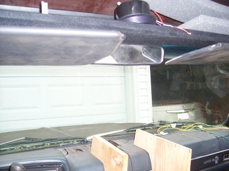

1) Now, the first problem is that the stock visors do not work with the stock review mirror.  i accidentally broke mine off the adhesive mount when adjusting it to try to work with the visors and will have to re-attach, but trust me----they won't work together;  With the shelf you now have to fold them forward instead of backwards.  And the visors now contact the windshield.
a) You could angle the visors a little back, but then it blocks the view of the mirror a little.
b)  You could fold them backwards, but now they are too close to your head and affect the view.
c) You could try visors from a smaller gm vehicle.   i don't want to do that.  Also, even though i don't hardly use the visors i don't like the idea of leaving them off.
d) Even IF the visors work with the rearview mirror OR you want to leave the rearview mirror off, the visors are now lower and kind of affect the view.  Also, as you can see the visors don't have the snap-in clip things so that kind of sag a little which further adds to the problem.

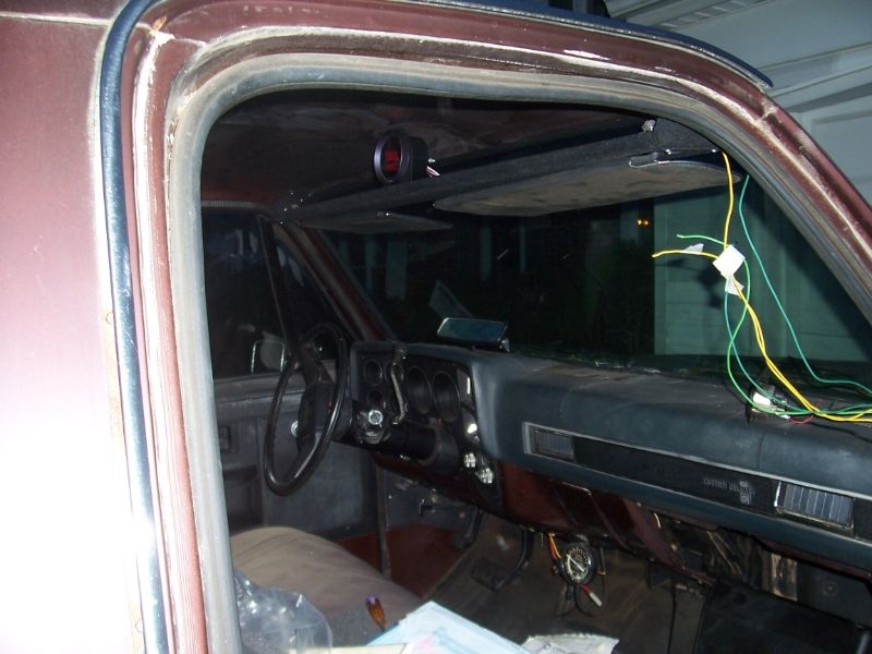

2) If you are a taller person---say over 5'10" you might very probably have visibility issues as the shelf, even without the visors, really lowers the roof-line and makes it seem like you are driving a car---which in itself is not a bad thing, but if you are taller it's probably a problem.   i think the first 2 pictures really illustrate this.

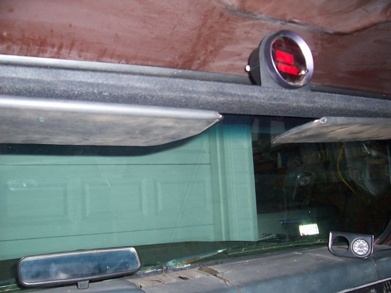

This sun visors will work with the rearview mirror BUT they have to be angled back slightly and the view of the rearview mirror is partially blocked:
If anyone needs any measurments, let me know.  i'll be taking it down soon.

i actually did drive around with it a few days ago and the only real problem was/is that the rearview mirror is partially blocked so it generally can't work in present configuration.  Maybe with some adjustments it could.  The shelf and visors did not actually block my view of any signal lights.   If you leave the visors off it might work out good for you.  i might actually leave it up for a while despite the fact that i am using a custom gauge console---the last picture shows it in an uncomplete stage.
