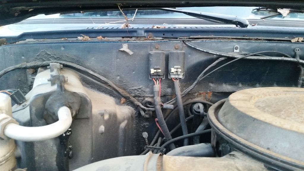

OK... This is what I have. I see a red wire that's hanging out on the one on the left. So the one on the left is for testing power to the fuel pump, what is the box on the right for? Just curious.
Offline hatzie
  • Posts: 771
Re: 1987 Chevy Truck Issues (TBI)
« Reply #16 on: March 13, 2016, 10:08:26 pm »
One is the FPR the other is the fuel module for vaporlock that I mentioned in my last post.
If you feed 12v to the red wire the selected fuel pump should run.  This assumes the tank switch on the dash is ok.

on my 91 v3500 i have the one on the left(with the red wire) and nothing on the right. theres a spot for it just nothing there.
