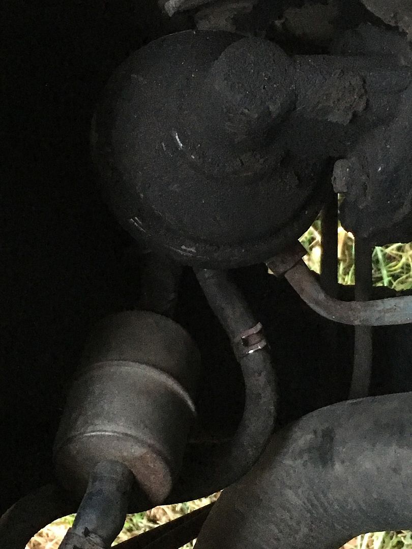

Okay I'm just confused, when I just crank the engine there's no fuel running to the carb. When I pour gas in the carb and get it running then it starts to pump gas but not much. So the first assumption would be the fuel filter, do both gas tanks run through the same fuel filter (mounted just in front of the fuel pump)? And why when I took the fuel filter off did no gas come leaking out the fuel filter and lines feel bone dry) Sorry if I sound like an idiot because I am lol. I can't figure it out. Another thing, it's a Mechanical fuel pump the runs off the crank, there are three hoses one has a fuel filter going into the pump and one goes up to the carb, I can't figure out what the third hose is.

No fuel comes from any lines unless I pour gas straight in the carb and get it running, then a small amount squirts from the carb inlet hose, as far as I know just turning the engine over should be pumping fuel to the carb and it's not.Yes there is two fuel filters, a small one right in the carb and then another one right before the fuel pump as seen here on the left. The Hose on the left is the fuel in hose the one on the right in out to the carb, the middle I have no clue what it is. I just replaced the fuel filter haven't checked if that fixed yet, have to wait til tommorow.

Yep. If you have dual tanks and from your photo, the fuel is pulled from whichever tank is selected, runs through the tank line to the tank switch solenoid/valve, then filter, then fuel pump and possibly a second filter at the carburetor.
Quote
From the photo and your descriptions, I'd suspect the filter before the fuel pump and the fuel pump are both culprits.  The fuel pump has a "rubber" diaphragm inside that will weaken over time and eventually break. Not knowing the truck and engine condition -  if the fuel filter(s) and fuel pump are over three years old, then I'd consider replacing them.

Thanks for al the awesome information I truly appreciate it. The fuel pump and filter are pretty old because this truck sat unused for a long time and is just now getting back into being used. I've replaced the fuel filter if that doesn't do it then I'll be moving onto the pump next! Glad these old trucks are pretty Simple.

She's fixed!! It ended up being the 5 buck fuel filter that was keeping it from running! Thanks for the help! Now on to the next problem lol
