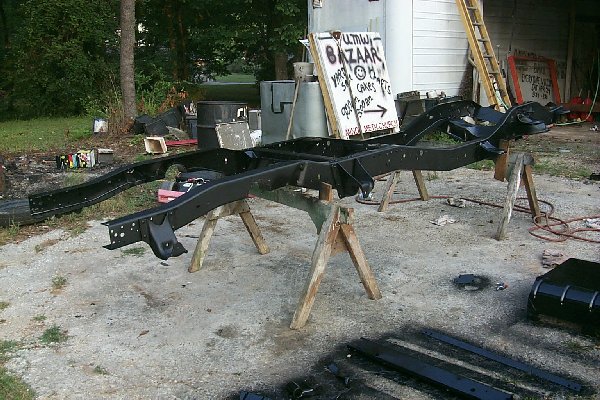

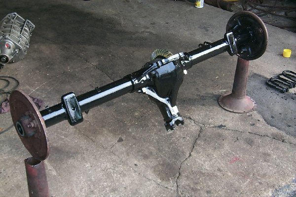

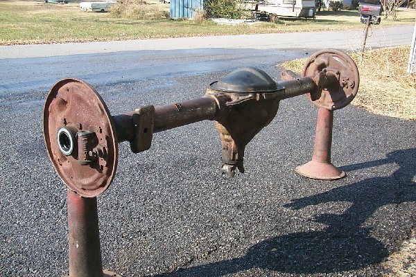

I just read the article. POR15 doesn't need to be reduced, it will spray through a gun just fine, reducing it in my opinion is a bad idea. I painted the whole frame and all components with POR15 and it laid down fine and I am not a professional painter. I have a skid plate that I painted back in 2000 that has been sitting in the dirt in my shop, it still isn't rusty. As for sanding it, I couldn't scratch the pieces I painted with POR15 with a awl. I had to jam a chisel in it to make a scratch. As for cleaning, I clean everything with EZ-Off and wash it down with water and blow it off with air and let it dry. Then I shoot POR15 directly on it. I can say that it DEFINITELY is UV sensative, but I top coated ( within 2 hours while it was tacky) with enamel. I used nothing special to clean the metal other than the above.
This is my frame with just POR15 on it:

This is my rearend right after I washed it down to let it dry:
This is about an hour later when I painted it with Gloss POR15:

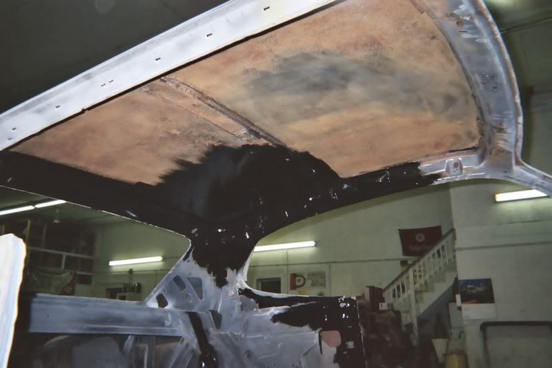

I have done it both ways. Sand blast works good as does POR 15 or Chassis Saver which is what I use. Its the same exact chemical make up as POR but about half the $. I have srayed it unreduced but works beter out of an HVLP gun with about 10% of the recomended reducer. POR and Chassis Saver will both work on sandblasted metal too. When I did my 55 I brushed Cassis Saver over the sanded surface rust on the roof. Can't sand blast sheet metal it will warp. Then I primed over it as I primed the whole car with high build urethane prime You would never know it was there.
Here is a picture of my buddies Duster, I used POR on the inside of the roof, then sprayed over it with acrylic enamel.

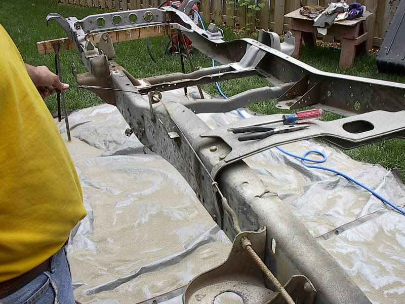

If removal of rust is an option, I would do it. My whole frame was sandblasted:
My rearend was not as I didn't see a point in it.
