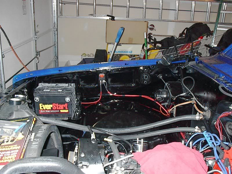

Ok here it is wired in:

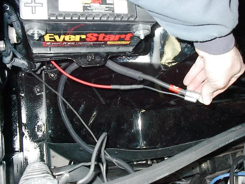

The new positive battery cable came with a fusible link already preinstalled to protect the B+ battery wire to the maxi fuse:
Everything will be put in split loom as soon as it arrives - I ordered it in bulk.
Everything should be ready to go - I bumped the motor tonight with the key and verything worked.  Can't wait for this weekend.

« Reply #14 on: March 10, 2008, 08:15:16 pm »
Awesome! Looks tight and clean!
