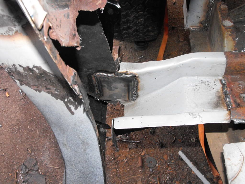

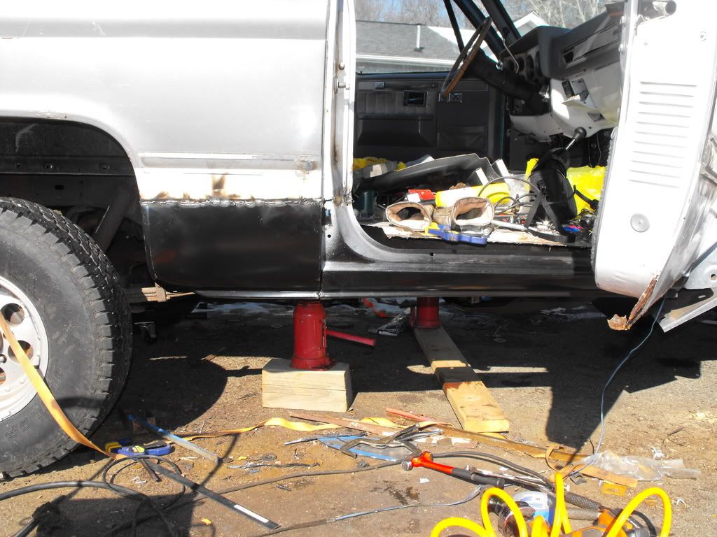

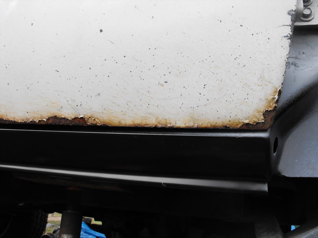

There must be a Rocker Fairy. Went to work on the rust bucket today and when I went to line up the rear quarter I noticed the Rocker was almost perfect. Went and looked at the pics I took and yes the fit is alot better
Today
when I welded it
not sure if when it cooled it moved or what but I am happy.

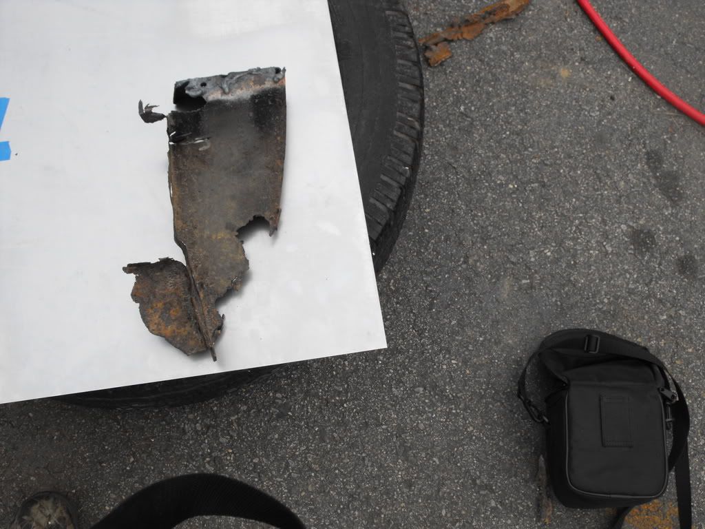

Had to make a inner piece for the rocker and rear quarter to attach too I think it came out good
Old piece
After making a template out of construction paper this is what I ended up with I think it was pretty close
Here is a test fit of it in the rear quarter panel piece
Here it is mounted in the truck I used some 2 inch by 1/8 thick angle iron think that will be a little stronger
for the inside just used a piece of 16 ga steel
After (it seemed like hours :) ) of cutting then grinding to get the rear quarter patch to fit close (had to trim the end of the rocker)
Here it is tacked in, I flanged the upper part that remained so the bondo or whatever I use will fill in my imperfections..
I think its ready for bondo the sun started to set so I had to call it a day

Yes, You seem to be on a better plan. One thing that concerns me is in the picture where you have the door closed & the quarter patch installed...the gap in the Gray area looks good & then gets tight, then ok at the bottom tip. Has the door been poorly patched before? Your seam area on the quarter looks straight. As I mentioned before, I would not consider welding anything in without the door I was going to use (there are too many variables). At least when you paint the truck your panels will be the best you could make them...if a few years later, you need to replace a door, you may have a little bit of trouble (which is why I suggested a slightly bigger gap than you had originally, especially on the bottom), but why go through that compromise before you ever drive the truck?

Looks pretty good. Just remember when you prep for body filler you need to grind it ( with 24 grit ) Up about18 plus inches from your weld to blend it in good. Di you over lap it? If so a few inches below the weld should be good. I you but welded it I would grind it down a ways too.
