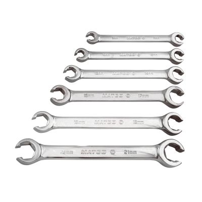

Oh and yes the front hoses are a bit of a pain to put in, because the nut on the inside of the frame is difficult to get to. Everything else about it is cake. Use plenty of pentrating lube (like PB blaster) where the flare nuts meet the flex lines, let it work for a while before starting, and use only
flare nut wrenches
, or you'll strip them out easy.

Yes, you can just replace the hoses and you can get them at any auto store. On my truck, with air pump, power steering pump, etc., I had to go at it from underneath.
If you don't have a 3/8" flare nut wrench, buy one before you start or you will round off the nut trying to unscrew the hard line from the hose. It's just really hard to get the wrench on and to move it very far, as it is in the channel of the chassis. Good luck.

DITTO, get a flare nut wrench. The one on the inside of the frame I would dose it down with some penetrating oil

ok so I should grab a 3/8 flare end wrench and some pbblaster I have that already. awesome. ok got the other brake parts, and the bearing lube tool, and the grease gun and hoses for that gun. etc. so yeah. Im on the way. thanks, fellahs. Ill tell you what I do next for this part.
