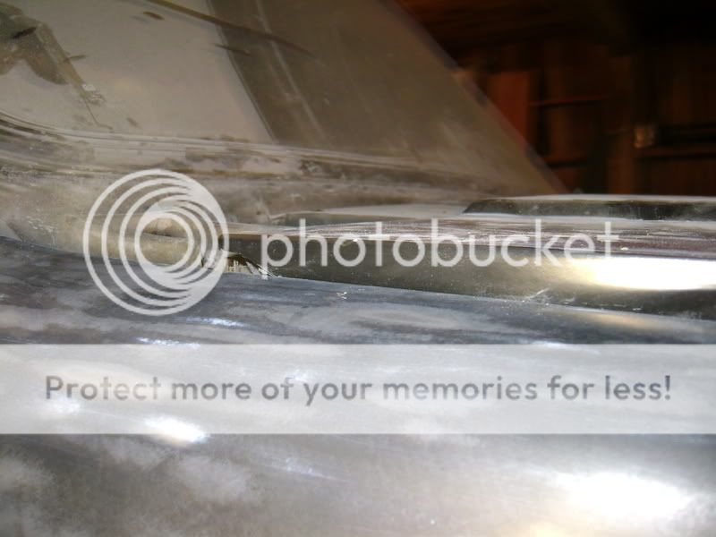

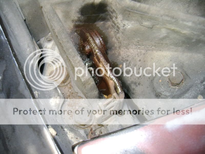

all bolts are tight and the hood isnt bent or the inner structure isnt comming apart. here are some pics hope this works

o and the one pic is of how much the hood sticks up when closed and the other is when hood closed a pic of the hinge. hinge is as strait as an arrow

You need to take some better pics. Too hard to see what's going on.

I would like to see that corner from the outside (where you took the other pic's) with the hood open & one from the underside. Does your door match going up the windshield post & at the roof with a proper gap? How about the fender to the door? If you put the cowl panel in (install the screw loosely) does it push down to be flush with the fender? How about pulling it up to match the hood?
 The jamb area looks real smooth (that's what made me think it was 'glass) can you see wrinkles in the metal & a couple spotwelds in the area you posted? Maybe it's been bent & smoothed up with filler? What happens if you remove the spring support & close it? Lorne
