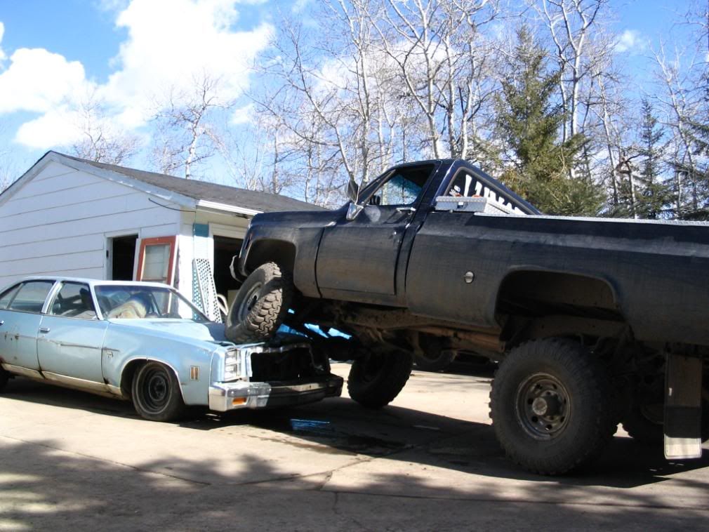

« Reply #52 on: October 08, 2009, 11:59:35 am »
Shame on you for crushing that malibu;  It looked like it had many more miles in it.
i mean seriously.
