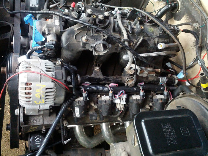

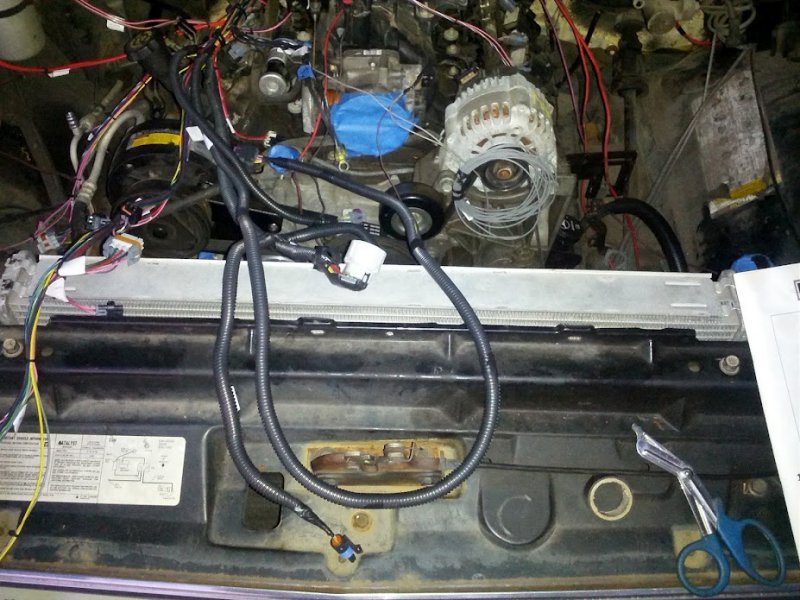

Tuesday, August 21st, 2012: Started putting all of the wiring in looms and ran out of 3/8" well before I got done.
Sunday, Sept 2nd, 2012:No new pics, just got more loom and still wrapping wiring.
Re: 1987 R10 Driver
« Reply #94 on: September 13, 2012, 05:06:39 pm »

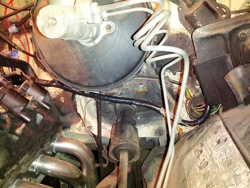

Sunday, September 9th, 2012:Finished up the main ECM wiring Loom.  What is left is the Alternator, Starter, Fuel, Grounds and Power tie-ins.  The Power wires need new terminals added so they can connect to the factory distribution block.  I couldn't find the starter and MAF so I need to get them.

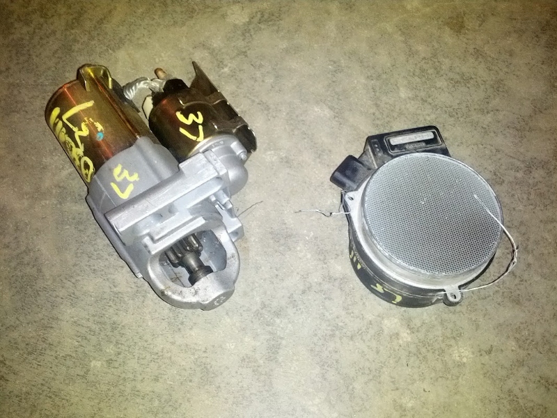

Wednesday, September 11th, 2012: Got a Starter and MAF dropped off so I can finish up the wiring section.

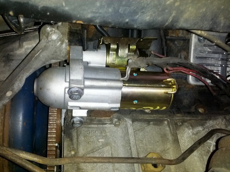

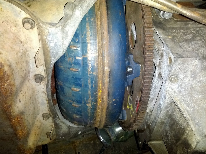

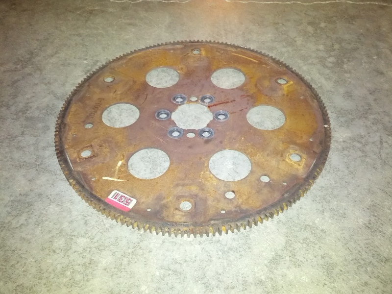

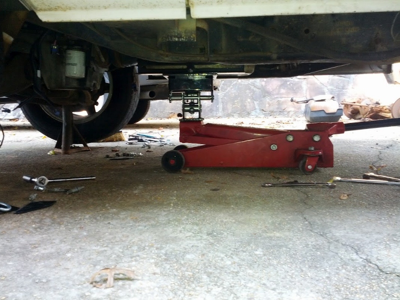

Saturday, September 22nd, 2012: After getting the starter I moved on to the Torque converter and found an issue.  I wasn't able to fix it immediately so fast forward and I ended up having to drop the trans and replace the flywheel that was bent in the center.  There way no way to bolt the torque converter up.
Re: 1987 R10 Driver
« Reply #97 on: September 28, 2012, 01:59:59 pm »

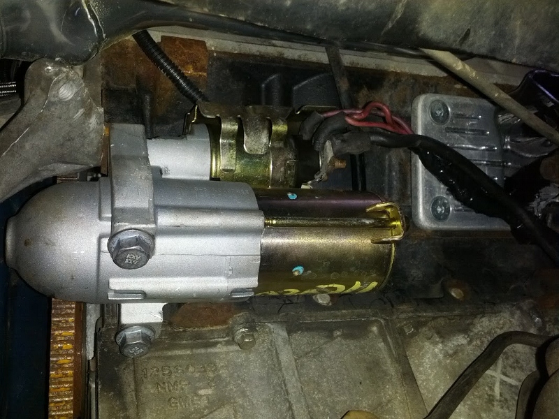

Sunday, September 23rd, 2012: With the trans out of the way I moved on to the wiring.  Got the grounds (can see them) connected and put new ends on the power terminals to connect it to the factory junction.  I also routed the starter wiring down to the starter along with the power cable to make sure I have enough room and then started looming the starter wiring.

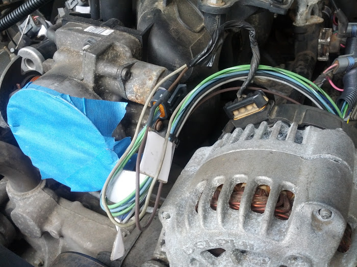

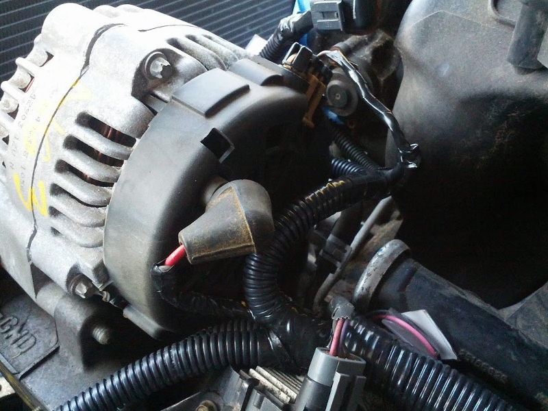

Wednesday, October 10th, 2012: Got the starter and alternator wiring loomed with the rest of the wiring.  Spliced in the Painless wiring with the Alternator plug and swapped the ECM from Red 15 to Red 52.  ( This is NOT correct, I ended up putting this back in slot 15 to get it to charge..) I also removed the L terminal wire from the alternator plug.

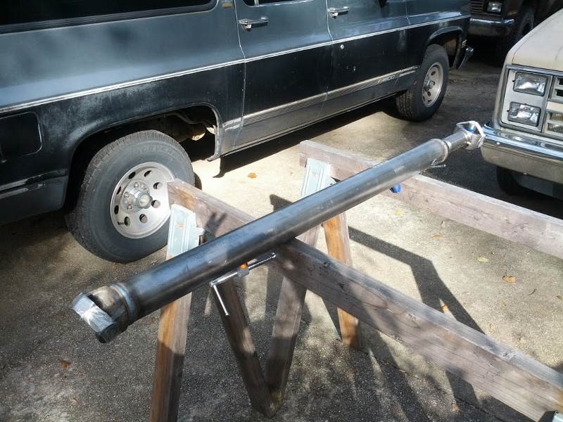

Wednesday, October 17th, 2012: Dropped the dimensions off for my new driveshaft to be made.

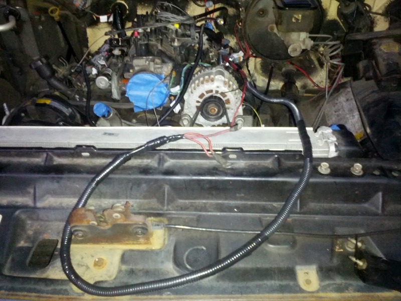

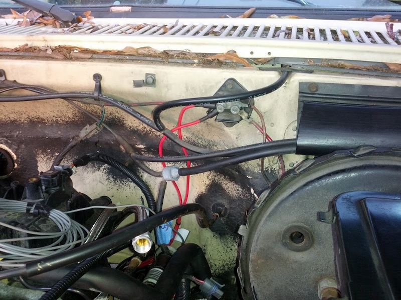

Thursday, October 18th, 2012: Finished connecting the fuel pump lead to the existing harness with the OEM connectors, and loomed the wires up.
Got the wiring routed down to the starter and hooked the starter up
Finished wiring up the alternator to the Painless and Pickup harness

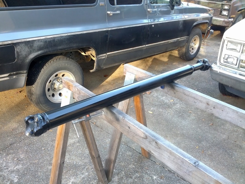

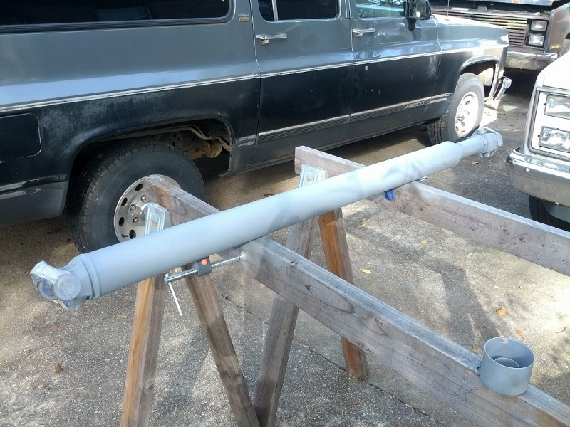

Friday, October 19th, 2012: Picked up my new driveshaft in raw steel
Cleaned it off and scuffed it and put some primer on it:
Started with the first coat of Black paint and finished it up later that evening.  (still need to install it)

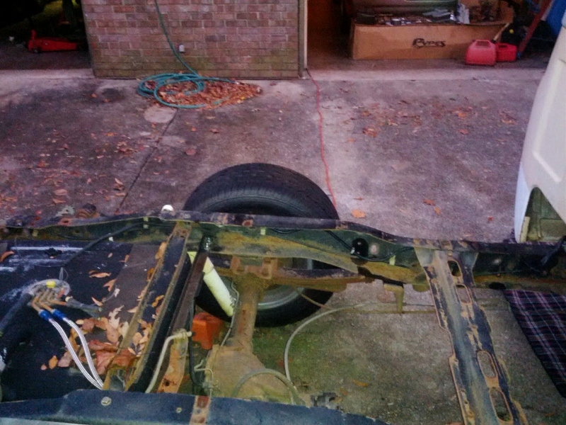

Sunday, October 21st, 2012: Made a connector harness to extend the gas tank/pump wiring back to the Blazer tank, and got it loomed.  Added a ring terminal to the ground wire.  At this point in time I am done with the wiring except for the radio...
