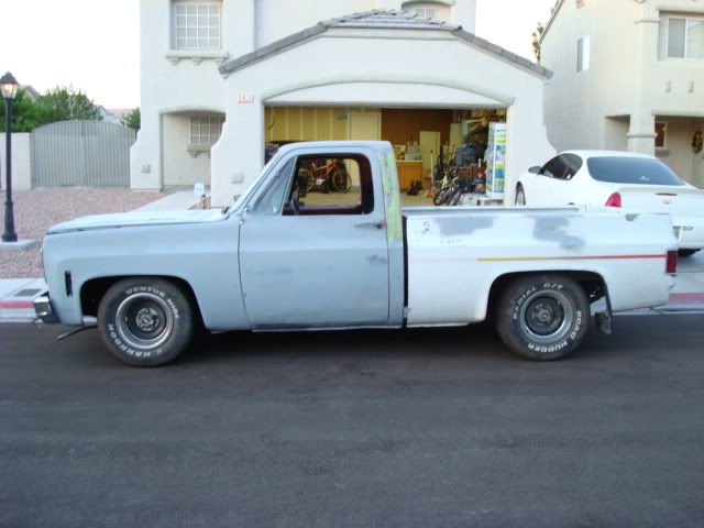

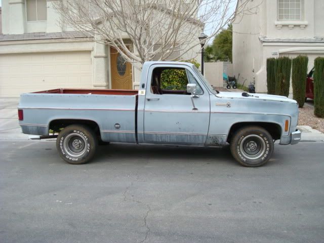

i myself used 3" lowers and uppers to compliment and 2.5 springs,allthough not tucked im at the top of the tire and looks opretty good
before
after
