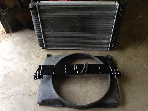

After consideration, the best plan for my truck is a factory cooling system. For reliability, cost, and simplicity. The following is a picture of a Delphi replacement radiator for the 73~87(91) that replaces the factory 4 core. A guy I know bought it, and used it for about a year. I gave $75 for it. I thought it was worth that. I need to clean it out. It appears it had only rusty water ran through it. (ick)
It had quite a few bruises in the fins where the po didn't take care to install it gently. As you can see, I was able to straighten all of the fins. One benefit to this radiator is that aluminum throws off heat better than brass. The other huge benefit to using this radiator is that it only weighs about 1/3 the weight of my previous brass 4 core. This radiator is a Delphi unit, but the tank is clearly marked "GM Harrison".
In a previous post I showed a picture of the 454 serpentine belt system I am going to use. One thing I didn't get was a fan. The fan I wanted to use was in my wife's 2001 Silverado 2500HD with the 6.0L engine. A modern looking, 9 blade plastic jobby that will be compatible with the reverse rotation water pump. The fan that should have came with my 454 serpentine belt assembly was an old, ugly, steel, 5 blade, antique type design. Problem is... the 9 blade 6.0L fan clutch uses one big giant nut that screws onto a stud on the water pump hub. I could use a Vortec 7400 water pump but then I would need to find a pulley as well.....and I already have the 1990 model 4 bolt hub water pump.
I can't help but thinking that the more modern broad paddle 9 blade fan from the 6.0L application will draw more air than the OE steel 1990 model year 5 blade curmudgeon.
I just love how Chevrolet made everything interchangeable. I went ahead and bought the fan. $29.79 my cost, new GM. It seems the fan clutch for the older 4 bolt hub water pumps have the same bolt pattern, and hub register diameter where the fan bolts to it. Actually, the fan clutch in this picture looks in every way identical to the one in my wife's 2500HD with the exception being how it attaches to the water pump hub.
The fan clutch that I selected was the most heavy duty in the listings by spec. This one is an OE unit off of a wrecked 1993 Chevy K2500 C6P (heavy duty) with a 4.10 gear. The book shows a more aggressive clutch for the lower axle ratios, so that is what I went with. Additionally I aquired the water pump pulley from the same truck since it had an over drive transmission. The newer pulley is a smaller diameter than the one I was going to use. My original water pump pulley was from a 1990 454 truck that didn't have an over drive transmission. GM engineers decided the water pump needed to spin faster with the OD transmissions to help circulate the water adequately while cruising in OD, and because of this, the newer pulley is a smaller diameter. In the GM books, the 1991.5+ 5.7L, and 7.4L engine show to use the same part number water pump pulley.
My theory is that the faster water pump speed will help keep my engine cool while idling at lower engine RPMs which is where I figure this truck will be most of the time it is in operation. I see very little high RPM hot rodding in this truck's future, and when it does, a 160F thermostat will keep the coolant from circulating too fast.
I also cleaned up my factory 454 fan shroud. This should work perfectly with the long water pump, and 19" diameter 6.0L factory fan. Again, looking to keep the factory reliability. In the above picture you are able to see my new GM radiator top plate with the new GM mounting isolators. I also am looking to collect the factory 1988+ spring steel radiator hose clamps. After using these, and having used the old stainless worm gear clamps. I am a firm believer in the newer constant torque spring steel units.
Did I mention how much I love Chevrolet for its ease of compatibility across many different models, years, and options?
Did I mention how much I love Chevrolet?
