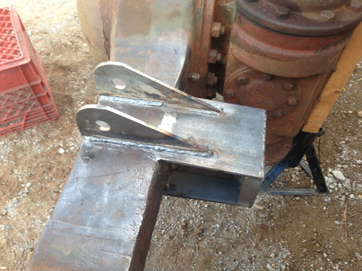

Here Is the latest update.
Weather was awesome today. Got some quality time on the '77 after church.
In the photo above (in my last post) with all of the plates in it I was able to get the work done on the plate with the smaller holes. I took them to a freind's shop to use his drill press. I don't trust mine to make the quality of hole needed for that part of the fab. I used his drill press to drill the pilot holes to 11/16". After getting them back to my shop I proceeded to tap the holes to 3/4-16. Ugh. My tap is really dull. Time for a new one.
After this was completed I then welded the 2.5" square tube to the bottom of the plates as seen in this view:
Next step was to weld them to the axle. For those who were unsure of how I was going to do this part I took the time to photograph each stage of the build. I'm sure I more than freaked out a few people by saying I was going to use blocks for lift because in the 4x4 world front blocks are a definate no-no, and rear blocks are to be avoided if possible, but I think everyone can agree that this set up is good to go. (the 2x4 that is bolted to the top of the differential is to keep the axle upright. Those 5-tons are VERY top heavy, and if it turns turtle on you it is a real pain to flip it back upright)
Solidly welding it to the axle housing:
And now the important part, boxing it all in:
Still need to finish by boxing the sides in.
Adding the torque rod mounts:
This view is of the Reyco Suspension (OTR truck torque rod part) bushing that will be pressed into the lower end of the torque rod.
This view shows the 3/4" bolts that will clamp the leaf springs to the axle using the 1" thick plate seen in my last previous post:
I am convinced this is a much better set up than using u-bolts to clamp the axle and spring.
The 4x4 mega truck crowd makes it an emphasis toward keeping things up high for ground clearance. I don't plan on mohawking my pumpkins, or anything radical as that, (really not necessary in my case) but I did keep things neatly tucked away just to keep the build clean:
After I box in the sides I want to set the frame on it so I can get an idea of the height.....that, and to drive myself batty because I am not finishing this thing fast enough....... The more I get done the more I want to see it complete.
And as always feel free to opine, comment, or ask questions.......
That is all I have for now. I'll post up more when I get the axle under the frame.

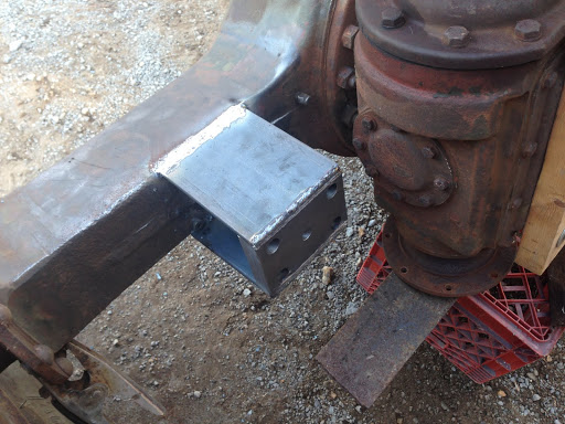

Well I was able to box in the blocks on the rear axle.
The spring will set on top with the head of the tie bolt in the hole drilled in the center of the block.
Just need to dress it all up with my grinder. It was cold outside today and I didn't want to work on it out in the wind. Plus, since my shop is full of trucks I don't want to throw grinder dust all over them and risk having the steel filings rusting, and ruining the paint.
