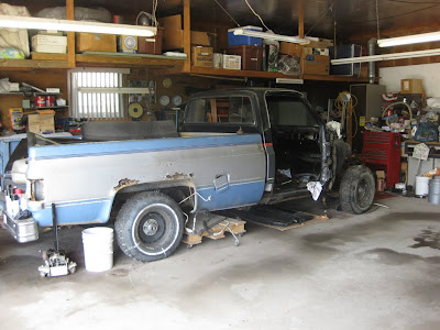

I bought this truck on Oct 25, 2009 off my friend. He had bought the truck to use the bad and cab on his 4x4 plow truck. Then they were gonna scrap the rest of it. The previous owher blew the headgasket in 07, so he replaced them and stupidly reused the old headbolts. Well no surprise, he broke one. He gave up on the truck and sold it to my friend. He put the bed on the plow truck and kinda gave up and decided to sell both. Gave him $400 cash and towed it home. Now onto the progress.

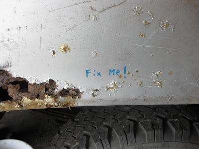

The day I brought it home was the inspection day. Pulled out the trailer brake and wiring (it was a house extension cord). Just looked over the frame and cab. Frame is solid. Cab has no outer corners or rockers. Rusted out and patched by the old owner with duct tape and bondo. (yippee)
The truck is pretty original. In the glovebox was still the original owners manual, dealer panphlet, business card from the salesman at the dealer, original maintenance book, tire warranty book, and some other papers. Other original stuff on the truck is the rally spare wheel with original uniroyal tire. (was used and abused, but its there.) Original jack and jack handles. Some other stuff too.
Now onto the fun part. Next day after I bought it I pulled the heads to get out the broken stud. It was broke off about 1/4 inch above the block. Pair of pliers and 5 seconds it was out, cool. The i looked at the heads and realized they were all crudded up. Oh boy. My buddy Corey then looked over them and knew they needed rebuilt. Then we looked at the motor. Stuck. It sat with no valve covers, pushrods, spark plugs or throttle body on it. Open like this for 2 years, moisture got into the motor. Soaked the pistons in Seafoam Deep Creep (awesome shoot btw), and Corey got under and spun the flywheel after about an hour of soaking and it broke loose.
Now we find the lifters are stuck inside the bores. He got a lifter puller and got about half of them out and broke the tool (they were in there good.) Cleaned up the lifters with some emery cloth and bought 1 new one to replace one that popped open. Oiled them up and they slid right in.

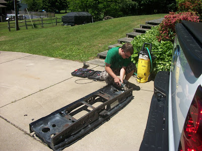

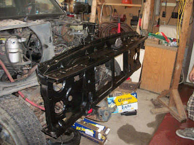

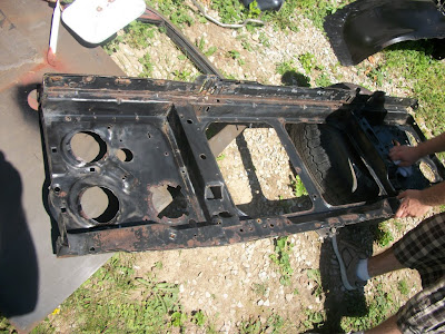

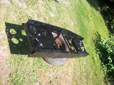

Well I guess since this thread is a little more popular than the other one, ill update here. Last week I got a bed for the truck for $100, but both bedsides are about shot, but the floor is mint. Anyone have any bedsides for sale or a better bed I could toss on. I don't think it would be worth it to try and fix the sides on these, they need new arches, taillight area, and other metal. Also cleaned and painted the core support and inner fenders. Heres some pix, long way to go.
