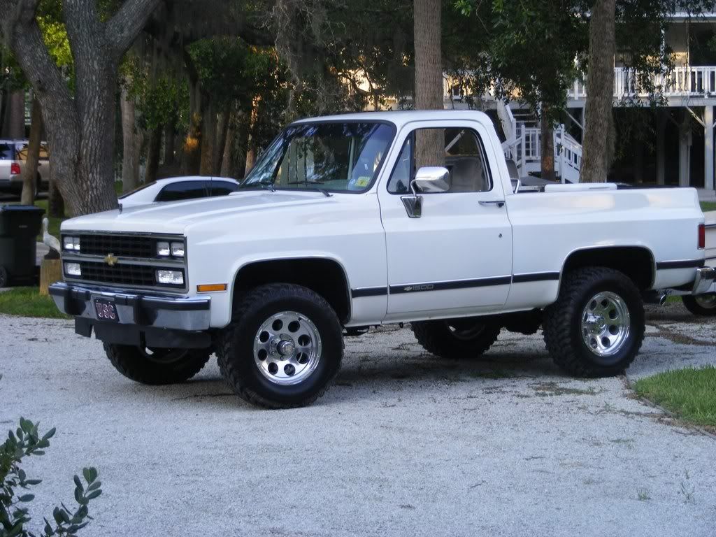

anyone got any picture of a 89-91 model suburban grille in a pickup. the headlight is side by side and are glass head lights with the plastic parking light liens under them. believe it had the plastic chrome grille. I am just tiring to get a picture. I have seen it before but dint remember and i think i want to do it to mine. just wondering what all i would have to change.

Here ya go
I think for the swap you need the core support and headlights, trim, grille, and lower valance plus pigtails for the new lights. The fenders, hood and bumper are the same.

Here's a link to the pic 78 posted
http://67-72chevytrucks.com/vboard/attachment.php?attachmentid=383865&d=1219168950
But those headlights look weird.
and here's a blazer

maybe this one will work
The valance is the skinny panel under the grille behind the bumper. it fills the gap behind the bumper.
