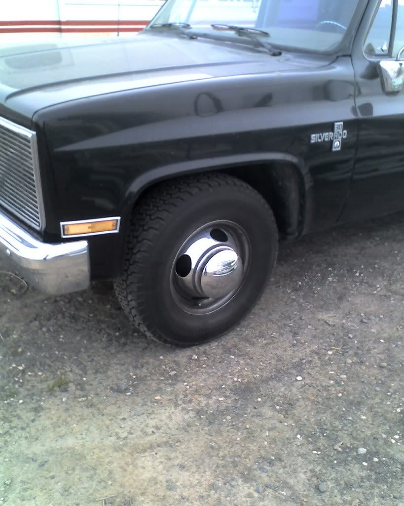

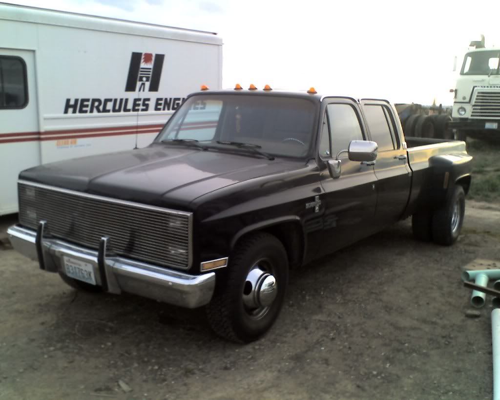

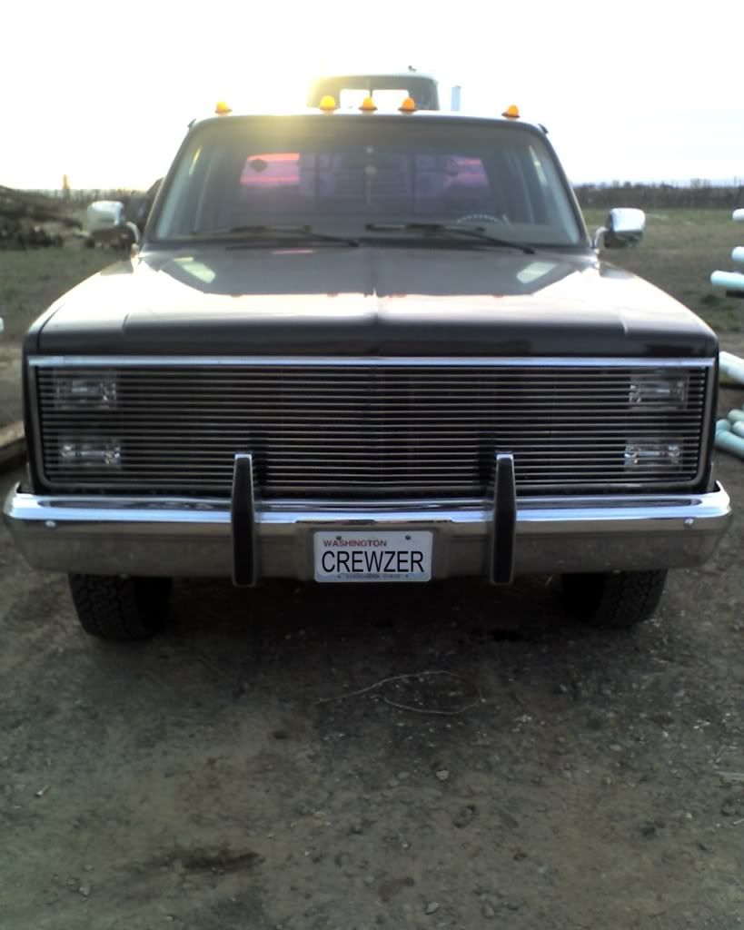

Here are some Pics of my truck:

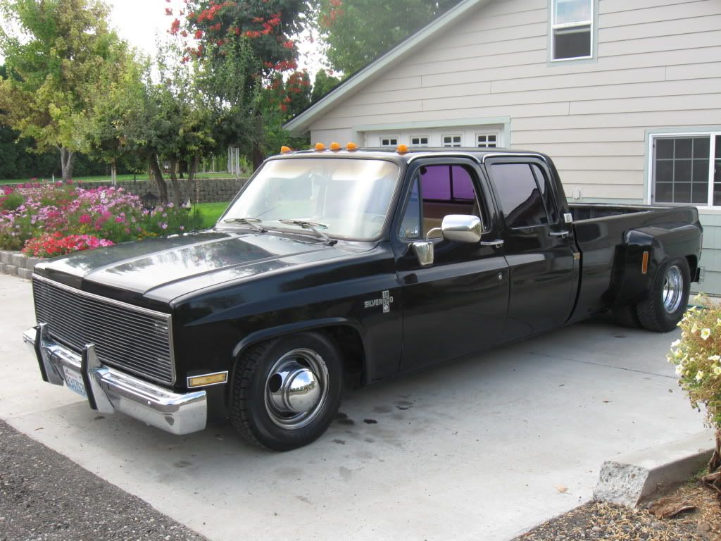

as it is now

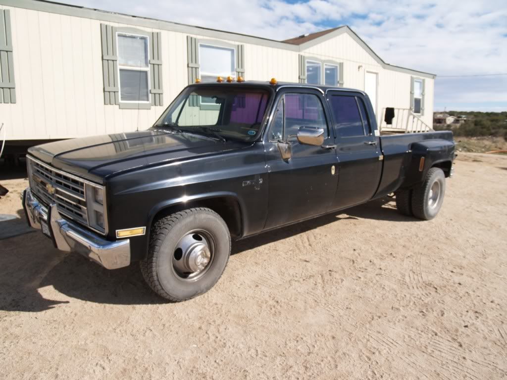

when i bought it

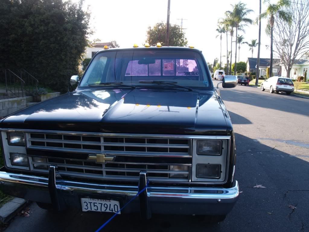

First Modification Phantom Grille

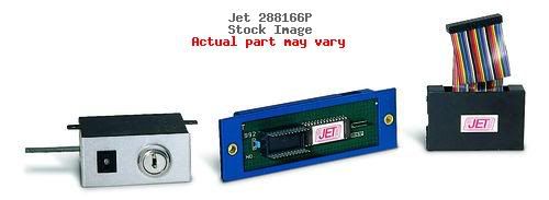

Next a Jet Sixpack Chip

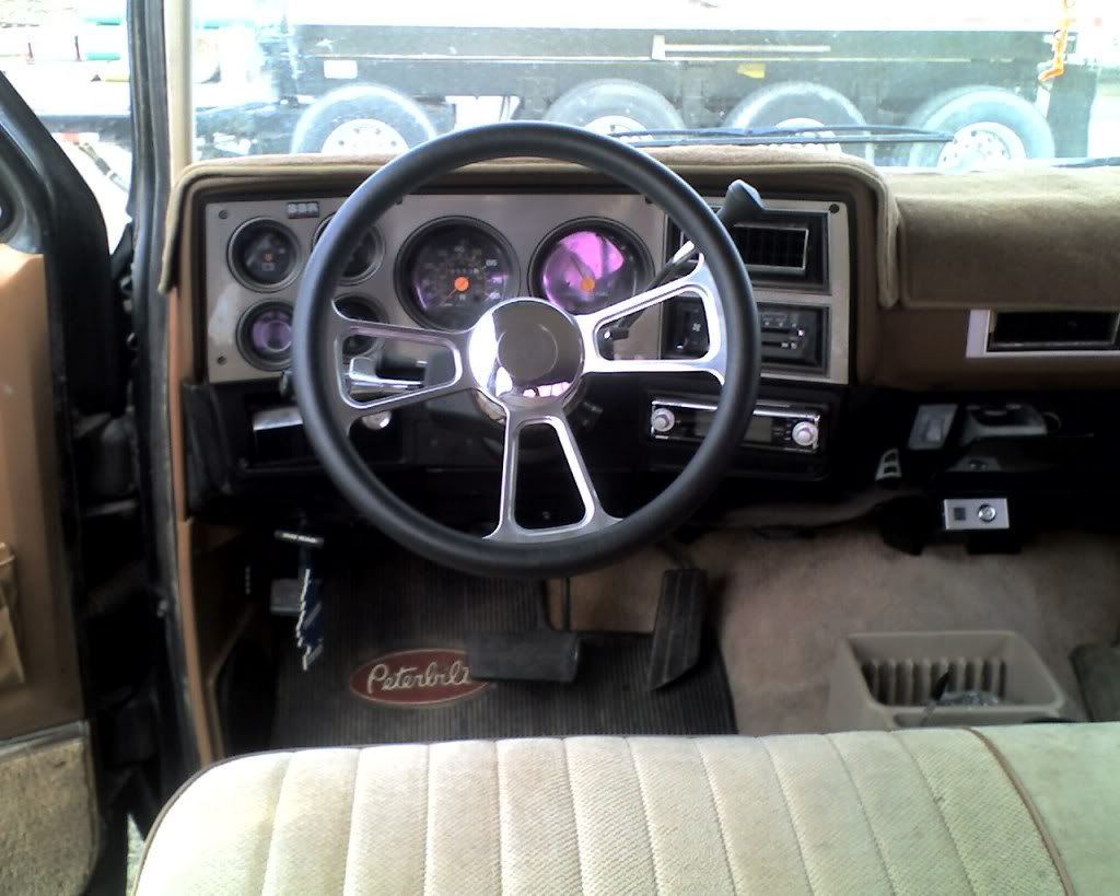

Then a Steering wheel
Some semi hubcaps...man this truck is too tall

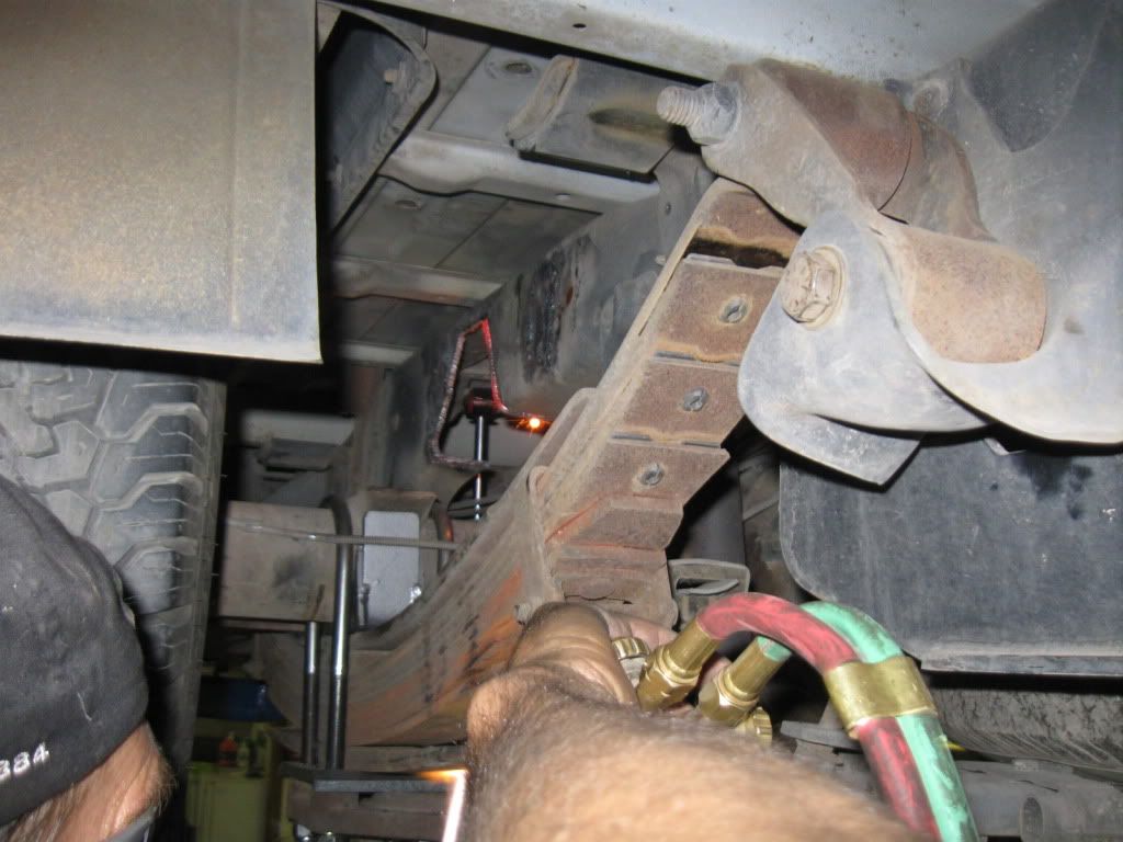

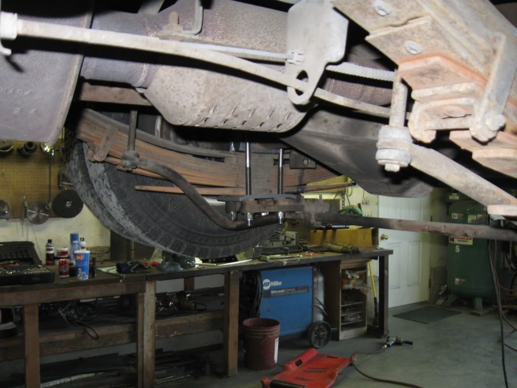

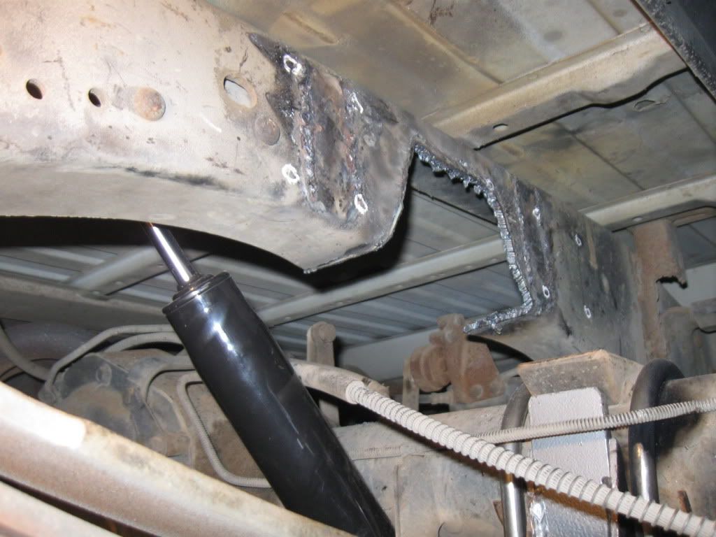

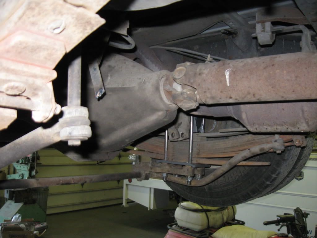

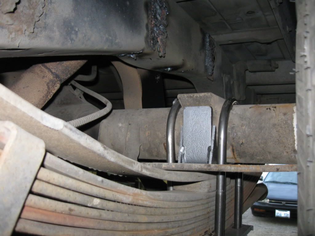

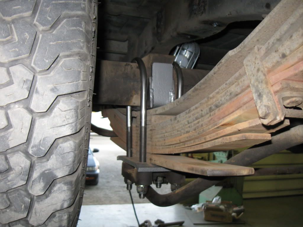

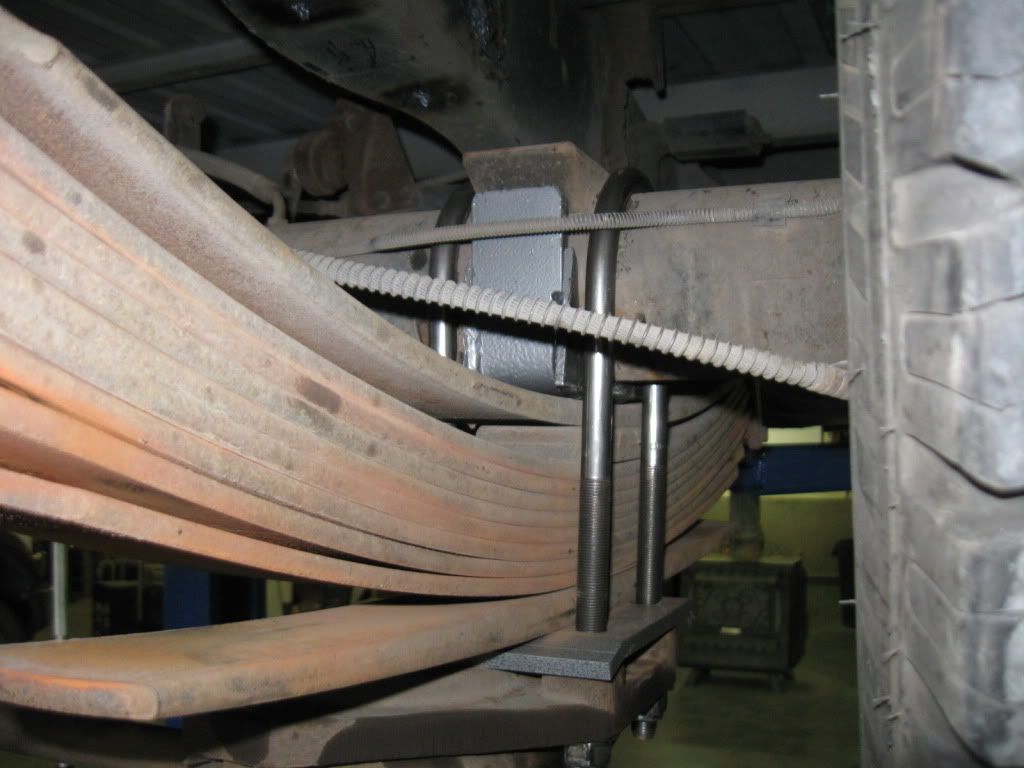

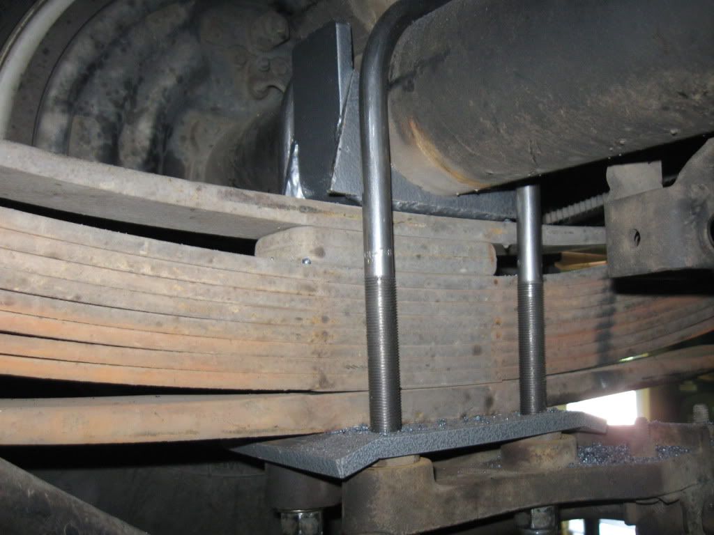

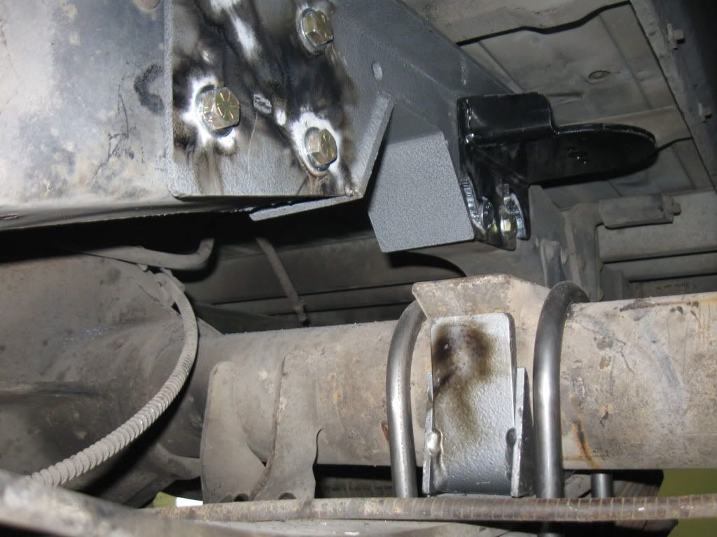

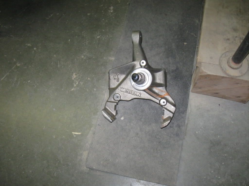

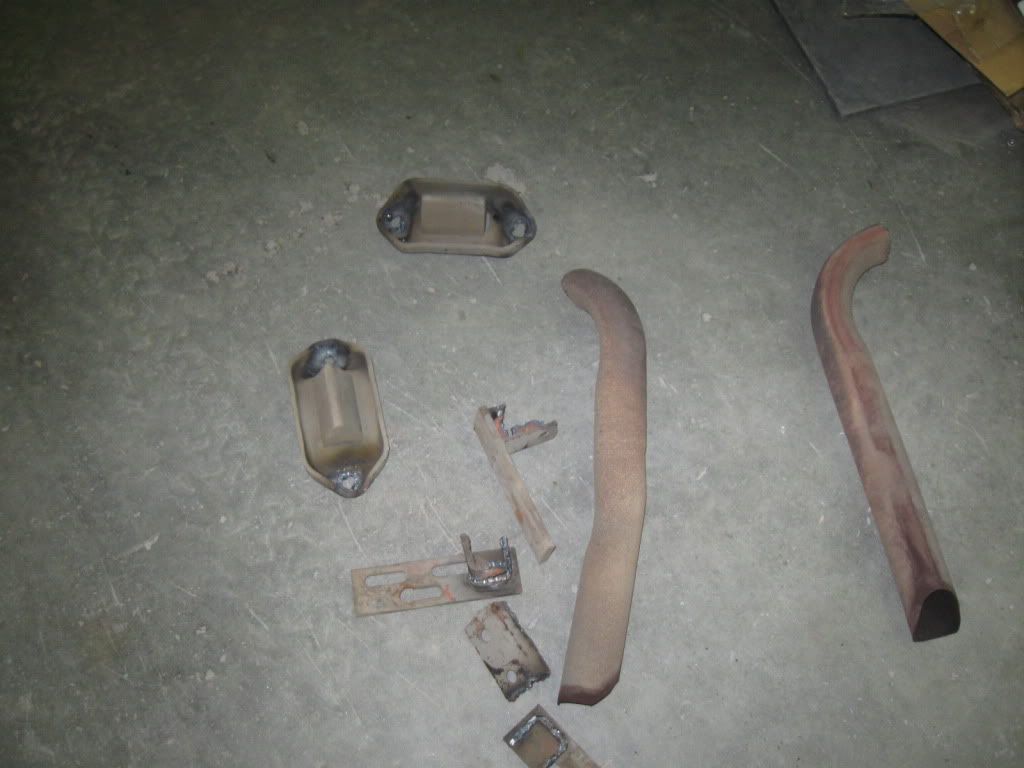

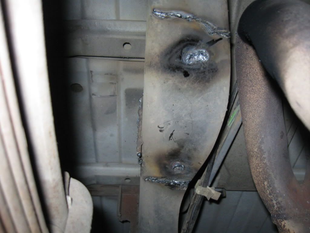

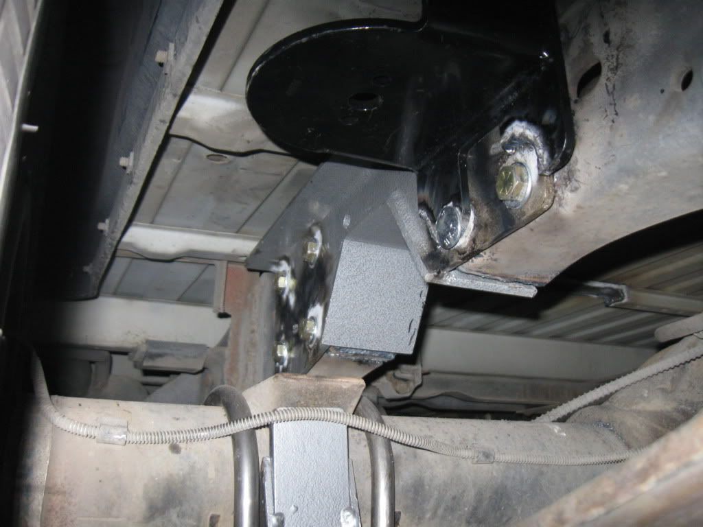

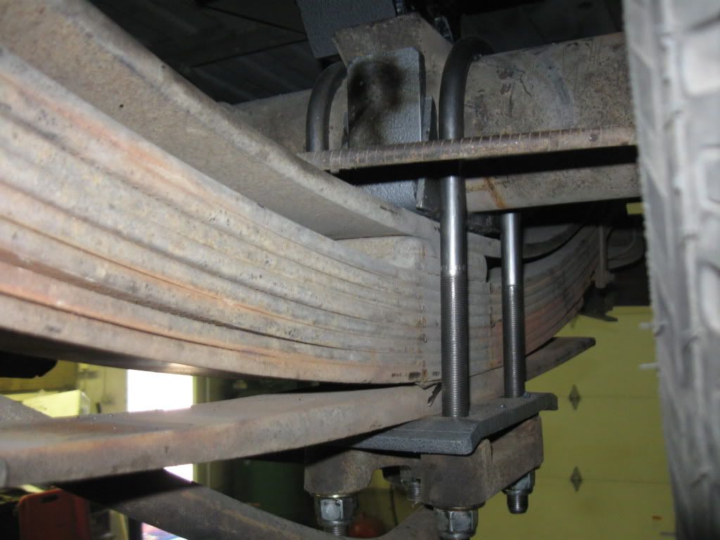

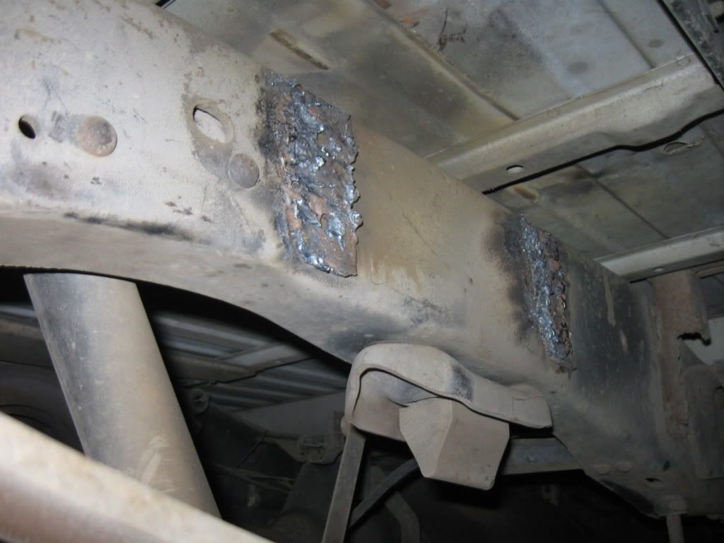

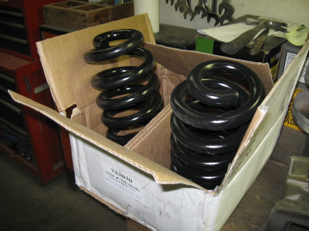

The Cure a 6/8.5 Drop from Western Chassis:
spindles
Coils

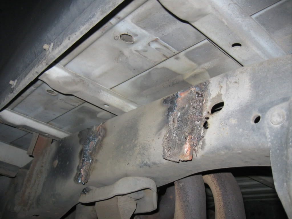

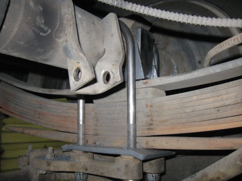

Flip Kit

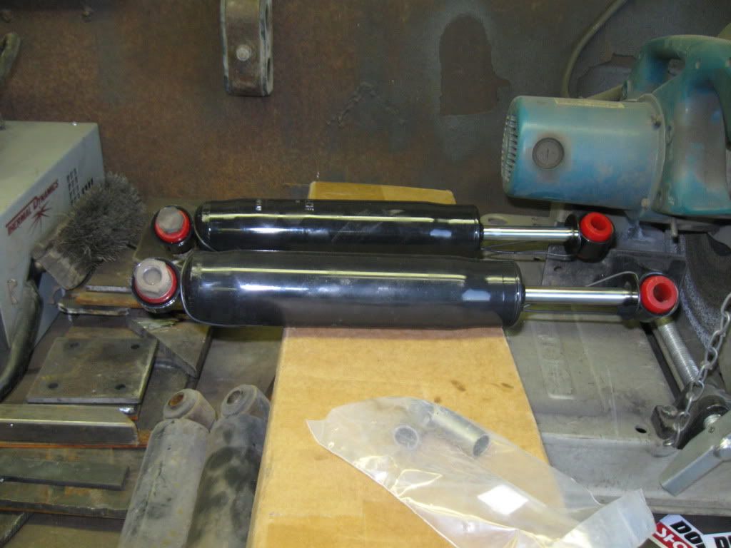

And Drop Shocks

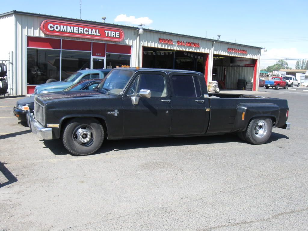

Getting aligned

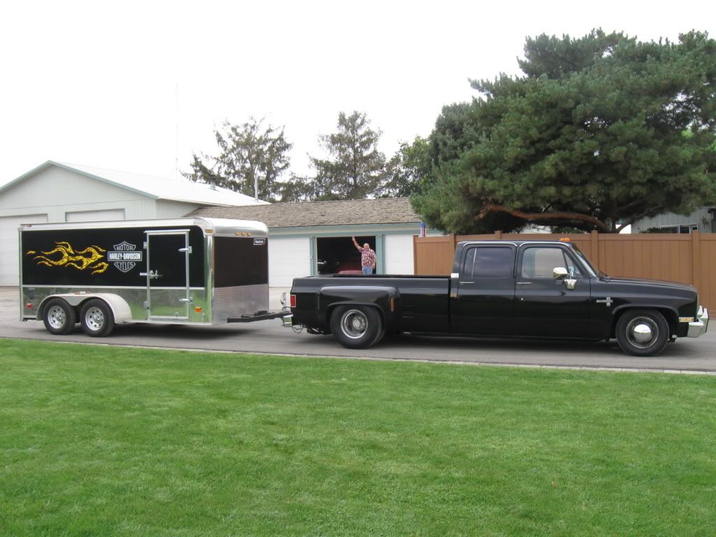

Towing the Drag Bike

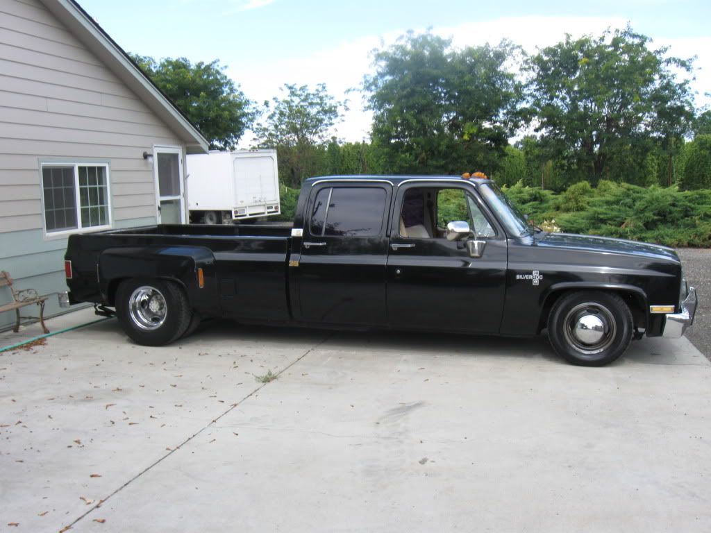

As she sits now

Very clean looking truck, I like it.

Thanks...I just upgraded the engine to a 98 Vortec 454...mmm roller cam and better heads. Next up airbags for the front (maybe)

Your "Tow Pig" is awesome, but I'm kinda partial to black crew cab duallies.

That's pretty cool seeing a dropped 3+3 man! Sharp truck.

i like your truck alot, i was wondering where you go that steering wheel at? i realy like those but cant find one any where, unless ive been looking in wrong spots. thanks for any info  keep us poste dwith lots more pics if anything else is done 8)

Looks Great :)  I love the stance :)

did you have to take out any of you leaf springs in the rear?  any under hood pic?

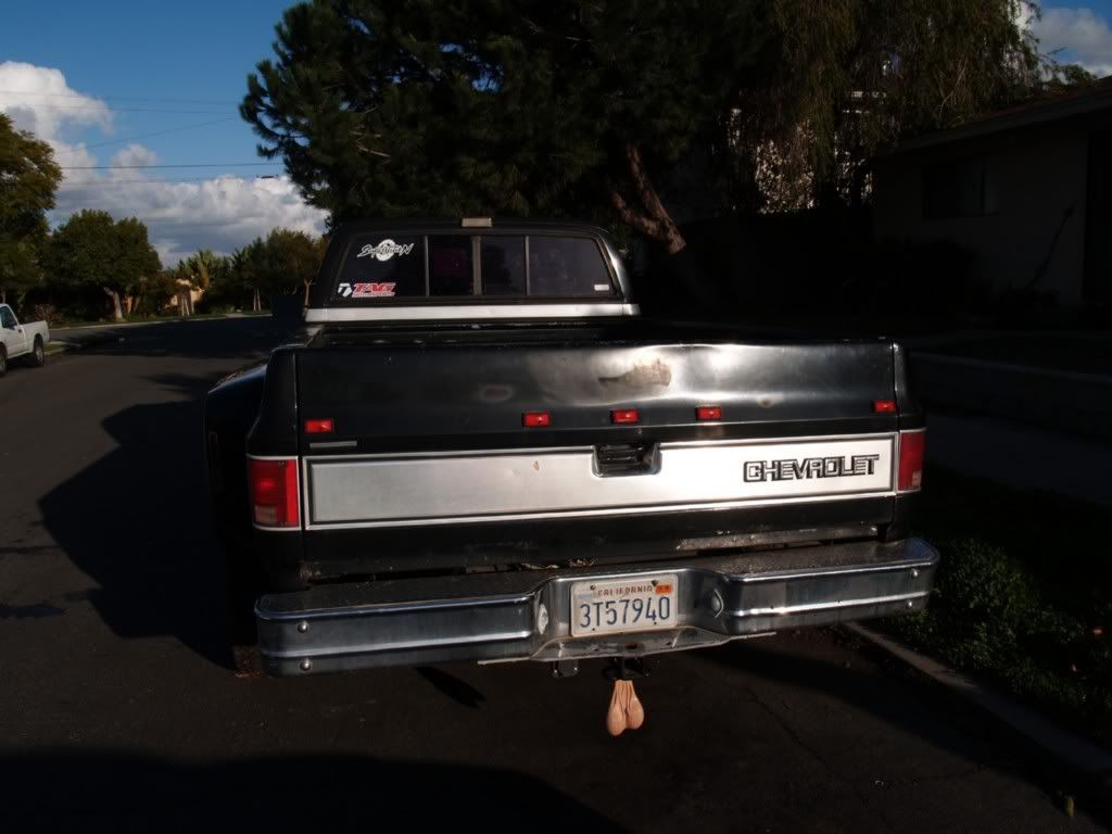

Trucks got balls. Literally.

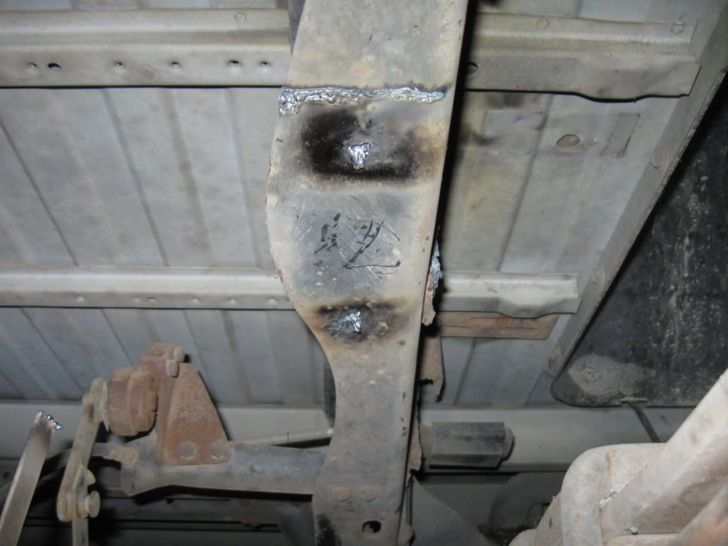

Does yours bottom out a lot?  My dually has a flipkit in the back and a c-notch with drop shocks and it bottoms out all the time over anything.  It has some little skinny airbags, but they dry-rotted and only hold air for a few hours.  Even when the bags are full we seem to bottom out on some dips in the road.  I was just wondering if that's just something us lowered guys have to live with.

Do you have a c-notch like him under the bed? You'd be suprised how that extra space will help. Atleast cut off you're bump stops and the brackets.

I haven't looked at mine in a while, but I think my c-notch is smaller than his.  I'm thinking about putting leafspring clamps on mine until I can afford new airbags.
