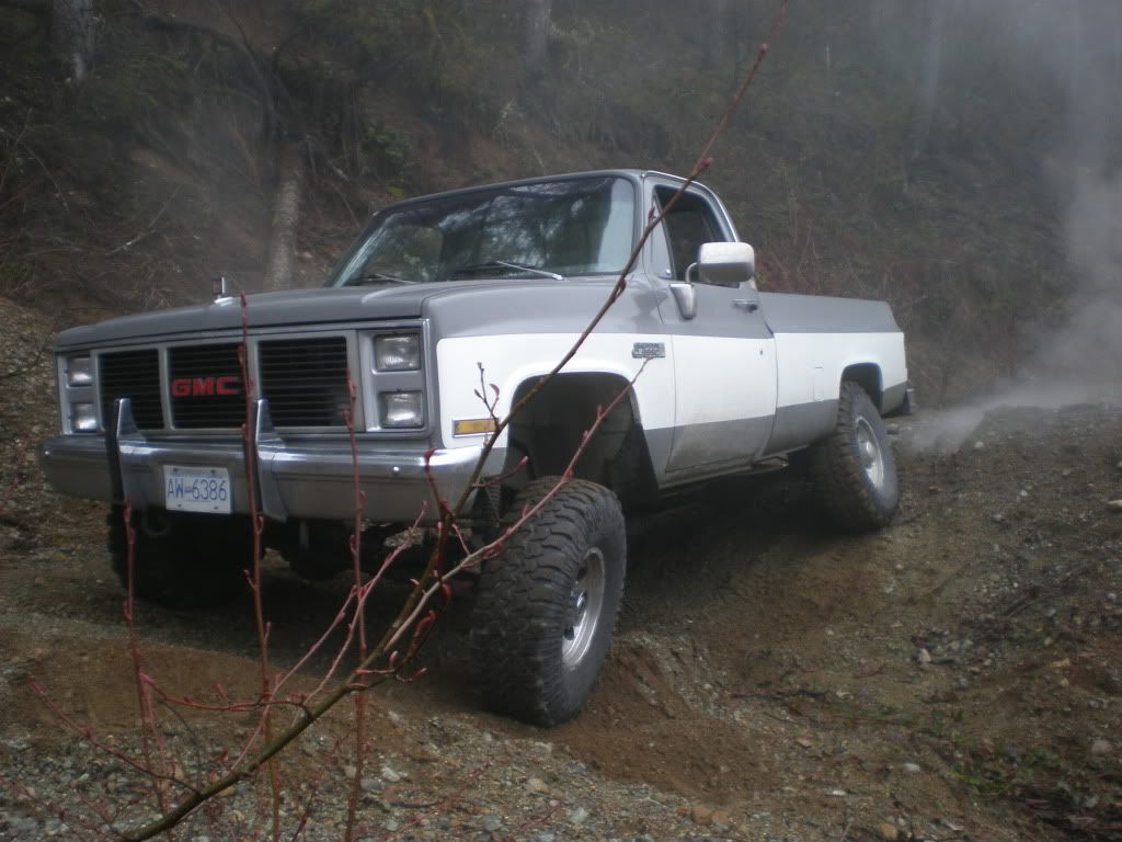

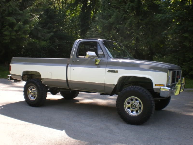

Here are some pics of a 4" lift with 35s and fenders trimmed nicely. The mud flaps aren't hiding anything, they just keep rocks from hitting the body. As for the driveshaft, I assume the 14bolt FF isn't factory. The pinion on the full floater is farther back than on the semi-floater and I don't think you would get away with a stock drive shaft on a 6" lift. I barely do with a 4".
Last Edit: December 26, 2010, 08:38:18 pm by captain carnage
