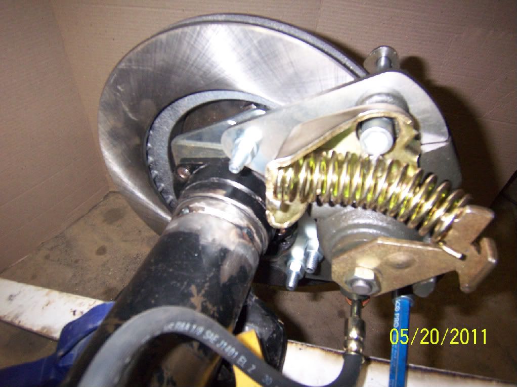

Torch, That kit looks like it's made by Right Stuff...I'm working on a 9" rear for an old Mustang & used a kit from them. Not quite done yet, but it looks to be a fairly nice set-up. Those should work with 15" wheels...the parts (calipers & likely the rotors for our trucks, since they were 5 on 5") are from an '80's Seville (the RWD version) they had 15" wheels. Lorne
