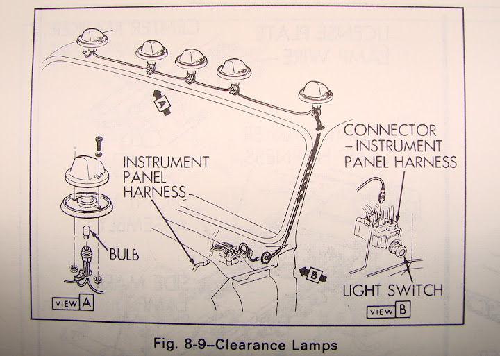

Okay, I pulled my 1979 GMC shop manual (close as I could get) and it shows the clearance lights as having a ground clip to the body under the light.
Later model trucks had a dedicated ground that ran back down the pillar, which if it was not grounding would make all the lights go out..
Presuming 1979 and 1980 were the same setup, the power wire is shown to route through the A-pillar and plug directly into the headlamp switch. The best that I could find is that the clearance lamp power wire is brown with a spade terminal to go into the top of the headlamp switch. I don't see anything showing a fuse inline or otherwise for the clearance lamps.
If your park and tail lamps are working, then check the connection at the headlamp switch. It may be the lead from the switch or the switch itself.
