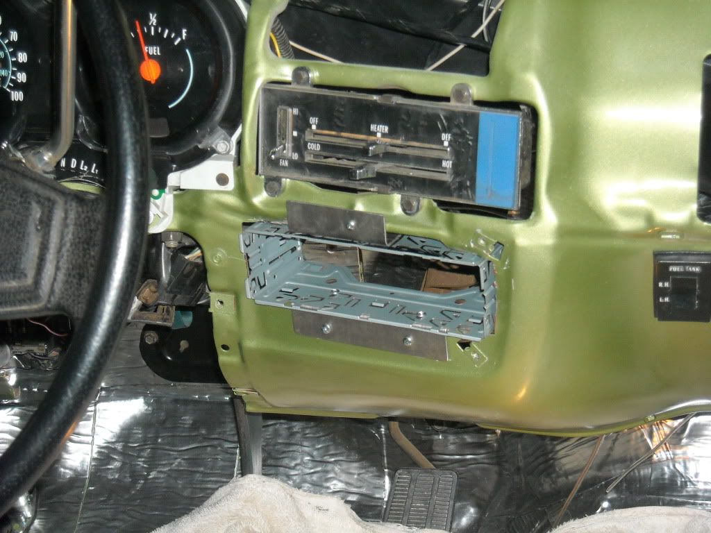

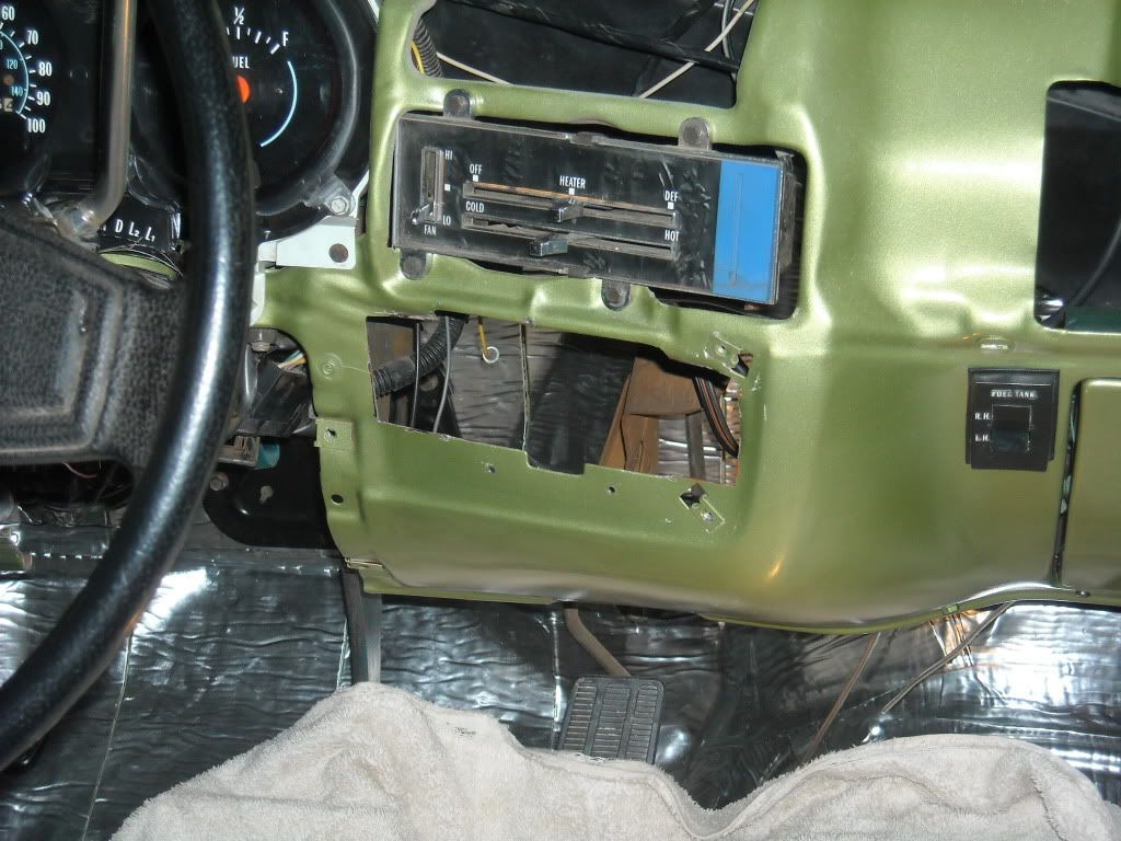

I cut the dash first to see how I could mount the DIN cage rigidly to the metal.
You can kind of see the 3 mounting holes I drilled and tapped in the metal dash.

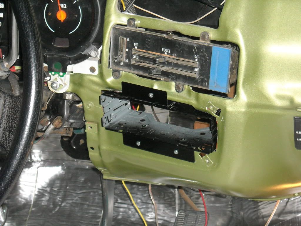

I mounted 2 metal angle plates rigidly to the DIN cage, spaced back from the front so when the cage was mounted, it was sticking out a bit to match the instrument panel face.
I painted the cage and brackets before I final mounted them so it was all black

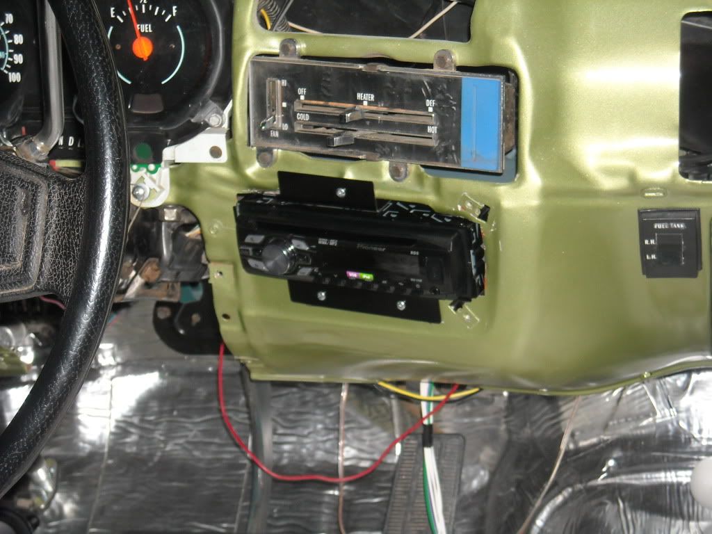

This is what the radio looks like installed in the cage. I know, pretty boring.   :)

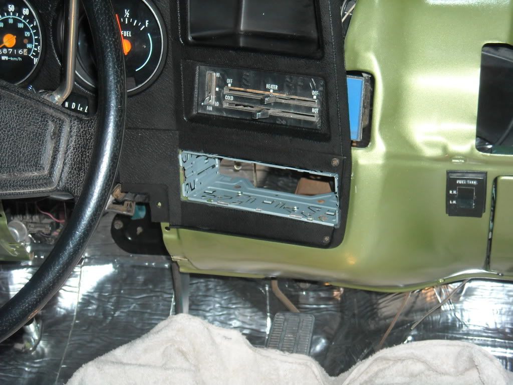

Here is what the instrument panel looks like installed without the radio. From here, I just pull the electrical connector out, plug it into the radio, slide the radio in to lock it in place and snap the trim plate on. Done deal
