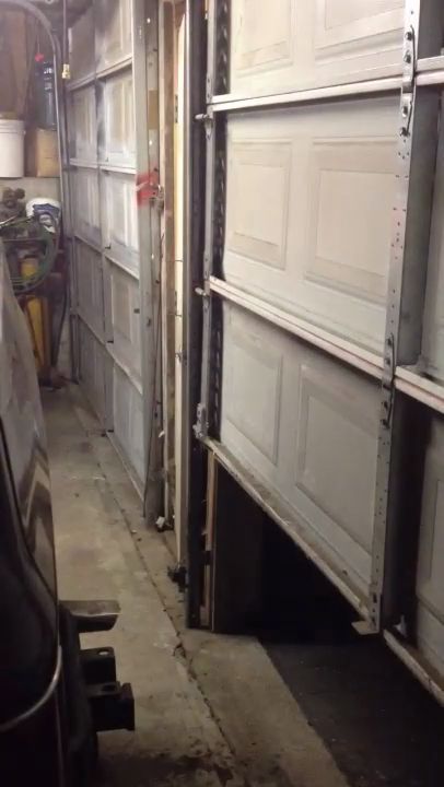

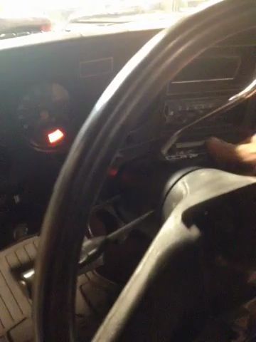

After twisting a few wires together over the past few days I got the fusebox all wired up and hit the key and it fired right up the first time. I had it running for a while to get warmed up and make sure the fans work and everything was fine. Only had one small leak at a line on the hydra boost. I guess I should replace the 30 year old o ring. I still have to run wires for the dlc, cel, speedo, and lights for the 4x4 buttons. And then I can clean up all the wiring and make it look halfway decent.  I'm happy it runs but it's not halfway done. Still have a lot of work to do.
