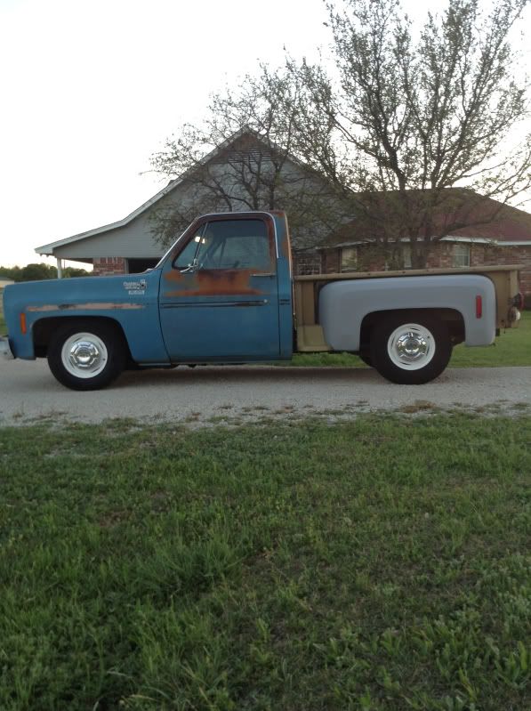

It depends on the wheels as to whether you'll need to trim the arms with a 3 inch spindle. I run stock wheels (hubcap style skinny wheels) with 3 inch DJM spindles and they clear by a mile. Rally wheels will need trimming though.

Yep. The stock skinny steel hubcap wheels. Don't judge the truck too harsh. It's a 100 percent new underneath with the best parts I could buy. I'm a geek for top quality suspension, brakes, and drivetrain parts and am completely allergic to Chinese cheap parts. I just haven't spent a minute or a dollar on appearance yet.
Re: lowering options
May 11, 2013, 07:51:17 pm »
you always need a good base to start on

Some nice looking wheels
. Im starting to be allergic to chinese parts to lol
