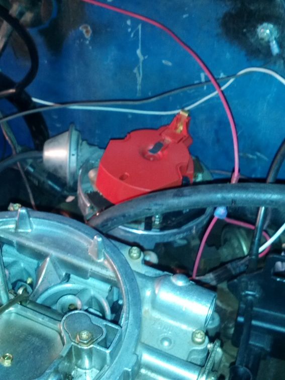

Hello. I have a 86 c10 350 Goodwrench crate motor I am adding MSD 5520 ignition box, cap, rotor and HEI coil. What I am trying to find out today... I have my engine between 10 and 12 deg before TDC.
My rotor is pointing like this
even if it is 180 off it will not be pointing at where the #1 plug was before I replaced the cap. Please tell me what I have over looked or have wrong. Thanks

Roll the motor over 1 time and put it on zero. If u didn't pull the distributer then your good. You're 170* off I think

Being that you didn't take the distributor out, the engine is still in time. The rotor isn't pointing where it should because you are at TDC...just not on the right stroke. You can set it to have #1 be wherever your heart desires. I was taught to put #1 on the driver side of the front two closest to the carb. If your cap has no locating tabs then the side of the cap with the power and tach plug in will go on the driver side, opposite the vacuum advance side. Hope that covers it for ya

The small block Chevy firing order is 1-8-4-3-6-5-7-2.  The crankshaft makes two complete revolutions for each cylinder to complete its intake-compression-power-exhaust cycle - the piston makes two complete down-up strokes per cycle.  As the crankshaft rotates, piston top-dead-center (TDC) occurs between the compression and power strokes, and between the exhaust and intake strokes.  Piston bottom-dead-center (BDC) occurs between the intake and compression strokes, and between the power and exhaust strokes.  The piston stops and reverses its direction of travel at TDC and BDC.  Ignition occurs directly between the compression and power strokes...
...intake stroke-(BDC)-compression stroke-(TDC)-ignition/power stroke-(BDC)-exhaust stroke-(TDC)-back to intake stroke, repeating cyclically...
Reiterating, a piston comes to TDC twice (two crankshaft revolutions) for each complete cycle.
Engine cylinders fire as opposing pairs or "running mates," as follows:
1 - 8 - 4 - 3
6 - 5 - 7 - 2
So, cylinders 1 and 6 are defined as running mates.  When cylinder #1 is at TDC compression/power, cylinder #6 is at TDC exhaust/intake, and vice versa.  In your posted images, cylinder #6 is near TDC compression, just beginning its ignition/power stroke; whereas, cylinder #1 is near TDC exhaust, just beginning its intake stroke.  Similarly, cylinders 8 and 5 are running mates, as are 4 and 7, as are 3 and 2.
