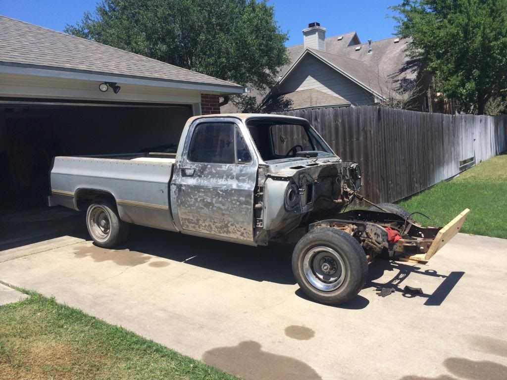

Well a bit of news, a buddy I work with has an 86 k10 lwb that he's willing to sell me, the body is pretty well trashed but the transmission has been rebuilt, the engine runs and the frame should be in good shape, I'll hopefully pick it up tomorrow right after work. I'll put up some pics as soon as I can.

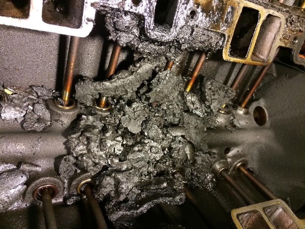

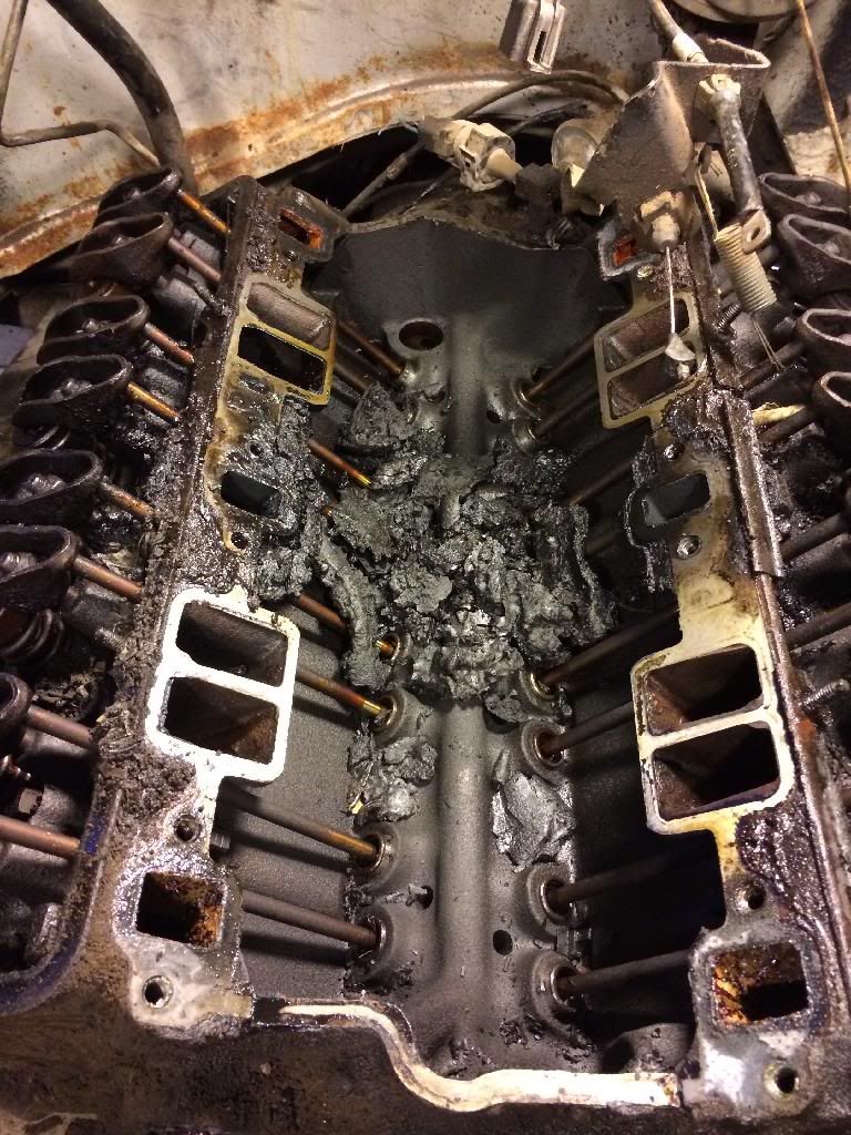

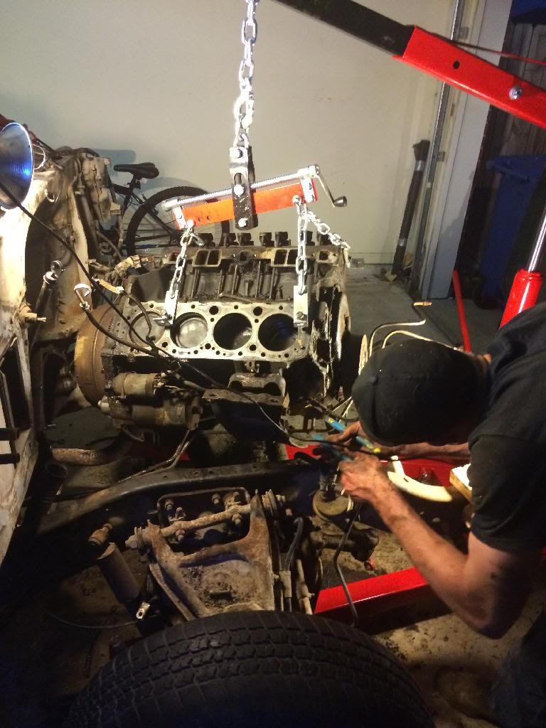

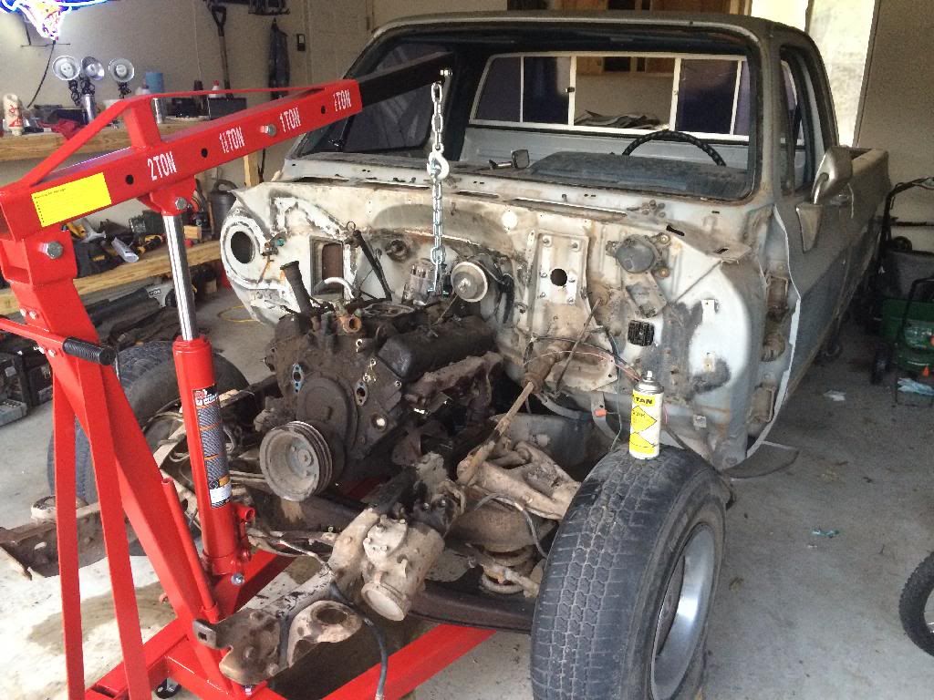

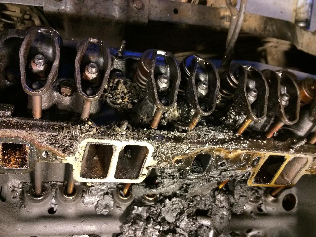

So it's time for an update, a few things have changed and I'm going to stick with a 2wd build for now. I ordered a 383 stroker crate engine from tristar engines the other day and so we went ahead and pulled the old 305.  Found quite a bit of carbon build up thanks mostly to what I'm guessing is some fried piston rings on the passenger side. I was impressed at how easily everything came off tho, 29 years or build-up has an odd preserving effect lol

to me it looks like your egr ports were leaking cooking and the oil

Oh ok, yeah it was leaking in quite a few places and all the coolant lines were very corroded and packed with junk. Thanks for the input, this is one of those learn-as-you-go projects for me and I'm eager to learn all I can.

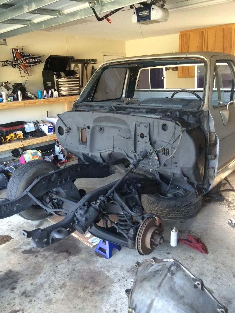

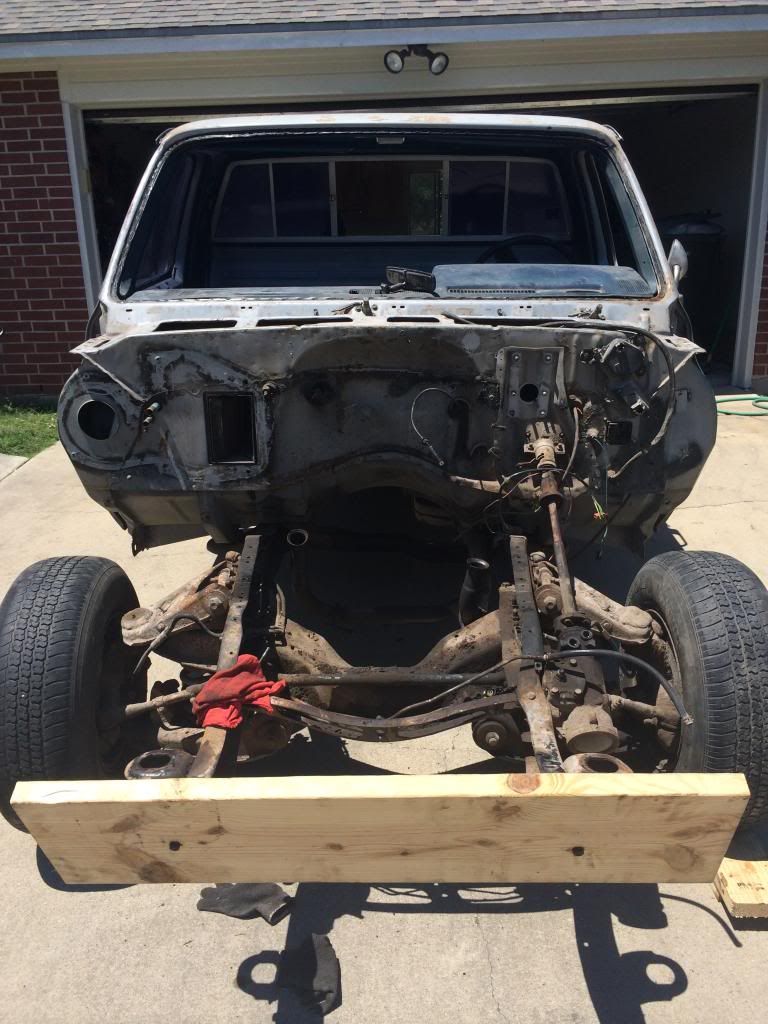

We got the transmission, bed, and fuel tank pulled too so I think we're at the point where we can clean and start ordering all the fun stuff and maybe start putting her back together! Can't decide if I want to redress the suspension first or do wiring and the fuel system first, any thoughts?

are you redoing the suspension or you just want to freshen it up? if it was me i would worry about if the engine will stay running first (if your driving it) cause you dont want her to stall out in a intersection or at all

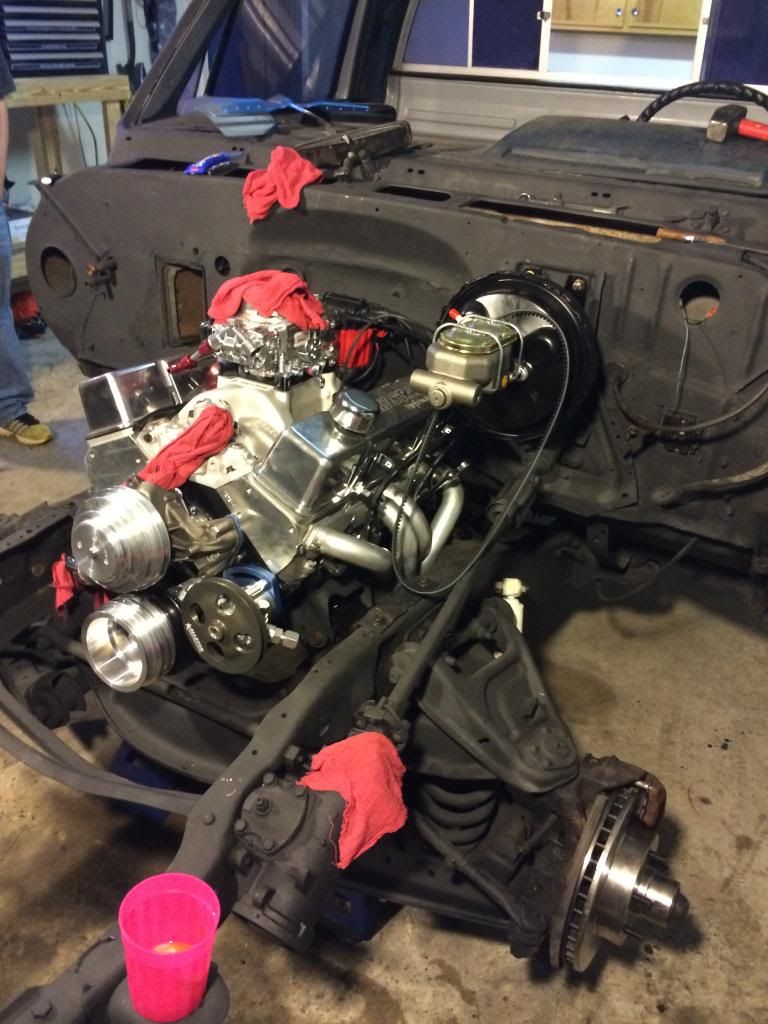

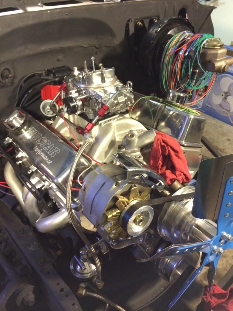

Well here's a quick update, the engine came in the other day and she looks great!! Tristar performance really did a fantastic job on this engine and always being available to answer any questions I had. All we're waiting on now is the delivery trucks from summit and amazon for all my shiny parts to come in. I hope these pictures show up right.

Update time, but first I can't begin to express how helpful this site has been in helping me get this truck back together. The technical pages have so much good info on everything! I haven't found a better information source out there than what's on this site, so thanks a lot guys!
Well we got the engine stuffed back in a week ago and had no problems whatsoever with the fitment, got a set of new motor mounts from oreillys and before you knew it she was in!
Next came adding on the accessories which went well, had to modify the spacers on the alternator bracket to get it all lined up but nothing the ole grinder couldn't handle. The tricky part was finding the right belts to connect it all together with, I swear I went through at least ten belts before  I found the right fit!

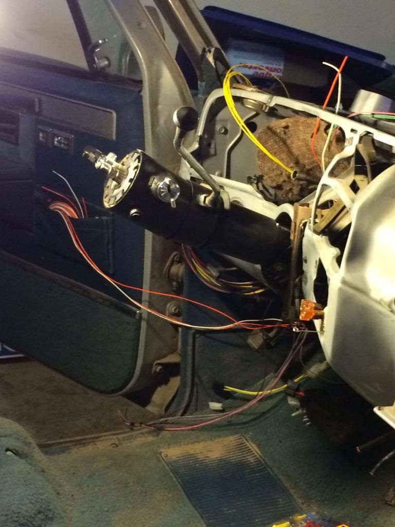

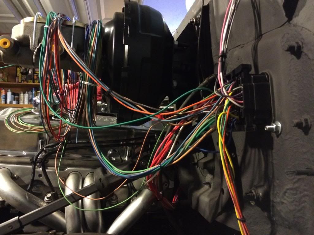

Next we hooked up the throttle linkage and started on the painless wiring harness, as intimidating as it was at the start it actually proved to be a lot easier than I thought it would be, more tedious and methodical than difficult or confusing. Me and my brother stayed up all night long making sure everything was right and tucked up nicely. Only things left to wire up are the front and rear sections that I haven't put back on yet and the power windows and locks, I accidentally cut the wires out for all of them thinking the new harness had the replacements but was wrong, just 2 of the 6(?) total were provided so I'll need to finish them out later.
That was all I could accomplish on this week I had off, in three weeks I'll have another week to spend and I'll install a layer of second skin on the interior and convert everything to black to go with the dark navy blue paint we'll be going with on the outside. I'll also have all the other little accessory pieces I need, tranny cooler, brake lines, power steering lines, radiator mounts and hoses, and hopefully have the seat reupholstered. I'm so close now I can feel it! I'm really hoping she'll be moving under her own power by the end of the month.
