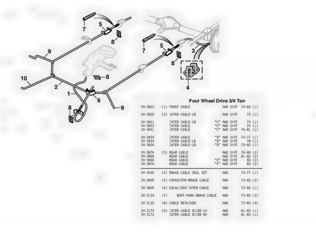

H, I am replacing the whole parking brake cable system on my 78 K20, it has the big drums in the rear.  My brother ripped out the cables some years ago.
Gonna order a front cable, an intermediate cable, and two rear cables.  Does that sound right?
Wasn't sure if I need two intermediate cables.

     Do you still have the clips that goes into the intermediate and rear brackets that hold the cable ?  On my 77 when I stripped it down to do the frame it was like that, there were these little spring type clips that held pressure on the cable in the bracket.  I am getting ready in the next week or two to finally start re-assembling mine.

Do you know if I will need 2 intermediate cables?

     OK, it took me a little to get this to work, I like pics so I can see what I am suppose to be looking at.
     So this gives you a break down on the whole system with years and quantities.  Let us know if any further assistance is required.
